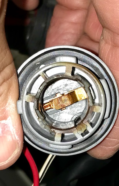

Double speed indicates a bulb out. The flasher uses a bimetallic strip and if there isn't enough load on it, it flashes too quickly.
Start by pulling the bulbs and testing them with a meter. If they're conventional bulbs and they function fine, check the socket. There could be corrosion causing an issue. If they're LED bulbs, they may be polarized and could have been put in wrong.
Make sure the bulbs are seated fully. Sometimes the wires on them get pushed out of place.

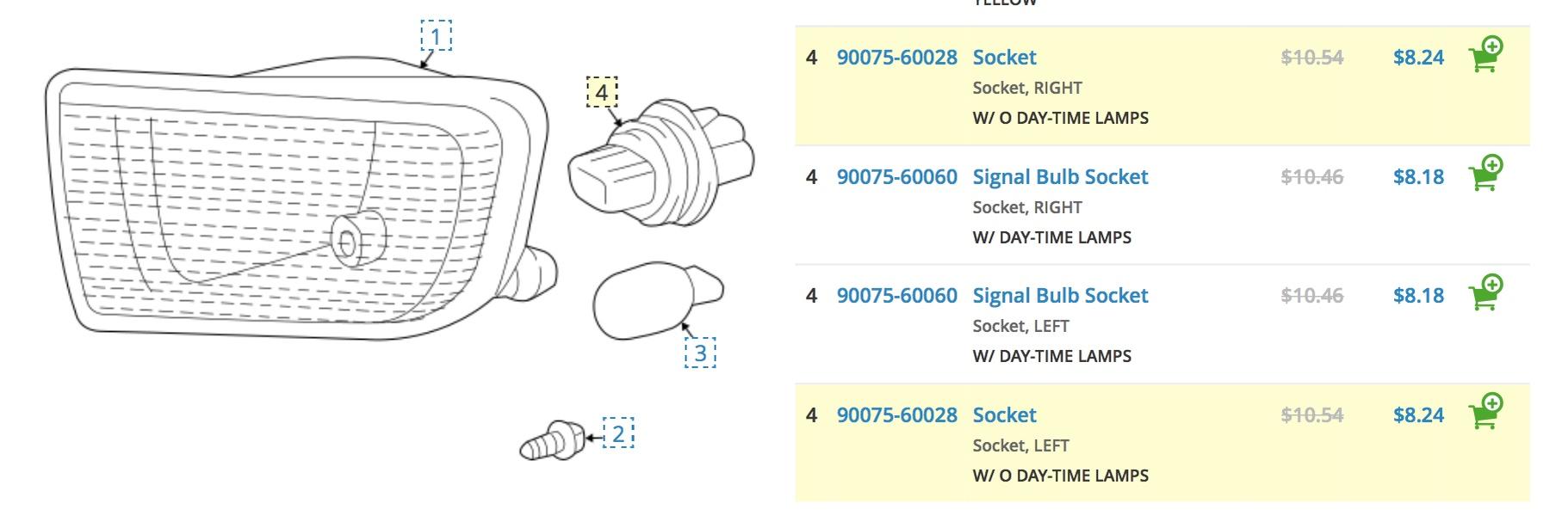

Had the same problem, although only on the passenger side blinker. Ended up having to replace the bulb socket. Heres the part numbers.

It was the sockets, thanks!

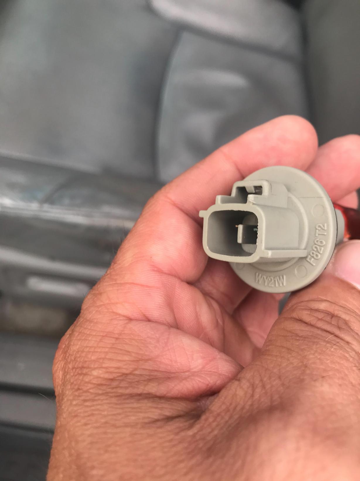

I have a 2008 with a bad front turn signal socket , socket uses bulb 1156A.
Can someone give me part number for this socket??

My 07 is always a problems, today it was raining and working just fine?????
Can we replace just the socket?? or the entire harness?? part number??

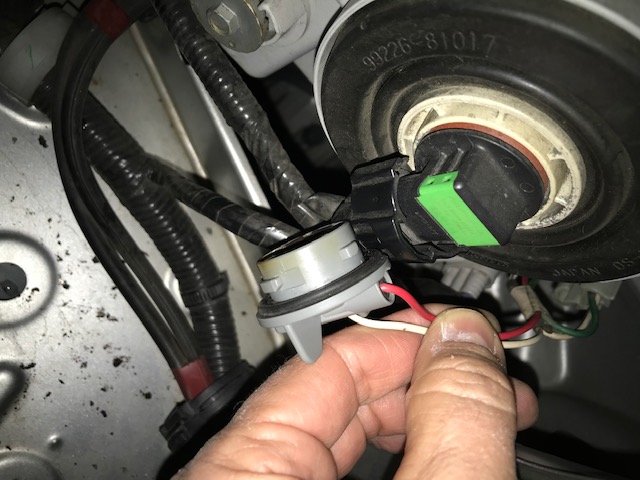

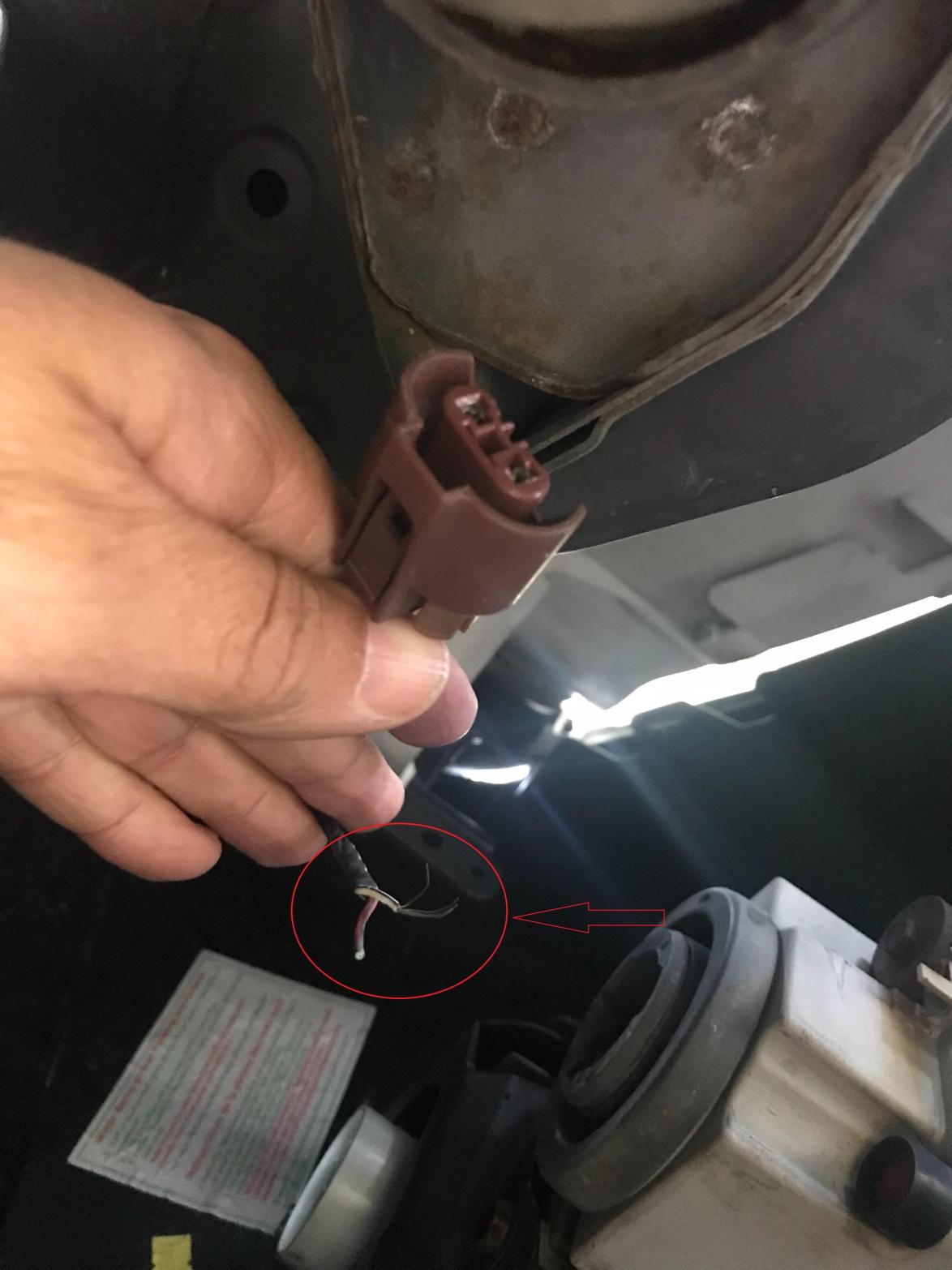

My turn signals are missing the connector between the wiring harness and the socket. If anyone can tell me what I need or point me in the right direction that would help a ton.
What year model do you have?
How was the blinker connected before?
It's an 03 Limited with the 4.7 V8.
I bought it with both the blinkers not working. I got one working but this one has no connector.
The other one just had a bad socket so I replaced it and that was easy, but this one just has the open leads with no connector.
Any advice?

You can go to a Toyota dealer and see if they can order the connector, I can't find the connector on any online dealer's websites, or you can try and find the connector at a local savage yard, only the 2003, 2004, 2005 will have what you need, also it maybe be a different connector if you have daytime running lights or don't have them, I know the sockets and housings are different with or without daytime running lights, but since I could not find the connector/part number/s I don't know if they're different or not.
You can go to a Toyota dealer and see if they can order the connector, I can't find the connector on any online dealer's websites, or you can try and find the connector at a local savage yard, only the 2003, 2004, 2005 will have what you need, also it maybe be a different connector if you have daytime running lights or don't have them, I know the sockets and bulbs or different with are without daytime running lights, but since I could not find the connector/part number/s I don't know if they're different or not.
Thanks for the help. At least now I know what I need to do. I think I'm just gonna hit up a salvage yard, get the connector with the leads attached (another 5-6 inches), splice them together and use some heat shrink to make a water-tight connection.
