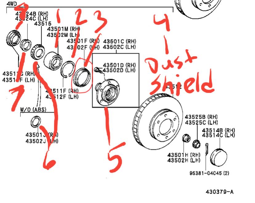

I finished my knuckle rebuilds this last weekend. Not bad at all. It will either be a tone ring (abs equipped) or a spacer behind the spindle 4 pin nut never both. Make sure you remove the inner races from the spindles if the bearing broke when you pressed it apart.
***Weld the gusset with a bare knuckle (no bearing or ball joint) before pressing in new bearing and ball joint!***
Install bearing in this order:
1. Lube bearing pocket and bearing outer race and press the bearing in with the metal seal facing outwards. Only press on the outer race of new bearing (take a old bearing apart and use the outer race).
2. Install new snap ring
3. Install outer knuckle dust seal
4. Install dust shield
5. Lube and press in spindle onto bearing, making sure to support the inner race.
6. Install spacer OR tone ring in correct orientation.
7. Install and torque the spindle 4 pin nut to 205 ftlbs. For manual hub swap only. Otherwise press on spacer.
8. Install inner knuckle seal
9. Sit back and have a cold one.

To be clear, step 7 is only necessary if you are doing a manual hub swap. There is not a spindle nut on the factory hub, it would be a spacer (43524-35010).
Interesting, as the 2wd 3rd gen knuckles I pulled from the junkyard had the 4 pin nut. I'll add a edit.
I guess I'm only talking about 4wd. I would lean on your description for 2wd vehicles, as I have no experience with them. :D
I’m gonna go out in a limb here and say the 4pin nut that was on the 2wd spindles is to keep it all together.
On the 4wd, the CV holds the bearing together. The 2wd doesn’t have a CV, so it would use the nut, just like the manual hubs would use.
At least, that’s what I would assume.

That's what I'm thinking too, but with the spacer on the 4wd one seems a bit odd to me as all the wheel bearings I have done that use the cv to pre-load the bearing the cv presses against the inner race of the bearing, and the hub is a wee bit short to allow cv to press against the race.

What the 4wd non-manual hubs look like can be seen in the Part 2 video I posted earlier. The spacer on the A.D.D. hubs takes the place of the nut on the manual hubs. For 4wd A.D.D. rigs, the outer CV joint presses on the spacer, which presses on the ABS tone ring or other spacer, which presses on the bearing.

That would have to be correct. Without a CV axle nut to preload the bearing, the 2wd rigs need a nut, like the manual hub 4wd rigs use to preload the bearing.
