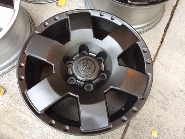

FJ Rims

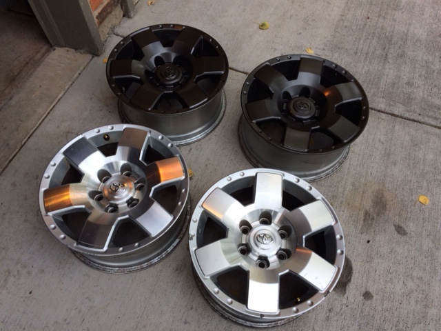

Decided to try painting the FJ rims instead of powder coating first. I found a nice looking graphite color paint. So far it seems pretty durable and I really like it.
I still have about 15,000 miles left on my 16" tires before I swap over to 17" ones.
I think I'll paint the Toyota logo in the center black

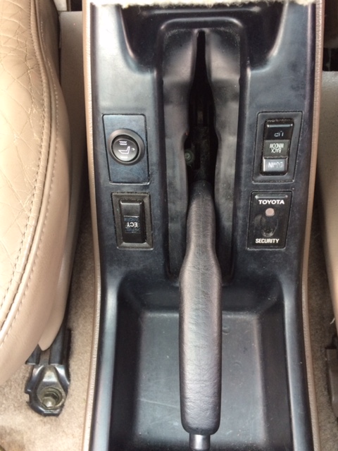

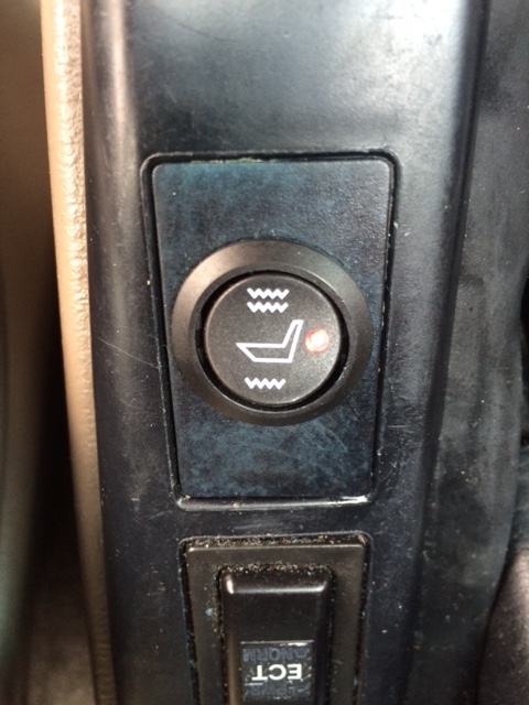

I deleted the other threads about this and consolidated it into this thread. But here is my heated driver's seat mod.

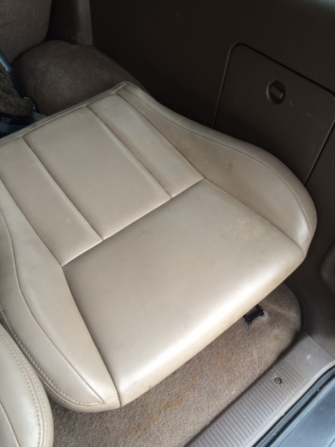

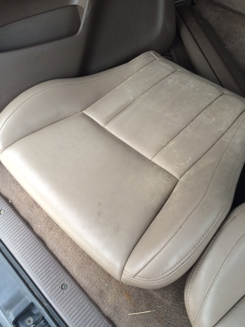

the holy grail
Found the holy grail of junk yard finds today: two recently re-upholstered front seat bottoms WITH new seat foam. The dust wiped right off with water and they look brand new.
...but, the best part is, the junk yard man only charged me $11 a piece. :thanks:

How are you getting such good deals?
Those wheels are wicked and cheap! Plus the leather seats? Dang!
Your rig will be a limited hauler before you know it.

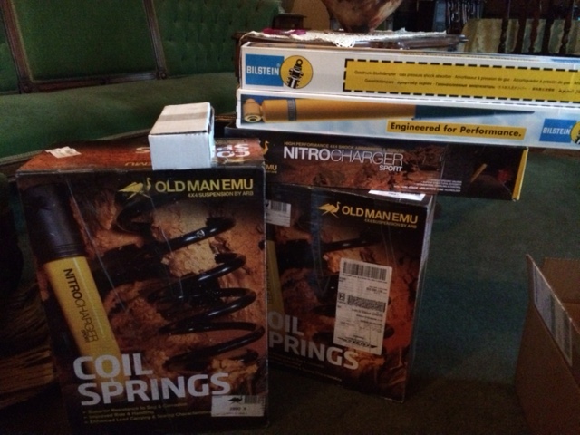

FINALLY! After a year and a half of owning the 4Runner, I've caught up on all the necessary maintenance and have saved up to splurge on a lift kit
OME 881 front coils
OME90004 front shocks
OME 890 rear coils
Bills 5100s for the rears
Diff drop
I'll have a busy weekend :)

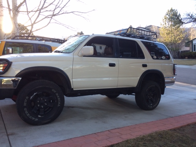

Installed the lift kit today! The measurements from the center of the hub to the fender was 20 inches all around before the lift. Now, the front is at 22.5" and the rear is at 23".

New lift installed, new shoes (hankook 265/75-16), and no more saggy 4Runner butt!

What did you use for your lift?
OME 881 front coils
OME 90004 front shocks
OME 890 rear coils
Bilstein 5100 rear shocks
I definitely takes at least 500 miles to break everything in. It was pretty bumpy at first and felt like it was all over the road even after an alignment, but after 5-600 miles, I really like the way it handles

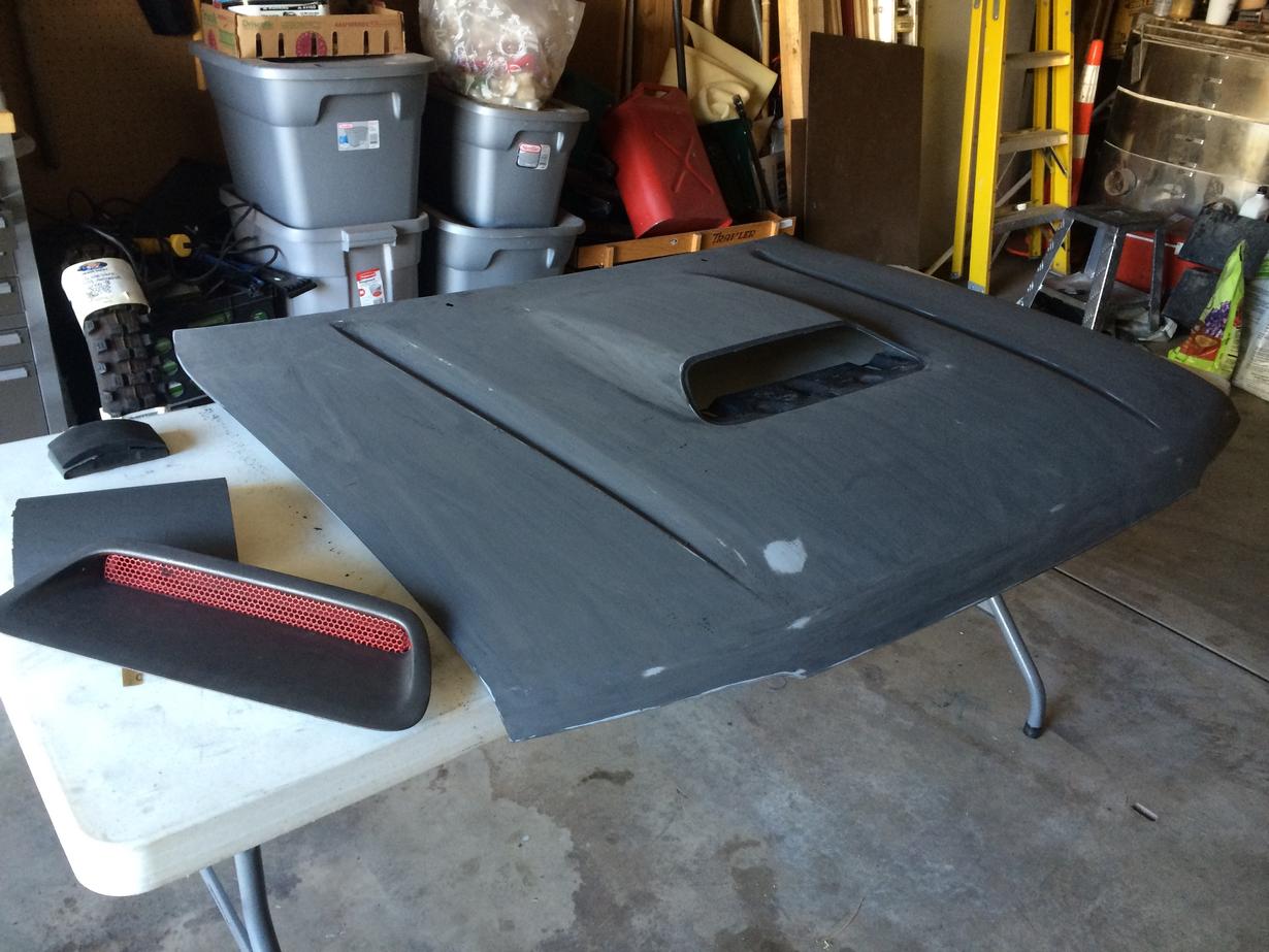

Scooped
Time for a hood scoop. I do paint and body work on trains for work, but I've never done anything for a car. Trains are a little less precise when it comes to body work but I imagine the principles are basically the same. Guess we'll see how it goes.
How would you go about installing new seat bottoms? My '96 has a pretty sizeable rip on the drivers side and ive been wanting to replace it for a while
