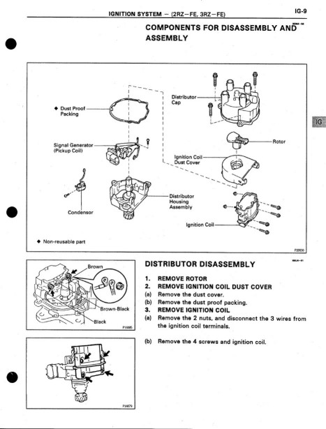

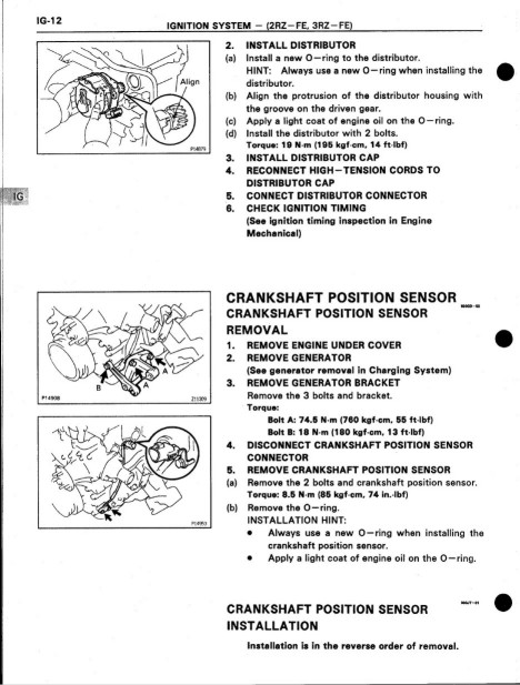

Wondering if anyone has a FSM for 96 which has the 3RZ with distributor. Newer FSMs likely don't have the section I need.
Looking for Distributor rebuild section, I'm putting in a new distro base and switching my original coil etc. over to it. I would like to know if there is anything tricky I should pay attention to or is it self explanatory.
Anyone able to post a pic of the page? Thanks.

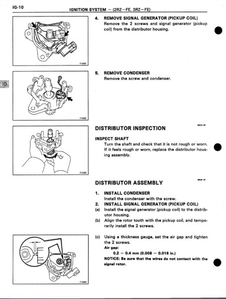

There's an air gap spec for the distance between the coil and the reluctor(?). Suppose to be fixed but I would verify.
Internal coil - 0.008 to 0.016
Distributor shaft oil leak? How did I guess...

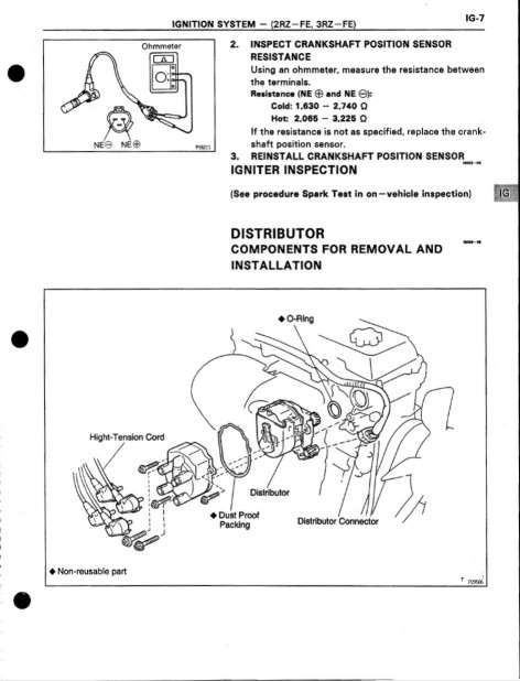

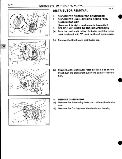

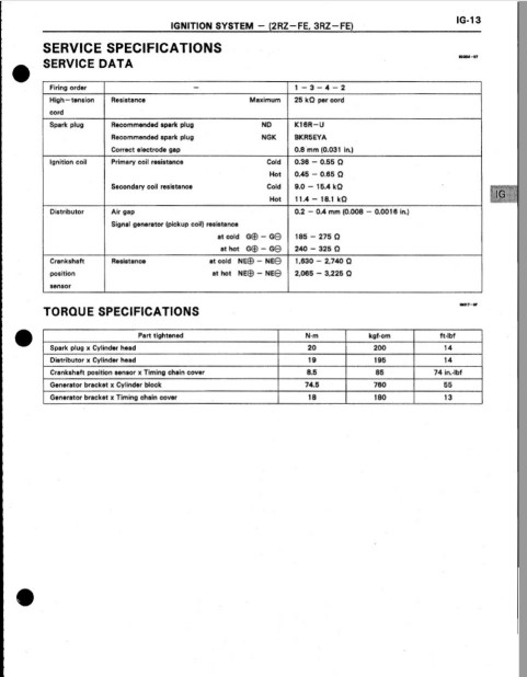

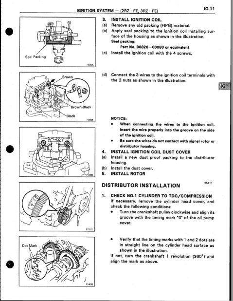

from the 96 Tacoma manual. I can expand parts of pictures if needed. Total size has to be less
than ~130k

Perfect! That should do it. You folks are the best.
Yes, leaking through the internal shaft seal. Still a slow leak but I'm going to fix it.
Got it in yesterday. Thanks for the documents.
