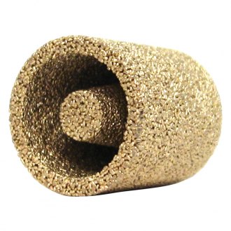

So I have to ask. Do they still use these anymore?
