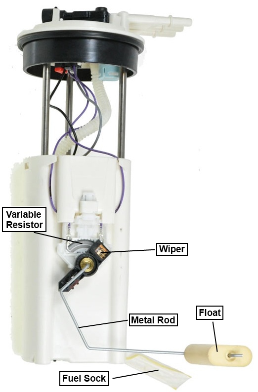

I've had good luck with cleaning the variable resistor contacts on Audi sending units in a few different cars to get them working again if they were being screwy as the level changed from burning fuel. Sounds like yours is completely unhooked or crapped out though? Curious what it looks like when you get it out.
I believe the above is a GM truck fuel pump/sender assembly, but the Toyota ones are similar in design/function. Sometimes they just get gunk on them, other times the wiper and/or variable resistance strips get worn out. You can actually buy the senders separate, but in my honest opnion; if I'm going to be going through the trouble of pulling the fuel pump out on my 100k+ truck... I might as well spend the extra hundred or so and get a new Denso pump assembly, but I'm weird like that...
On cars older than 2003 (not made for ethanol fuel) the resistor strips will get rusted or get a white crust in them. Cleaning helps for awhile. It would be interesting to see if yours has any such problems. GM actually has a fuel cleaner to help remove the stuff caused by the ethanol fuel to fix the sending units.
