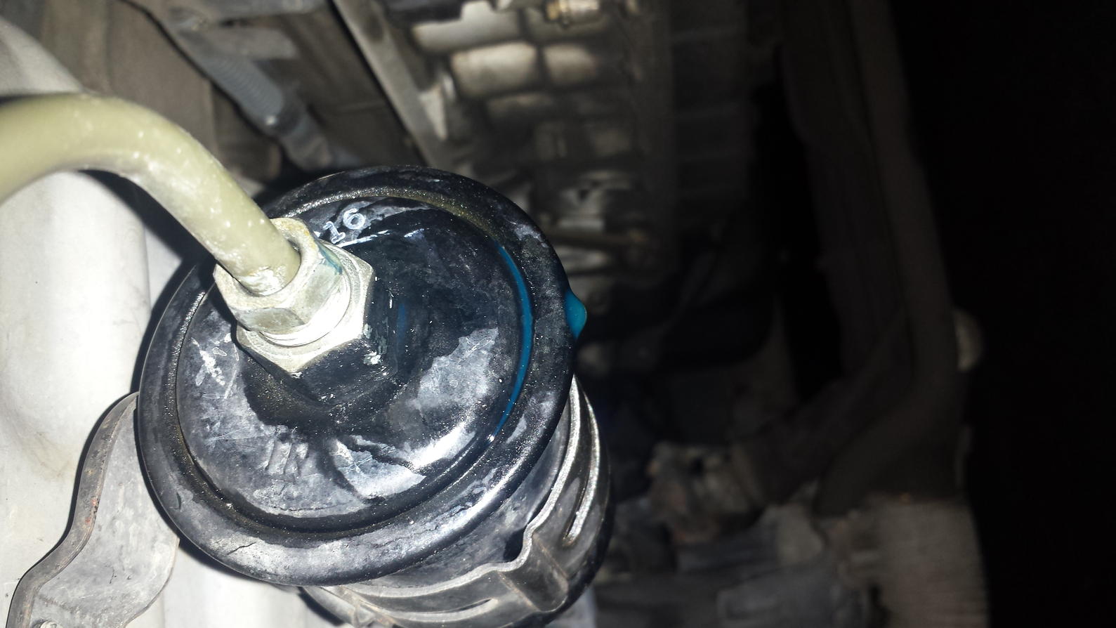

The fuel filter isn't leaking gas anymore. But it is leaking something blue. And I wouldn't say it's actually a leak more like I see a blue droplet of some substance. Any ideas? I have a picture below
Fuel filter is still leaking. Unless your truck runs on Honda OEM coolant. :)
