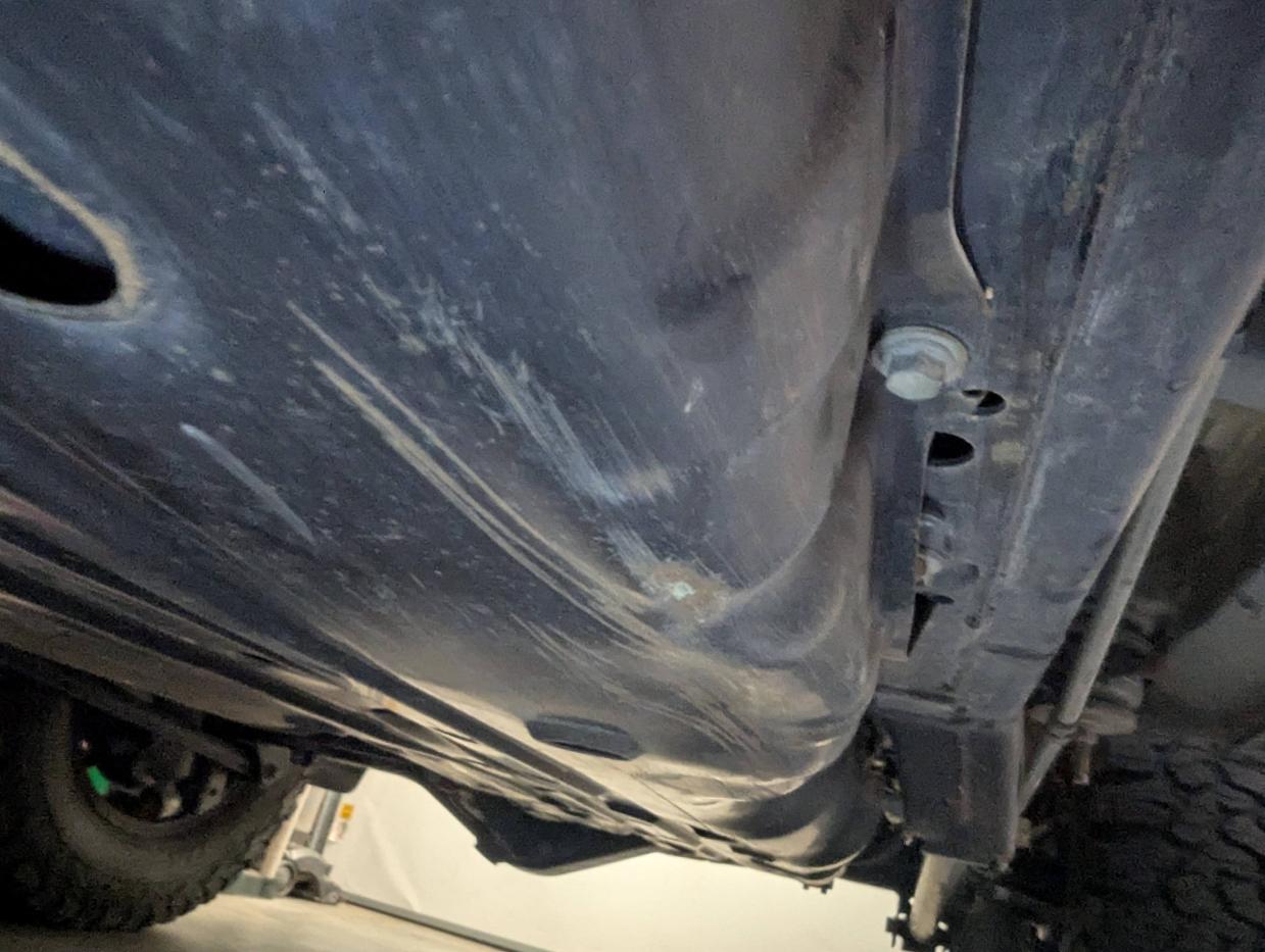

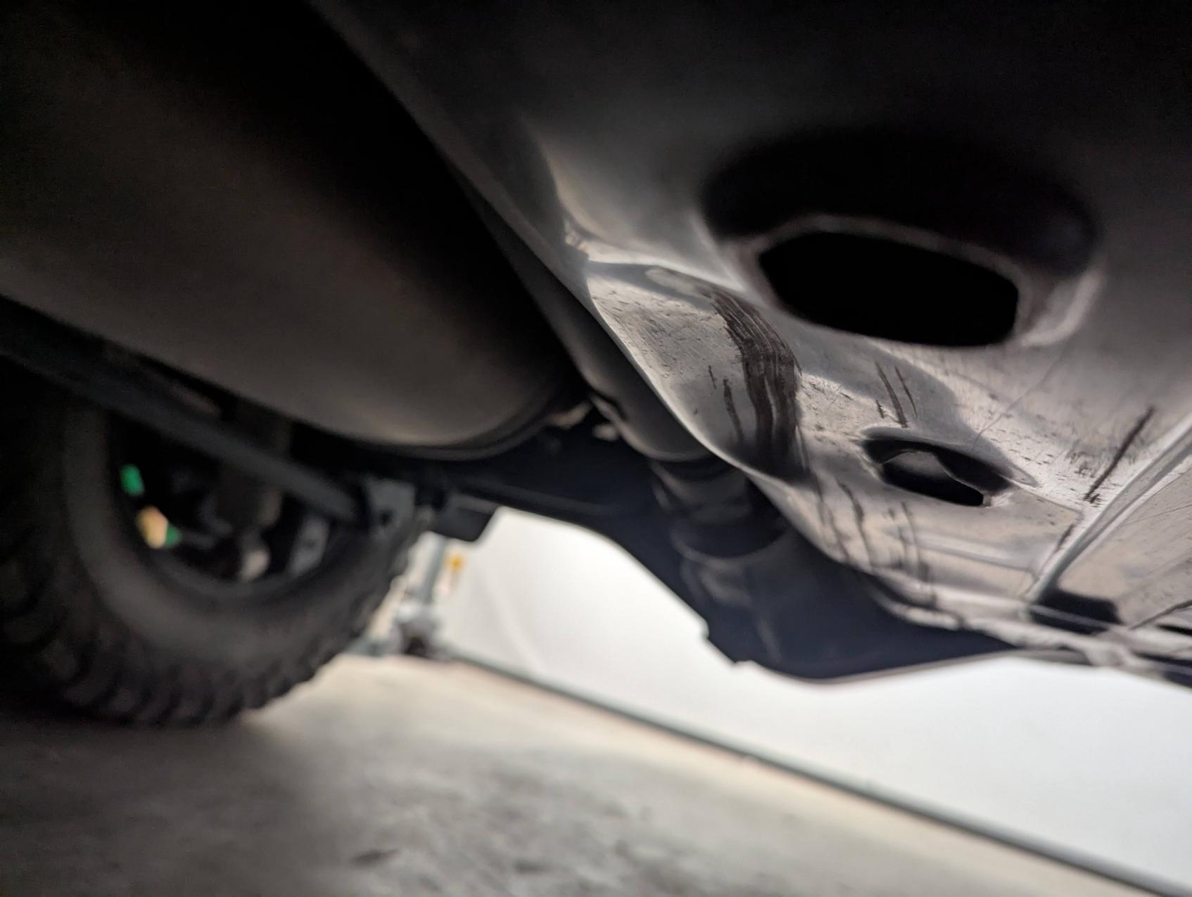

My 2018 has 85k miles and it seems like the fuel light comes on earlier nowadays. For example, When it came on today and I filled it up with a bit more than 18 gallons, so almost 5 gallons left. I know the 3.5g is approximate but I thought it use to be pretty close when it was newer. The reason I care is use when I am off-roading/road trips for reference on how bad I need to fill up.
Anybody notice the same thing and fix it somehow? guessing it just measures the level in the tank but maybe fuel filter or something.

Good point, I do have some minor dents but will look if anything new.
One decent sized one but doesnt seem gallon sized dent though. A few minor ones in the other pic. I am not sure how the sensor works so maybe the bigger one messes with it enough. It does come on and off maybe more often.

Fuel tank is plastic right? I wonder if I take off the skid and pound out the dent if the fuel tank would go back to original form.
I’ve got logs. The only time my light comes on early is when I’m on steep hills. 18.18 seems to be the lowest amount I’ve pumped back in when the light has come on, and that could be other factors. A couple times between 19 and 19.5 but mostly above 19.6gal.
I’ve had to pound out dents on my fuel tank skid plate several times but its never dented the tank. One of the bolts is difficult to get to unless you lift the rear onto stands.
The silver fuel tank skid plate bolts are 77644-60020 12mm
