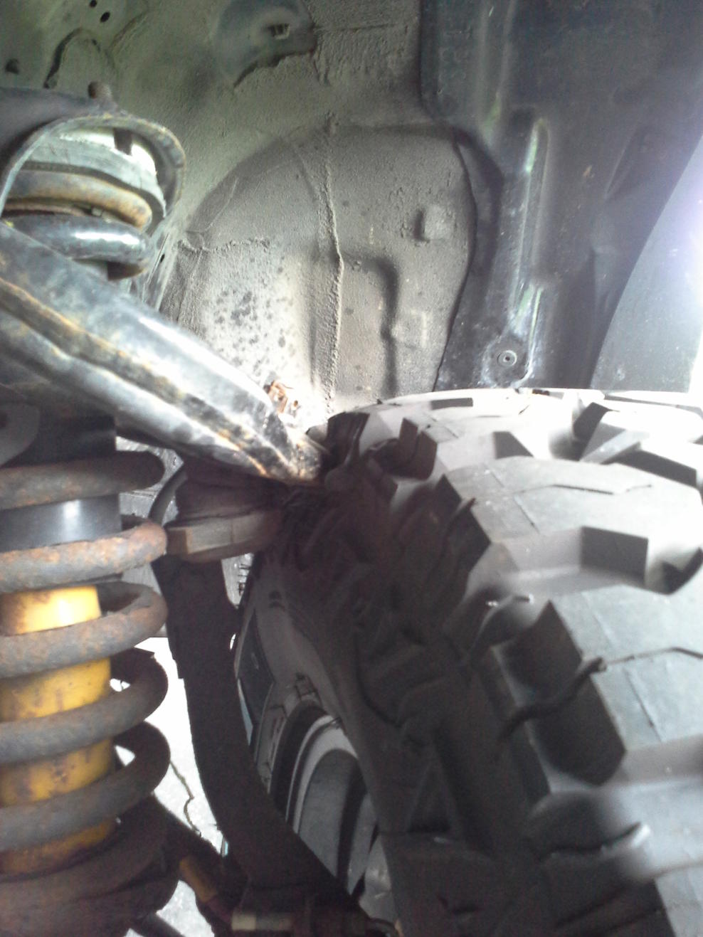

I used to have 285/75/16 on the stock split 3 spokes and had very little rubbing at full lock.
Now with the FJ wheels and 285/70/17 tires, when you unload the front the UCA pushes the sidewall of the tire slightly. So I got to do something, and UCA are not in the budget.
Let me know how those 1.5" spacers work out. That might be the fix I need. The tires are the same overall width and height as my old tires, so it has to be the FJ wheel offset.

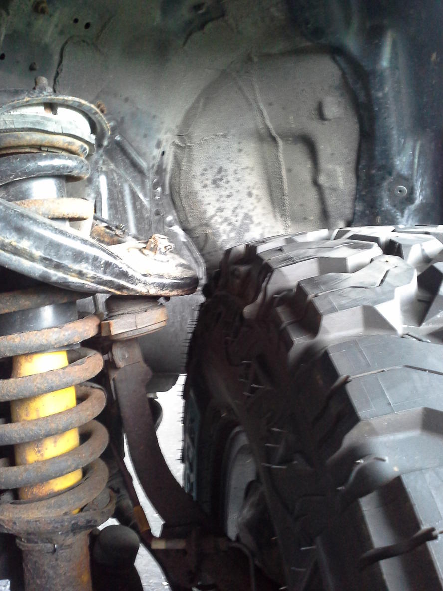

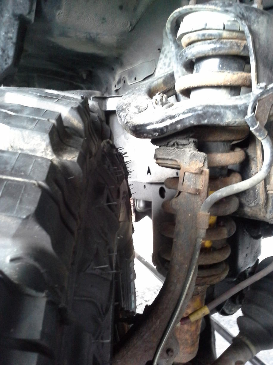

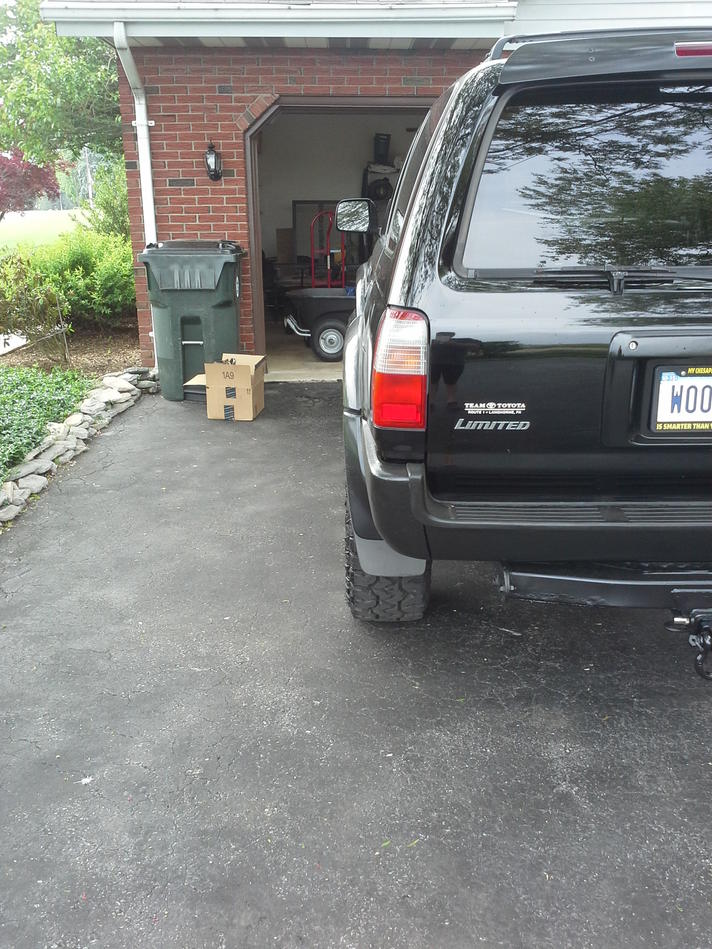

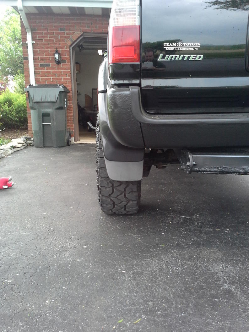

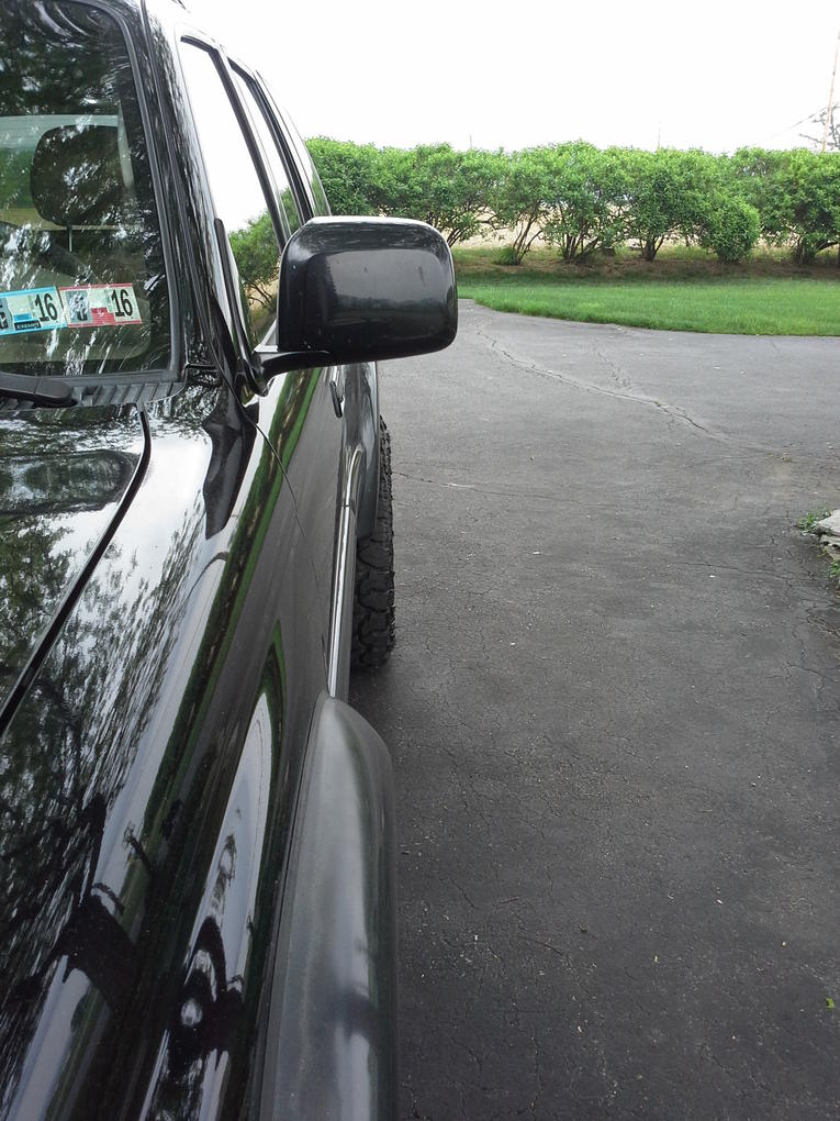

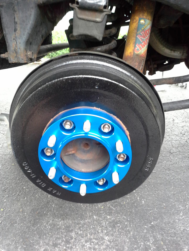

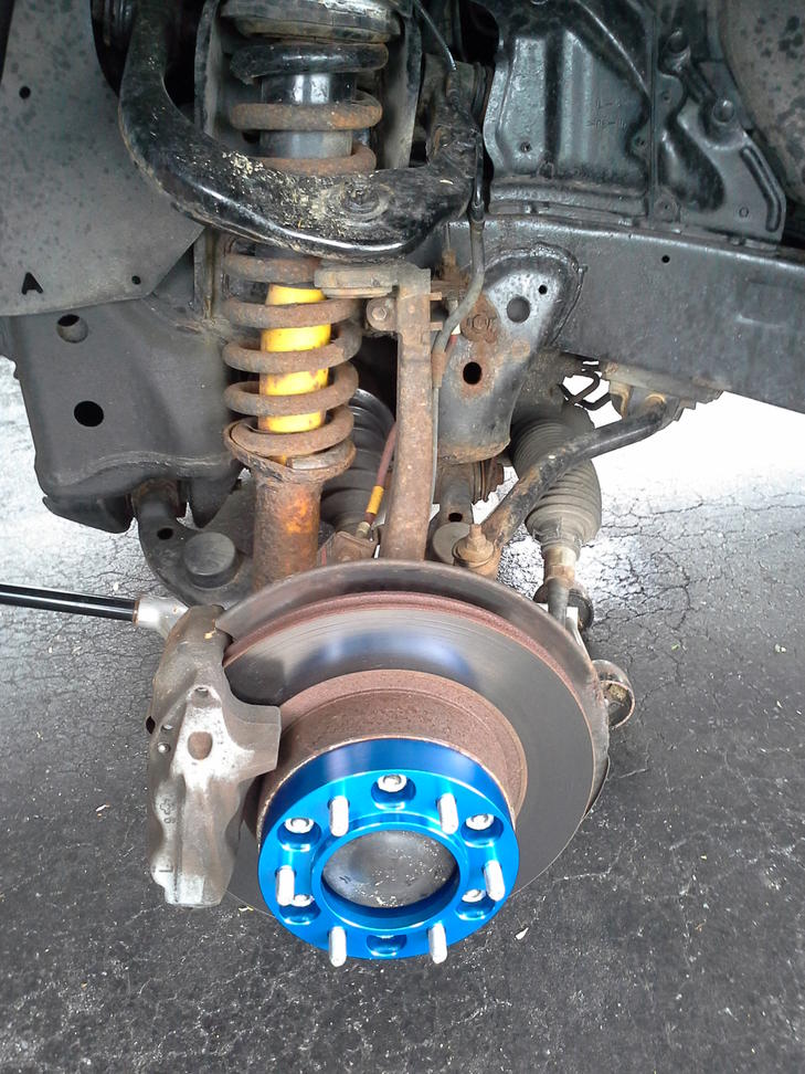

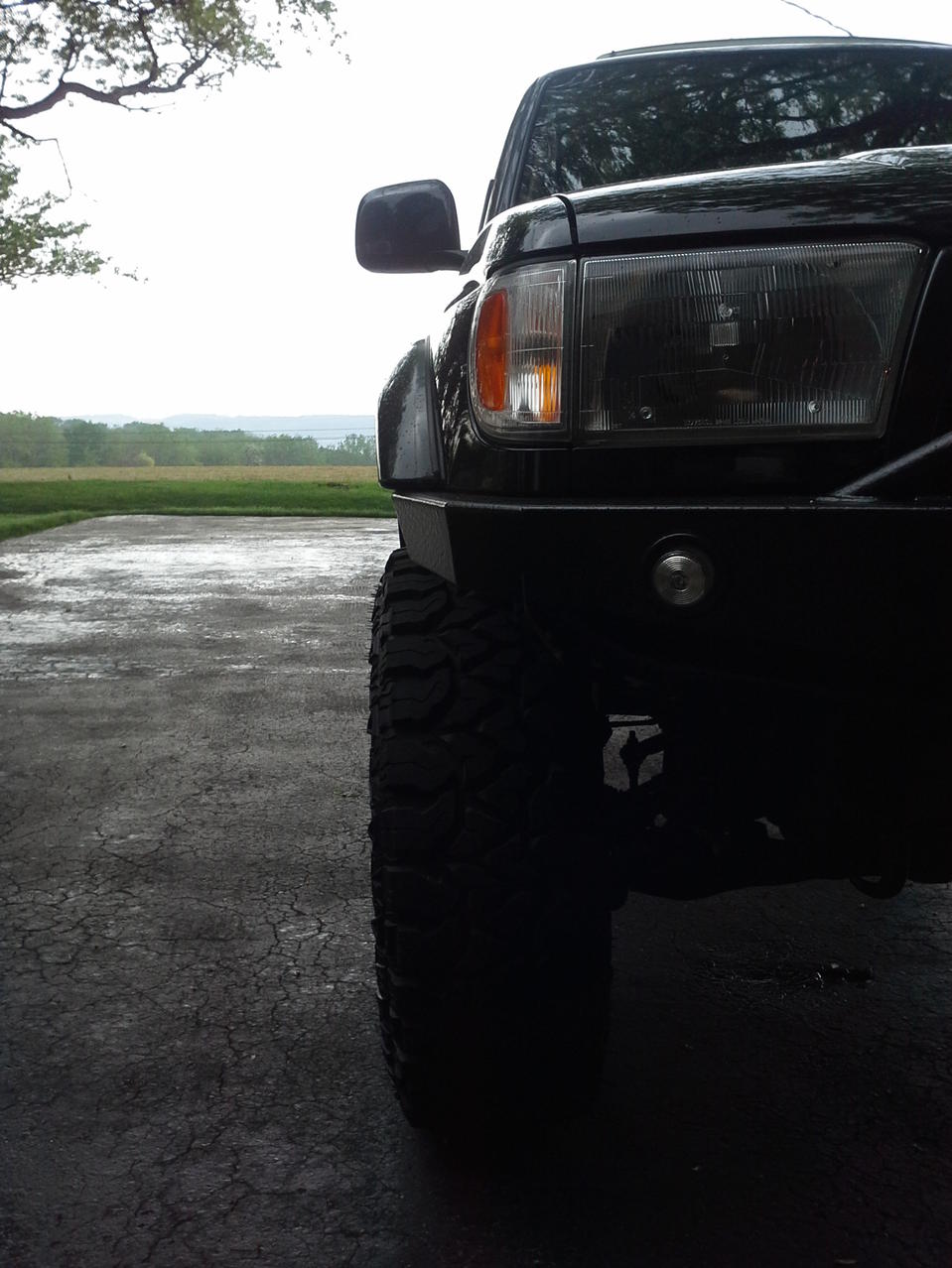

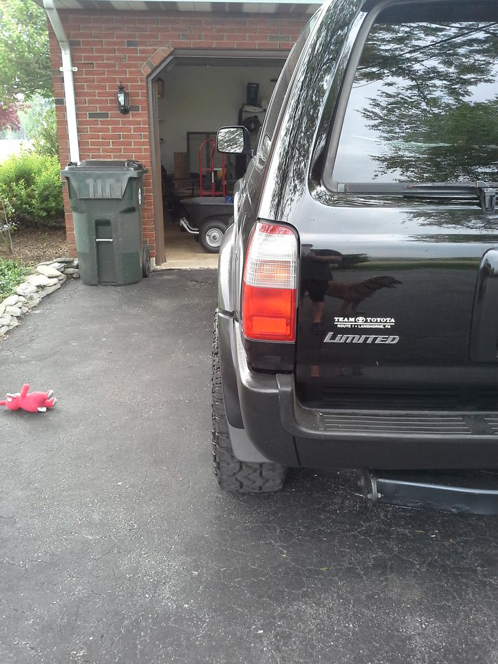

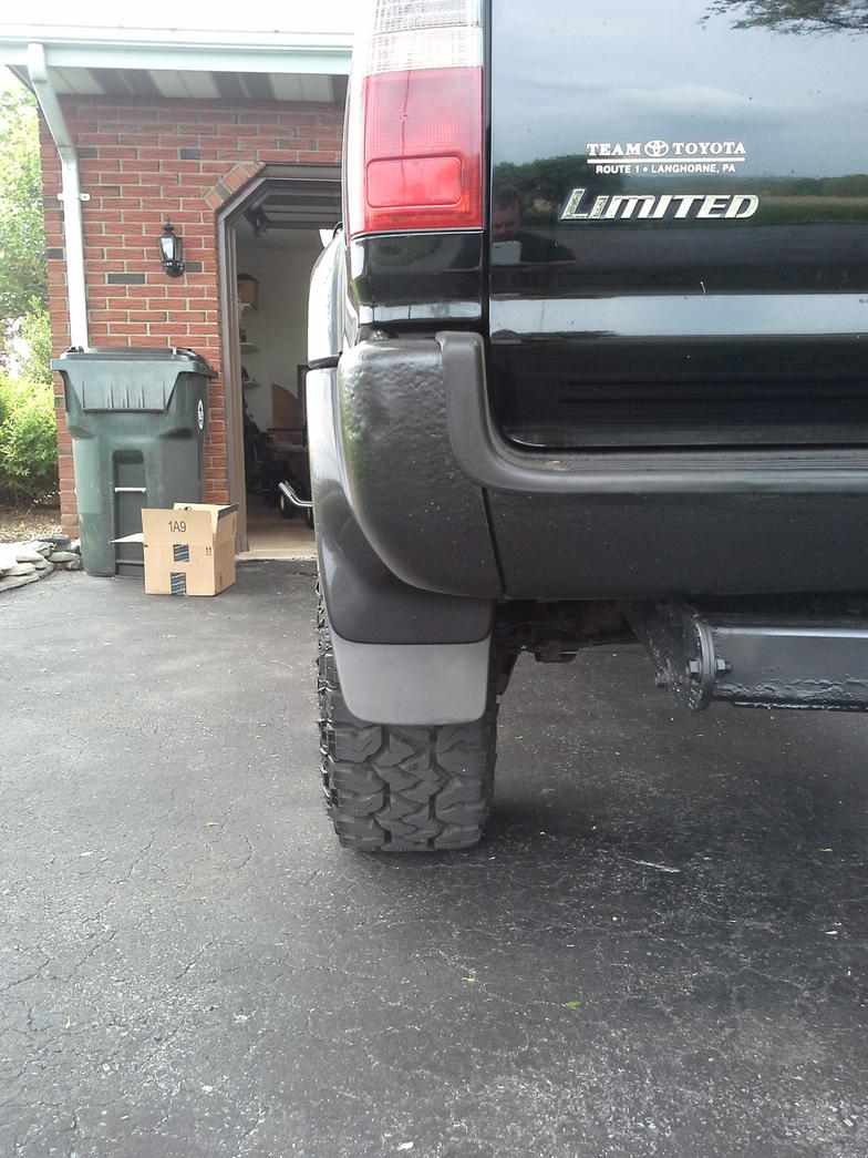

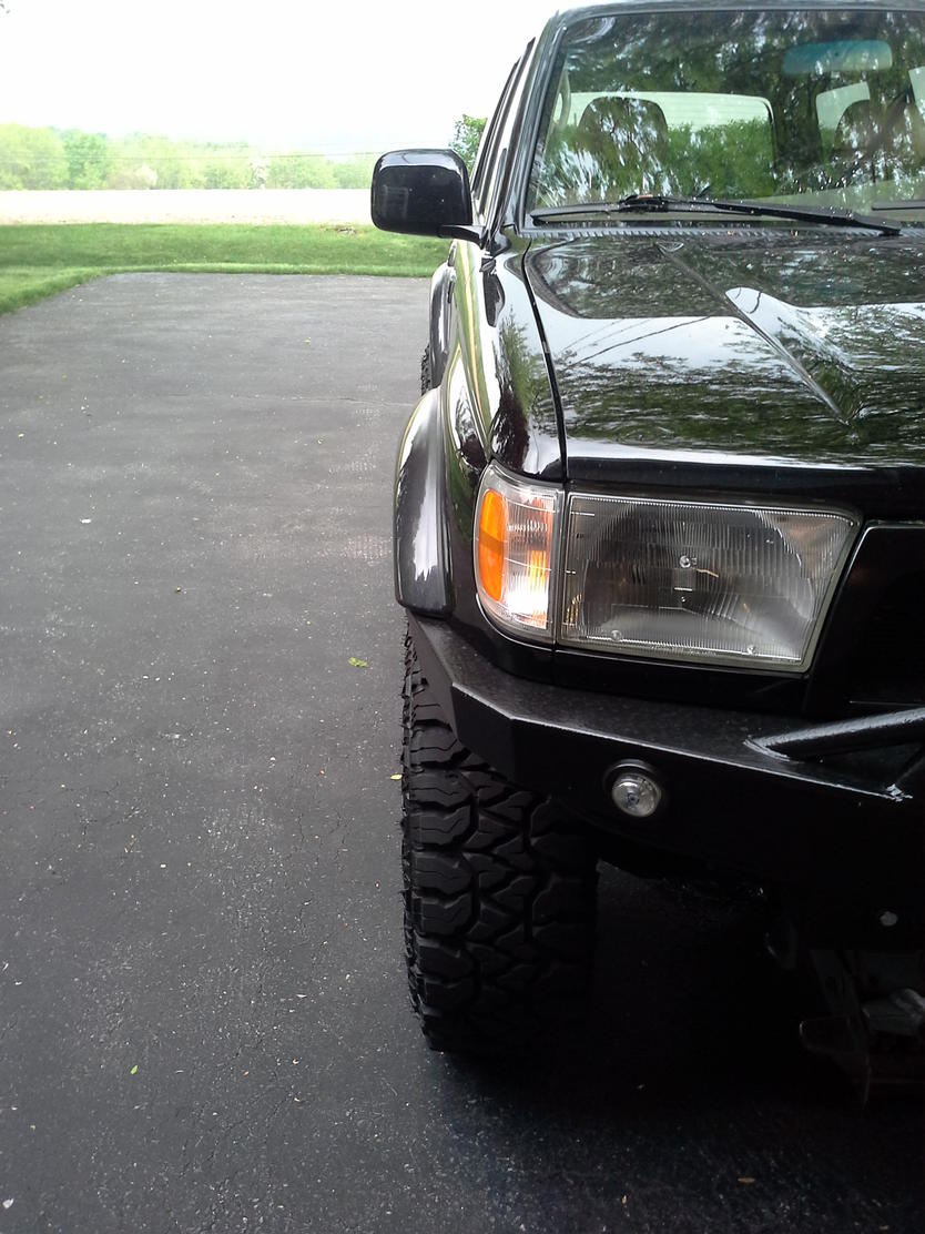

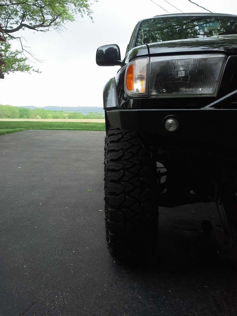

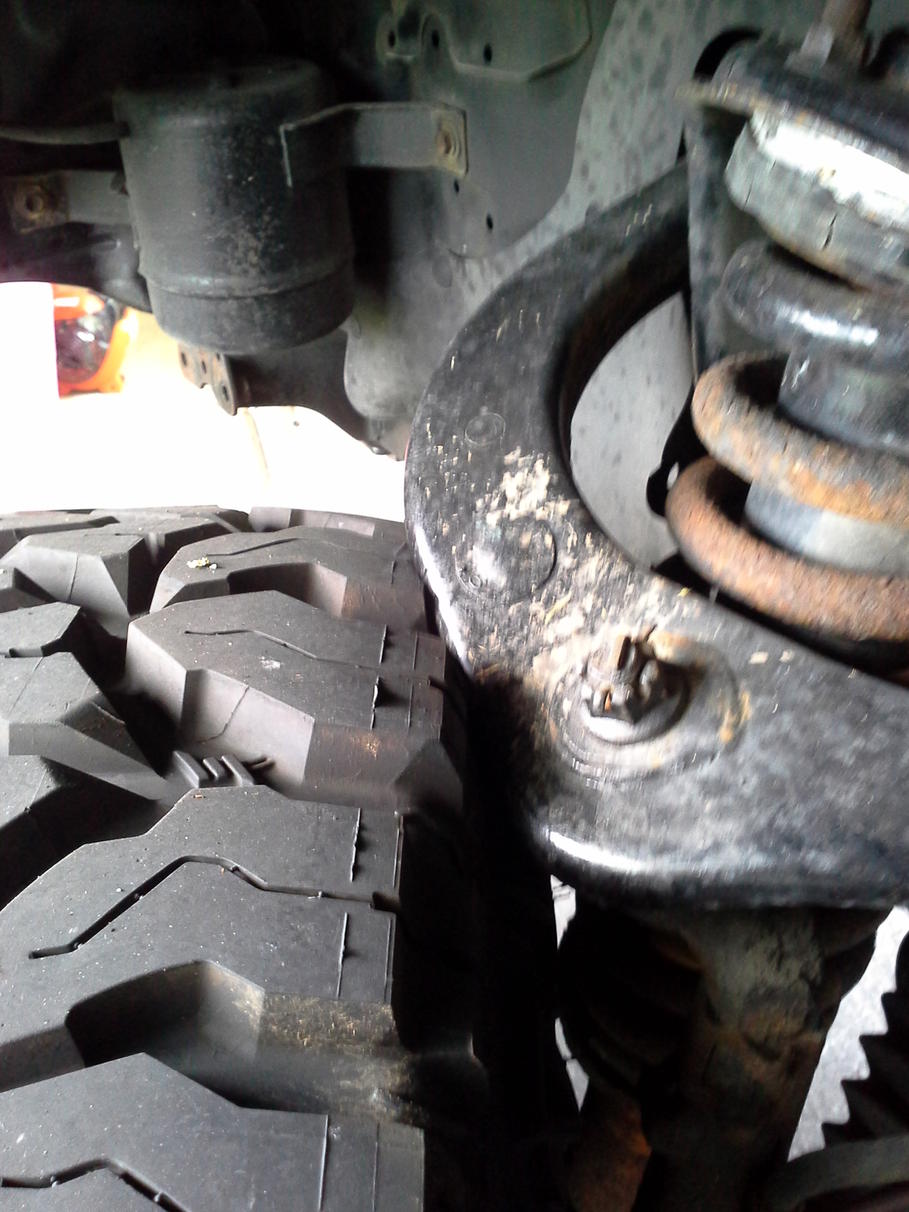

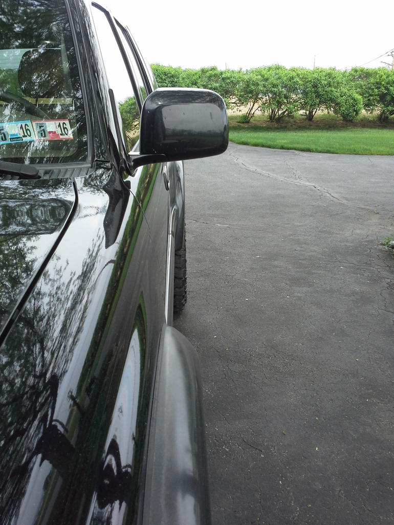

Spacers added

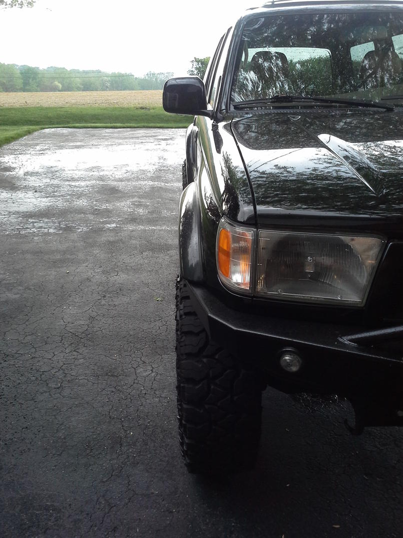

I picked up a set of spidertrax 1.25" wheel spacers and put them on today. I mainly did it because my UCA was literally pushing in on the sidewall of my tire at full droop. I like them a lot. Solved the problem, plus as a added benefit i swear the truck handles corners a bit better now. They do stick outside of the flares a bit more than i would like, so we will have to see how much crap the tires kick up the side of the truck now.
These are 285/70/17 tires by the way.

Your wheels actually look pretty good with the spacers. Are you getting any contact/rubbing in any new places...fenders, frame etc.?

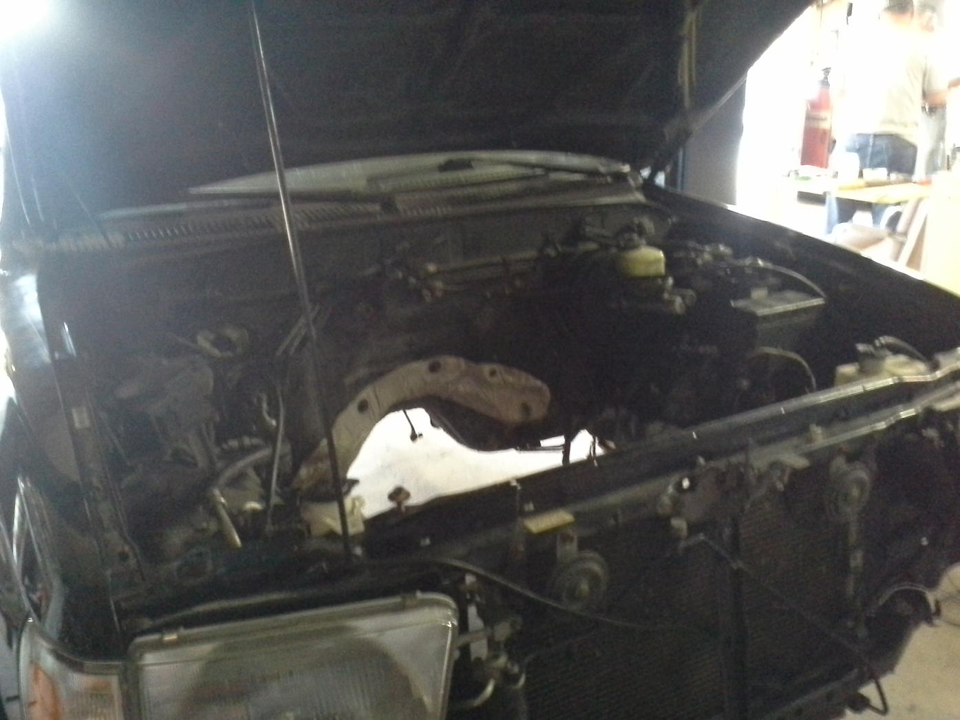

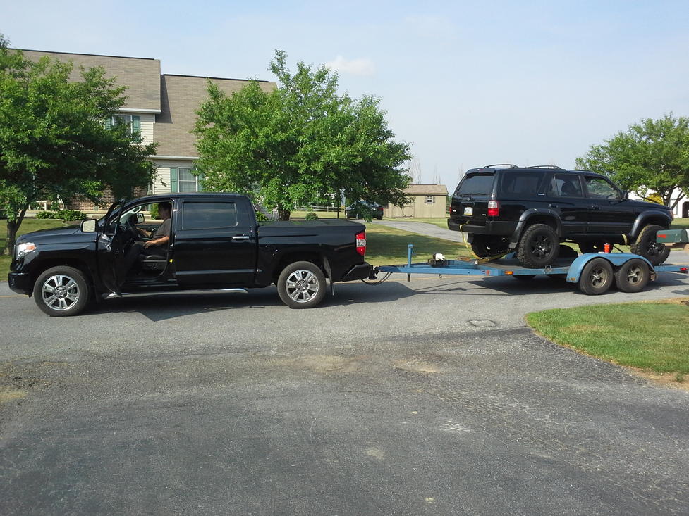

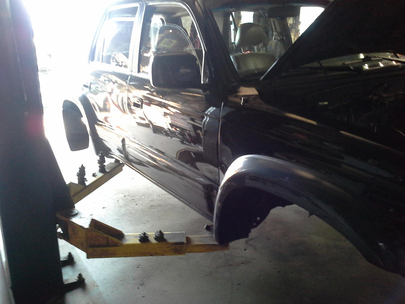

Here we have everything disconnected and loaded up to take to the garage where the lift is at to take the body off the old frame.

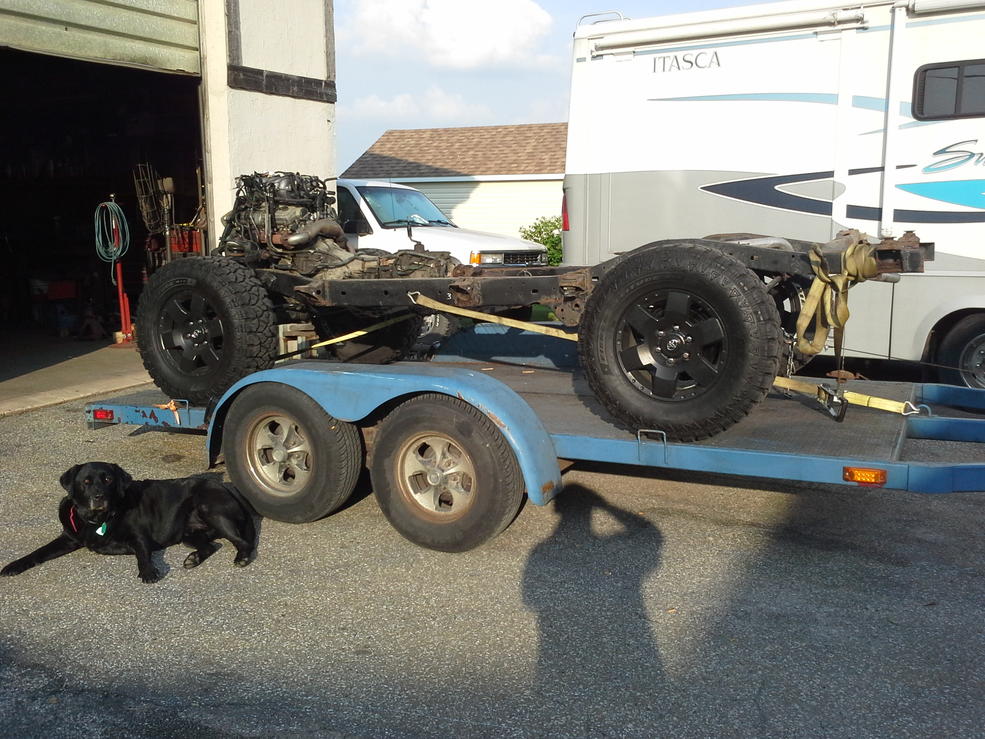

The body is off and the old frame is loaded up to take back to Kenworth's garage to start the piece by piece swap of all the parts.

Body on the lift

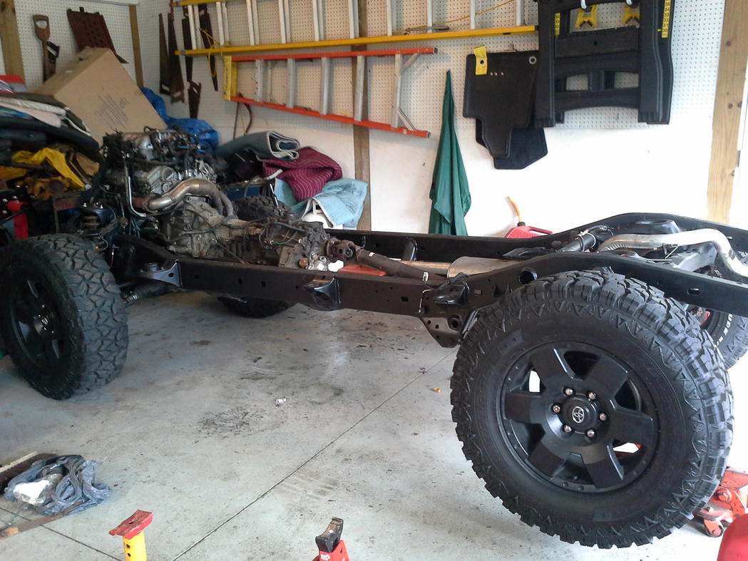

Everything pretty much swapped over to the new frame!! Time to load it back up and take the new frame to meet the body!
