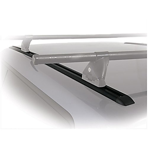

I'm thinking you could add two short extra tracks up beside the sunroof like these ones. With the appropriate bar and mounting feet it could probably provide what you're looking for. For light loads I think you could probably just glue them down:
I plan to order these cut them down to size, drill out the holes for the factory bolt locations and add one or two rivnuts up front if necessary. These have propriatary captive nuts and other tie down equipment and are also compatible with Yakima, Thule, rhino rack crossbars and feet.
Everything is quick release and modular so most of the time will just have the low profile rails on unless I'm using the racks or other accessories. Also any point on the rail can be used to secure a tie down. The rail tie down system is rated to 4000 lbs so the weakness in the system will be the roof.
Ordering stuff today will post pics on my build thread when I do the install.
