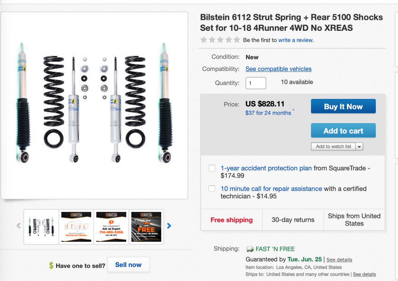

I'm being lazy on this project, it's 100 degrees in Fresno and since I'm saving about $3G by ditching the Xreas thing I'm fine with a shop doing the conversion. I'm working with a 4x4 shop that will do the complete system removal install tradition shock set-up, do the front leveling, and alignment for $1700. I know I could save some $ by doing it myself, but it's so nice having a trust worthy shop do it. It's like your gardener, yes I can mow and pull weeds but its so nice letting someone else do it.
So this is the system they are installing. Reminder.... I'm mostly a flat lander and occasionally go off road, so something pretty mild will cover my needs.
