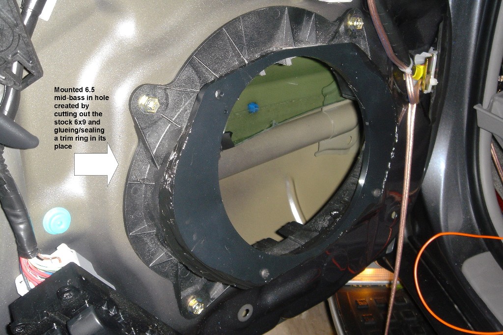

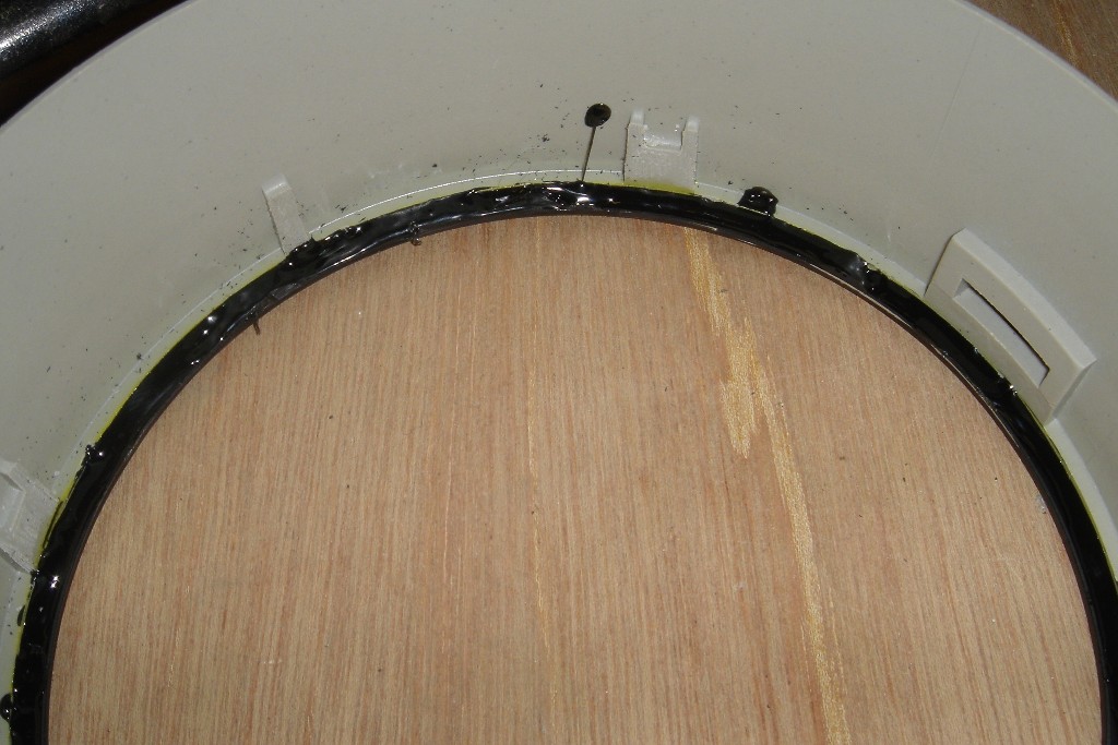

Now the Boston 6.5 LF speakers Front. This turned out to be very easy and something that those looking for speaker trims may want to try:

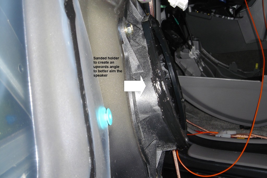

And another front shot to show the angle of the mount

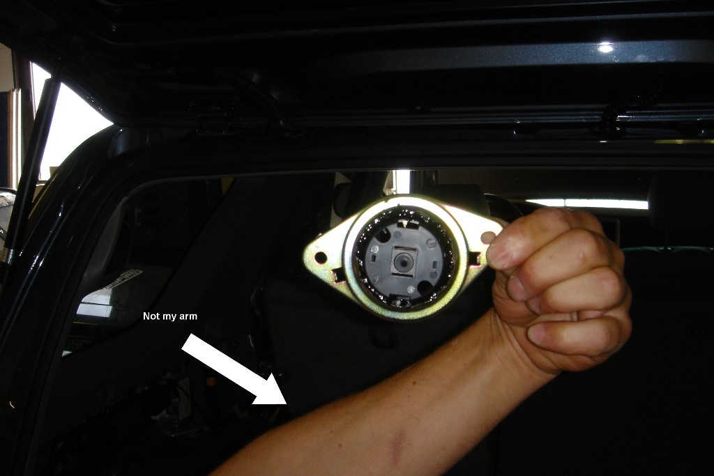

and another. Oh I should say now that I have somewhere around 30 shots so you may want to let me finish before commenting

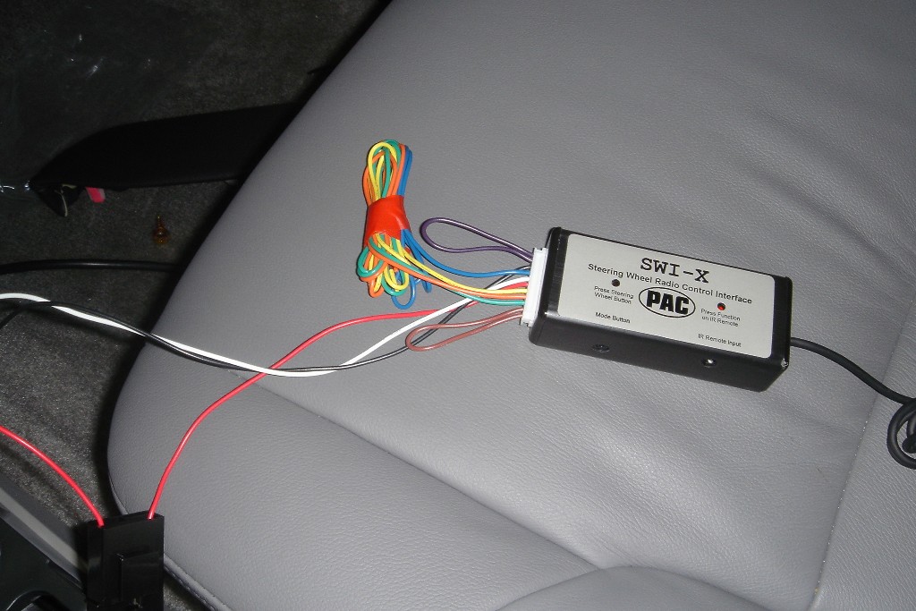

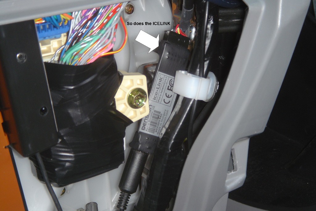

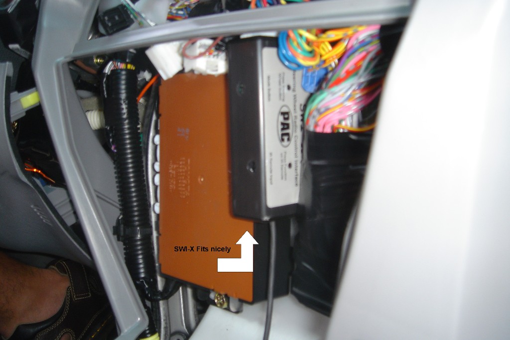

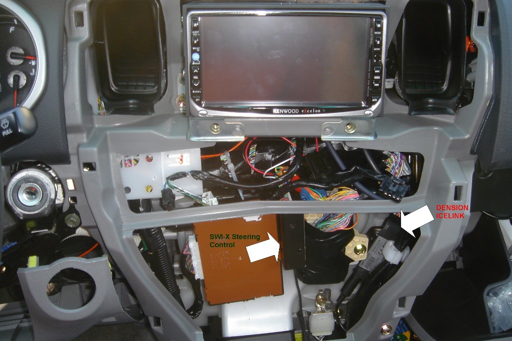

Now various shots of the receiver, SWI-X and ICELINK:
and the back side. By the way, this glue (the black stuff) is very strong Germany hot glue. I jokingly refer to it as German steele

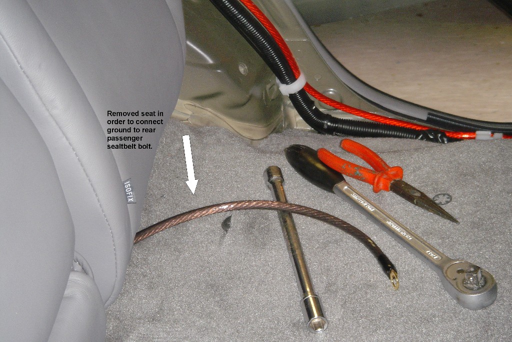

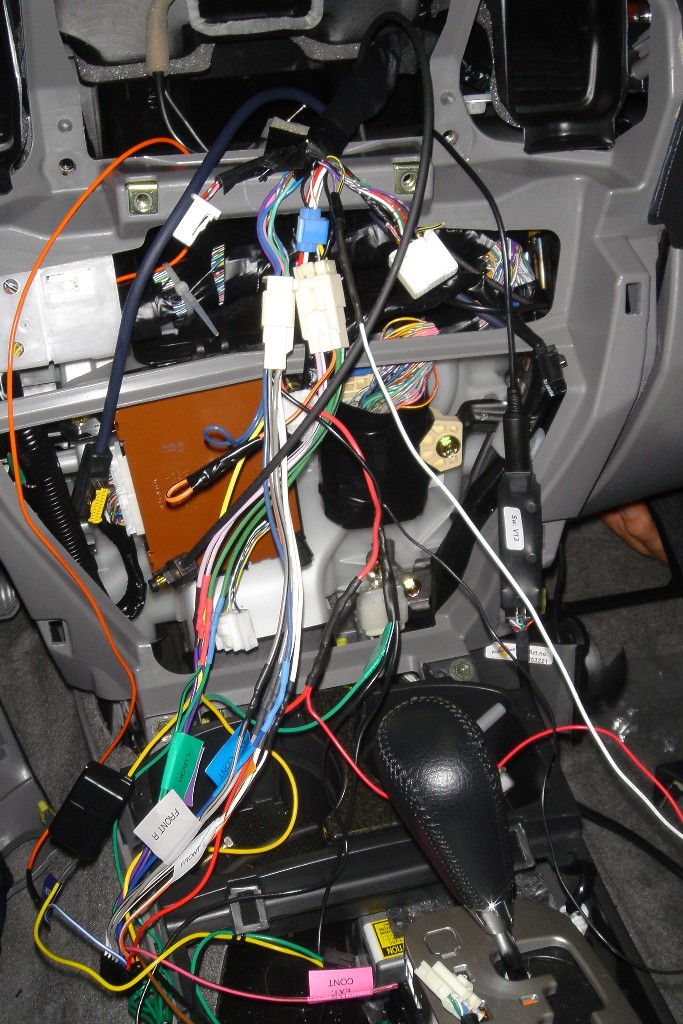

I ran all new speaker cables and of course power and ground cables. Here are a couple shots.
