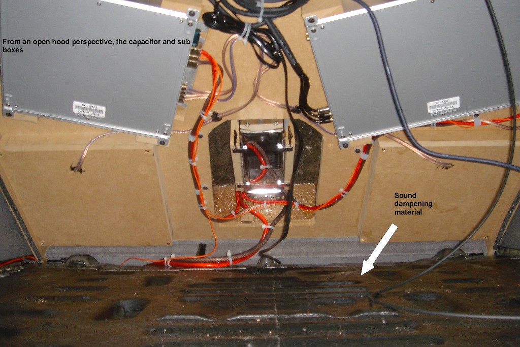

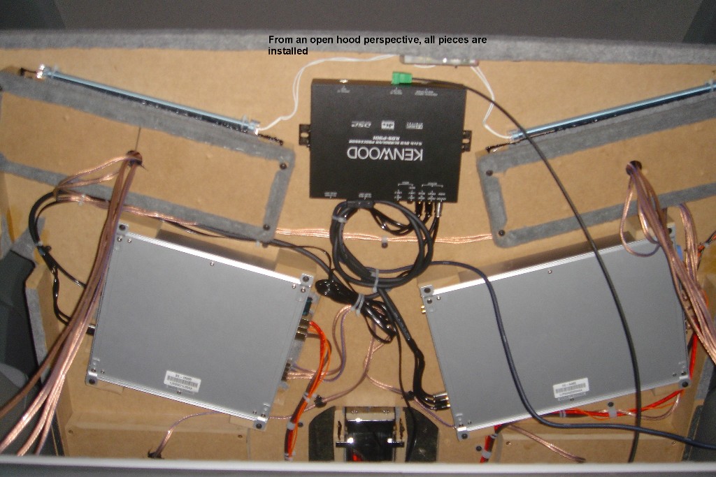

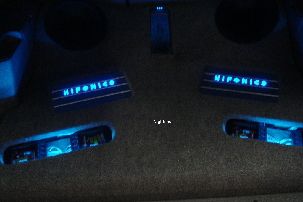

Everything is installed. The only loose cables under the floor are the speaker cables to the front and the digital fiber cable for the DSP. I didn't want to risk having that cable break. Everything elese is zip-tied or screwed down.
and the rest from the bottom.

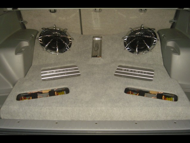

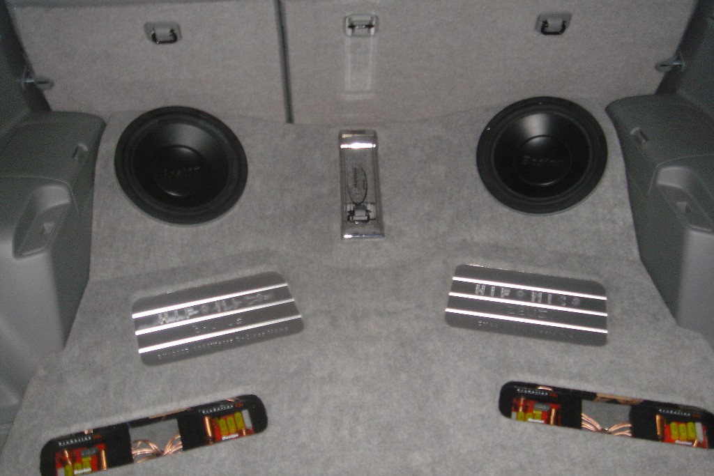

And here she is...unpowered. I have some Tsunami fishman grills coming in, but they haven't arrived yet. Next week I'll be able to finish them off.

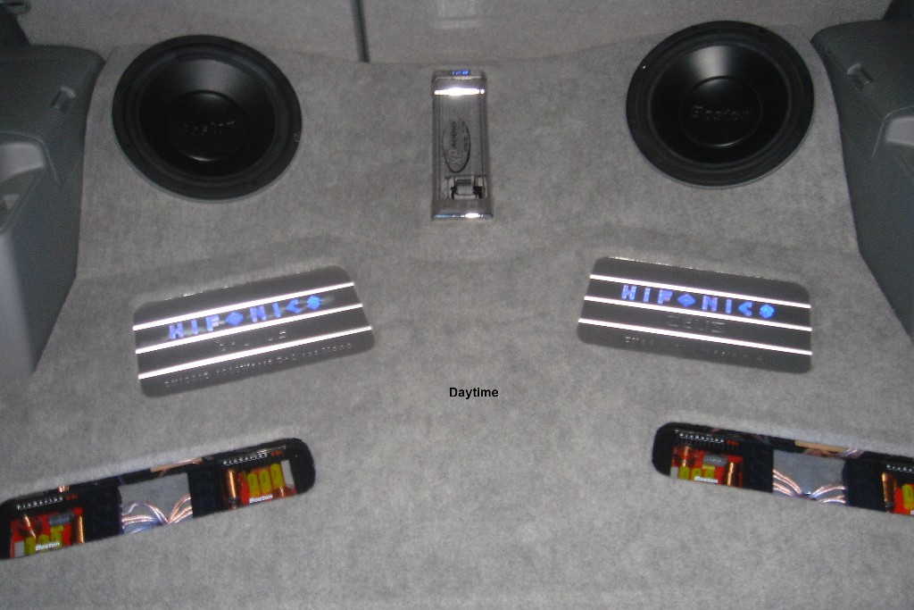

Final shot. I haven't completed the trim for the head unit yet, so I won't show that until it is complete, but the ICELINK is installed now and works great.
I hope you all enjoy the shots and I'm interested in getting your opinions. Sorry some of the shots are blurry, I'll try to fix some of those later. If you want to see something else (battery fuse holder, etc.) let me know.

I'm impressed !!! Great job. I bet it took You a lot of time to do all this. But it is realy something. If You have any pictures of you HU please post it. Did You design all this by yourself or someone helped You with it? Watching those pics makes me thinking why am I still listening stock sound....

on the speakers.. did those trim pieces come with the speakers?

1. I wish I could take all of the credit. I did design the layout of the box, but I spent a week straight with a German stereo installer and we built it, carpeted it and installed it. He runs a company called Golden Sound here in Germany. I believe he is also the CROSSFIRE rep in Germany. So, there were two of us working on this box (the arm in the picture was his).

2. The pieces I used as speaker trims were actually the factory speakers. I cut the cone, voice coil, magnet, etc. from the middle of the entire piece and this left me with trim rings that I could use to mount the bostons. I forgot to take a picture before I cut them, but if you look at yours then look at my pics you'll see what I mean.

Oh and somebody asked me so I'll tell you...SQ stands for sound quality and SPL stands for sound pressure level. I wanted quality sound which is why I got the Boston speakers. I could have gone with JL or Crossfire or some other but I wanted a small enclosure with very tight bass. Anybody who's heard the Boston Pro series subs can attest to their sound and power. These 10s are rated to 1100 watts at 2ohms. I have them in wired in parallel so I'm able to maximize the 1000watts at 1ohm from my Brutus.
I've always been a Boston Acoustic fan. I just feel they make some of the best sounding speakers around (whether home or auto). That said, it sounds awesome. I get the exact amount of bass I want; rock, rap, hip hop, alternative it doesn't matter. It always sounds good. The addition of the Kenwood DSP really adds to the clarity and pre out voltage (from 2 volts to 4.5 volts). This helps the amps push a cleaner sound signal. Much has to be said about cables as well. DON"T SKIMP ON CABLES! About $120 of my install was just for the RCA interconnects. These baby's will make or break your sound. Finally, building the right box for what you want. If I wanted rumbling bass I would have opted for ported/vented boxes. I didn't. I wanted tight crystal clear bass that would be a joy to listen to. Don't get me wrong, at a 1000 watts these baby's will rattle the 4Runner to the point I get worried about damage, but I can also ride around with tremendous amounts of bass that only I and my passengers can enjoy...not every other joker with a system that is continuously looking for a DB Drag.

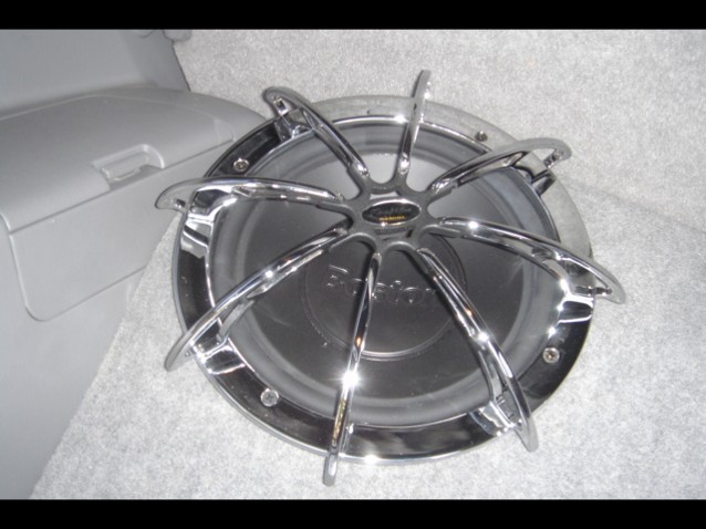

Here are some pics of the Fishman grills
