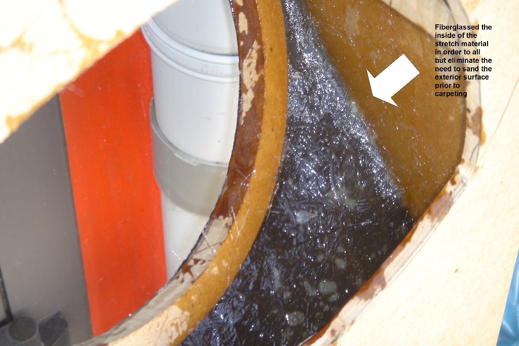

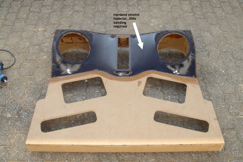

Let the fiberglassing begin. The glass used came from a nearby glass factory. It is stronger and more dense than the stuff you get a hardware stores, as is the resin and hardener.
TA-DA! That black area is unbelievably hard. Notice the shine...didnt' have to sand much on this. Only a few bumps where the resin ran a bit.

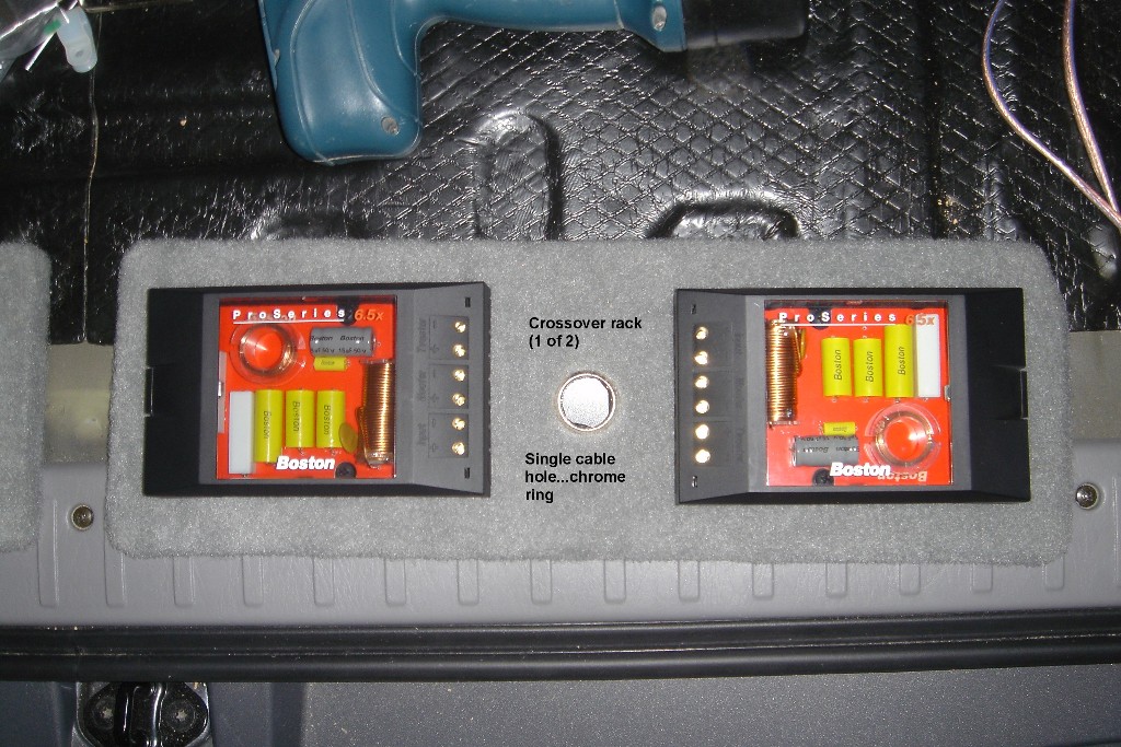

Here is one crossover rack. I used a chrome ring to keep things neat.
