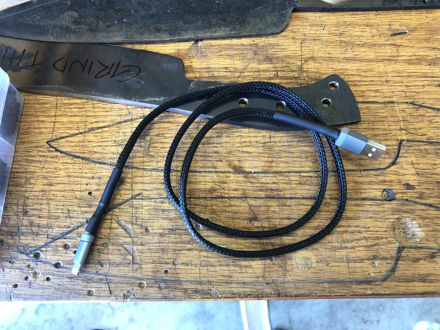

I can appreciate where you’re coming from, but that would be seriously overkill for what I’m trying to accomplish. I just want to be able to charge a phone without a cable clogging up our interior.
I mounted a Mob Armor magnetic at the top of the radio shroud, to the left of the clock, I just want a lightning cable routed behind the radio surround that exits up there to charge when needed.
I picked up an Amazon Basics braided nylon 3’ cable, some t taps, 1/4” braided loom, cable tie downs and some rubber grommets.
At this point I think I’ll just tap into the existing 12v outlet power and ground lines for this.
I was hoping my 12v to 5v reducer would show up but no luck yet. I’ll get this done soon
