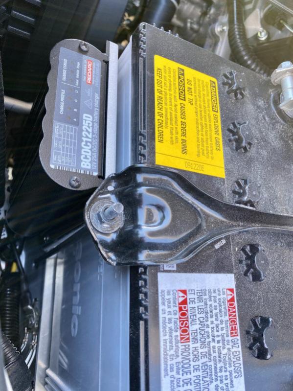

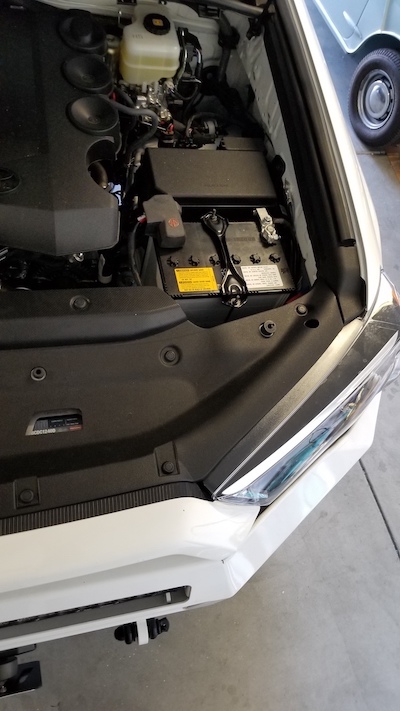

[MENTION=343163]SnoRnR[/MENTION] I would also recommend getting the 34-pc1500 vs the 34R if you are orienting the battery with the terminals facing inward like the oem battery, as the 34R would put the +terminal very close to the passenger fender wall. it it happened to move and touch there would be some fireworks.
I am actually just finishing up the wiring for my dual battery setup today using the shrockworks kit as well with a 34-pc1500
How did the install go? I have all the components just need the battery. I was thinking about going with the 34R-PC1500 and installing it in reverse with the terminals at the front. Do you think that would work? I really would like the option of moving it to the starter location if I got a catastrophic fail.
It fits, but it is an extremely tight fit. you pretty much even need to shoehorn it a bit just to get it in place properly.

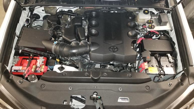

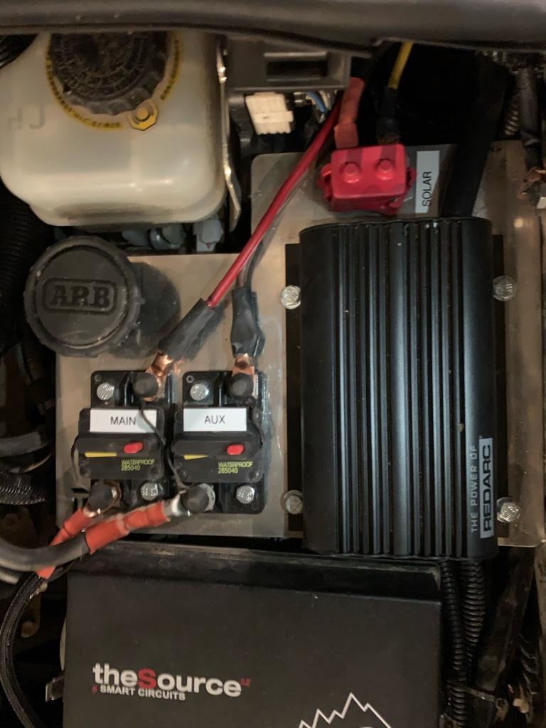

Heres mine, C4Fab battery tray, used 8g cable for battery connections.Same size as Brown, Red, Yellow wires as the Redarc uses. Blue Sea 40a Circuit Breakers.
ARB refrigerator wiring harness run along passenger side to rear.
Blue sea 12v receptacle for my fridge. Its January in WI. so fridge is in the house. Dometic CFX50.
AGM Battery I bought from Batteries plus, Only one I could find that has the positive not on fender side. Same as starting battery.
Can swap if necessary.
Hey there I'm working on a similar setup and I had a quick question. Why did you go with circuit breakers over fuses? Is there some functionality they offer that's better or safer than a fuse? I've got the fuse blocks ready to go but have now seen two different builds using the blue sea circuit breakers so I was curious. Thanks!

You can electrically disconnect power to it with a button. Thats one reason.
If it does mange to trip it is resetable. Don't have to change a fuse, just move the lever to reset.

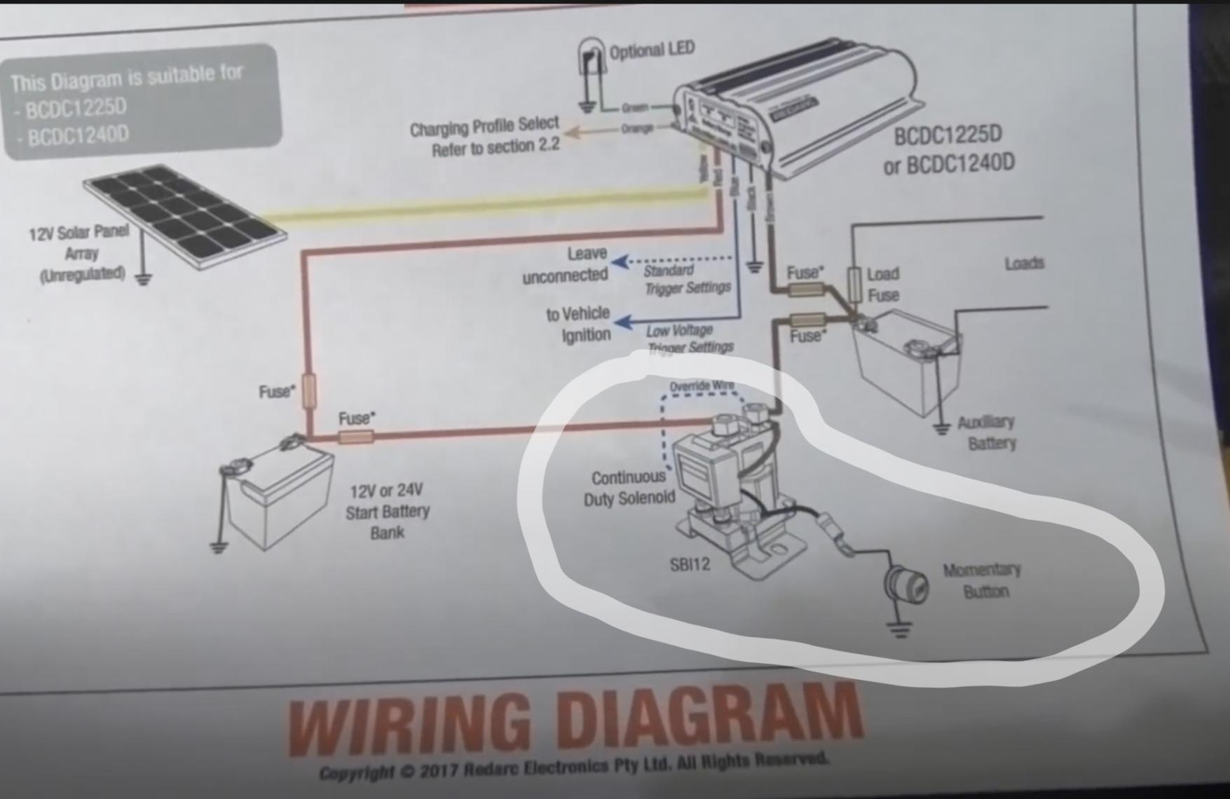

I am just using your thread instead of starting a new redarc topic. I am also installing the same redarc and removing my Nantional Luna dual battery system, that never worked right with the 4runner system. I am curious where did you run the blue wire? did you use a fuse tap? I will also be installing solar to my system. I linked a great youtube video where he used an older solenoid system similar to the National Luna to use as a jump starter. I would love to have my system to have that option. How is the heat with the unit? I built a tray, but now relize the aluminan tray holds the heat. I need to either cutout holes to vent more or add washers to raise it off the tray.
Redarc BCDC 1225D and SBI12 solenoid install in Prado 150 - YouTube
I saw a video start at 3:41

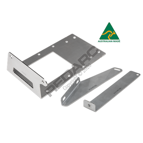

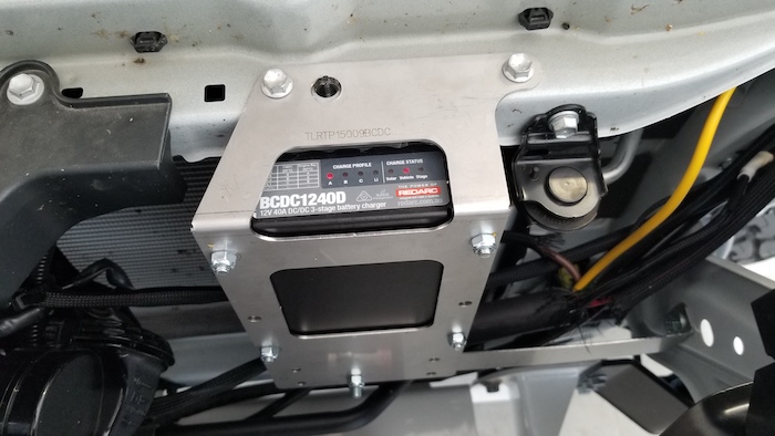

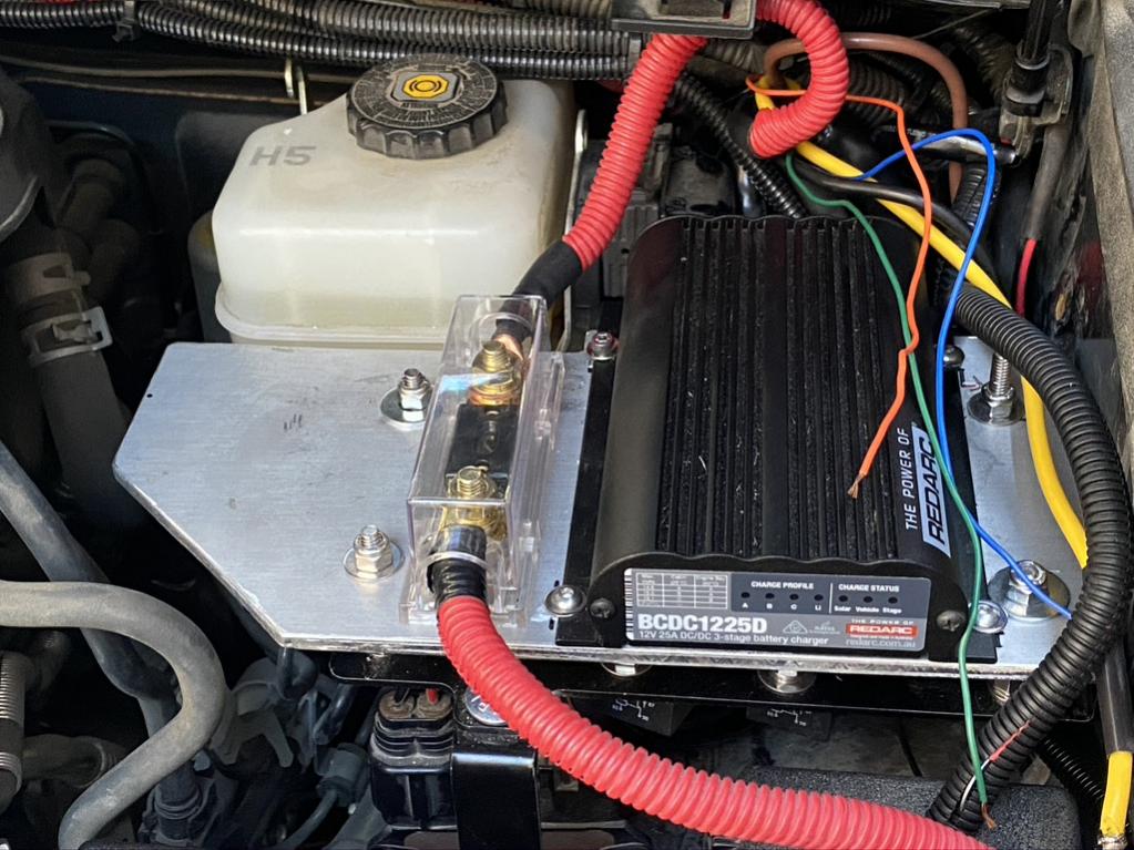

First off I would avoid putting your BCDC in the engine bay. I know that people do it but Redarc does not recommend doing it as it will be prone to overheating and be much less efficient. Put it out in front of the radiator with a Prado 150 mount if you can. Out of Town 4X4 in Australia has one as well as Redarc Australia. BCDC Mounting Bracket to suit Toyota LandCruiser Prado 150 | REDARC Electronics The mounting is exactly the same as on the Prado, but you have to move the horn mount a bit, it will be a much cleaner install. I would also use the Blue Sea Systems MRBF Surface and Terminal Mount Fuse Blocks. They mount right onto the battery terminal so that all cabling is protected, also easier to install and cleaner.
Heres my set up. You can see the Redarc 1240d just to the right of the hood latch.

Further, over the past decades, I've been in the boonies for a several days, and like the peace-of-mind of being able to jump-start my Main Battery. So I added a Cole-Hersee continuous-duty solenoid (200A cont, 600A intermittent) to let me "combine" the batteries in circumstances where I need to jump-start myself, or when I may wish to have the Main battery assist the Aux in prolonged winching.

I'll second this (keep the BCDC out of the heat). I looked at the Prado mount, but it was going to be costly and slow to get this (all the way from Australia; at the time I was looking, there were none in-stock elsewhere, so mine would be a special delivery :sad:
My choice was to go with Off-Grid Engineering, and their Redarc BCDC Mount/ Battery Tray. This has a vertical mounting surface for the BCDC, and an orthogonal plate which is captured beneath the stock battery - simple!
I think this behind-headlight location is relatively cool, but then cooling is enhanced by the "prop-wash" of the mechanical engine-fan.

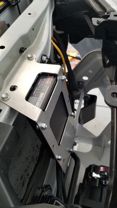

[MENTION=352797]ruff4runner[/MENTION] -- can you show how the Prado 150 mount attaches?
I’m not going to argue that more cooling isnt better but I’ve had mine mounted deep in the engine bay for two years with no issues whatsoever. It’s been through extended 100+ F long trail days and never skipped a beat.
It mounts in front of the radiator on the left side right where the horns are, so you have to move the horns. The mount fits just as it does in the Prado 150. I cut out a hole in the radiator cover so I could see the LED readout.
