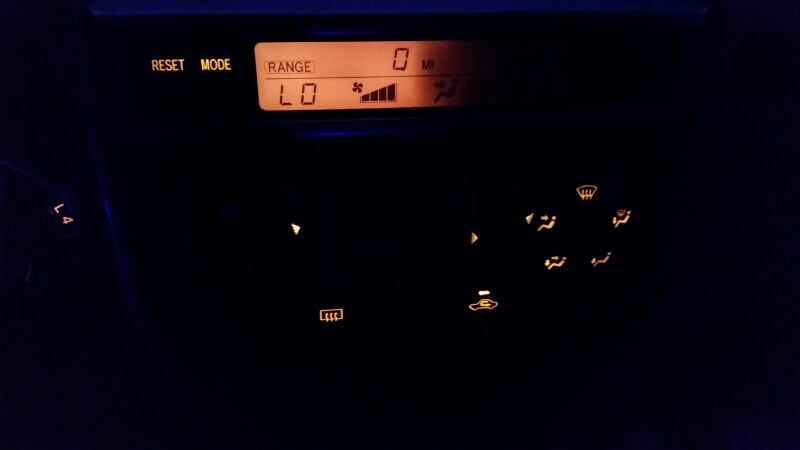

Hm...it appears they blew a bulb or a connection in the multifunction display too. (Is that the proper name for it?)
The LCD is only half-lit and the fan speed and temp select wheels are only partially lit.
attachment.php
