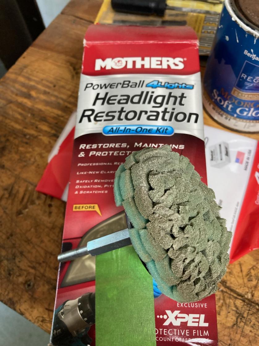

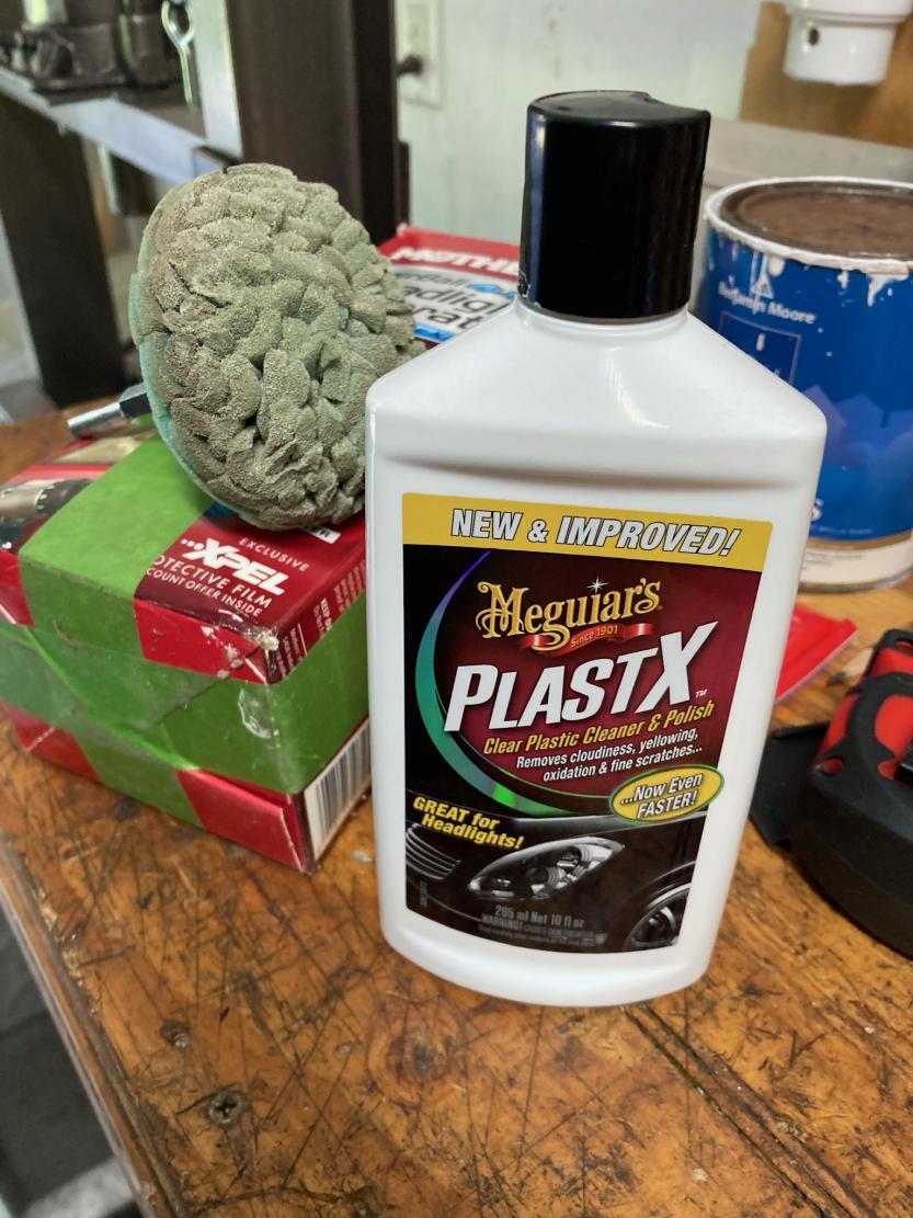

Buff it with Meguires PlastX compound. I use a foam buffing ball in a cordless drill.
You use the buffing ball on your gauges? Doesn’t it fling the PlastX everywhere?
Also, a PSA to anyone using PlastX - great product but wipe it before it dries. It’s not like wax where you buff it off after the haze forms.
I would imagine he removes it to polish...
