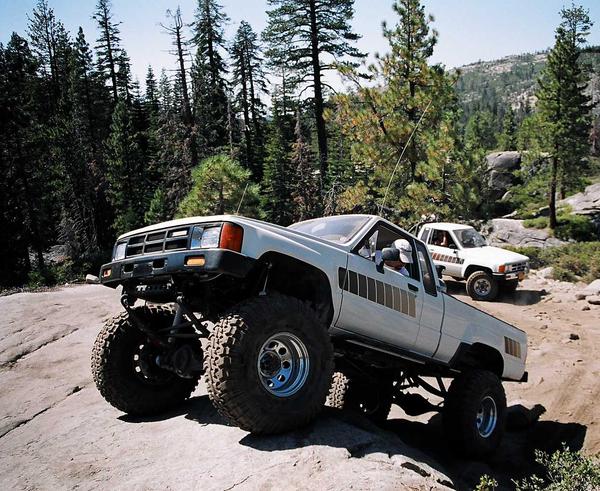

the bigger tires offset that gearing though, so with dual case and 529s and 40" tires on a 8" solid axle its not the same. CVs are no where near as strong as birfields, and stock birfields are not the strongest. i have wheeled some trucks with dual case and 529s.
this truck had 37s with 529s, longfields, ARBs F&R and dual cases and we still would snap stuff. this was back when i lived in CA and would run the rubicon 2-3 times a year along with fordyce and several other trails. we finally went to dana 60s and cut them down as much as possible to keep it as narrow as we could...
im not trying to say dont go to 529s, in fact i think he should, he will be much more happy with the out come. but i am rather cautioning J and anyone else who is thinking about this that with lowering the gearing comes added risk of breaking parts.
yes J will no doubt be able to go more places with the 529s, but that will also lead him to try new harder lines on things which will lead him to pressing things further harder. and that will lead to more breakage of stuff. its just the nature of the sport. just trying to say what no one else is saying so that everyone who is thinking about this will be on the same page with the most info available. :bigok::cheers:

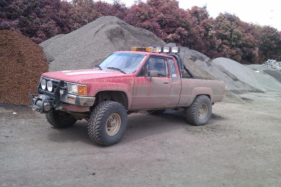

you will be happy, you could(should) also (when the time comes) replace the clutch with a more heavy duty clutch like a center force dual force or something along those lines. i have those in my trucks and they feel like the stock clutch and have way more holding power and can take some serious abuse(one has an LCE motor 2.6l 22re with stock 410 gearing and 33s) over loaded.jpg
i love the center force clutch, i wont ever buy another brand

I have a brand new aisin clutch in it. I did the whole job in a day alone and i really really really dont want to have to do another clutch for while.
Finding HD clutches for the 3.4 is a little hard. I got this aisin clutch kit with koyo bearings for $190 Those center forces are pricey, But that may be in the future.... If the gearing doesnt help, But im hoping it does.... I think the issue is the tire size and weight of my truck with the 4.10s. Lets hope the gears and 35s help
