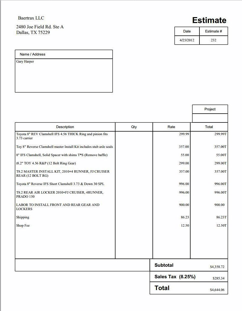

Anyone got a cost-breakdown of what lockers plus re-gearing would cost? I think I saw that our lockers are about $1k each, parts alone.
What's a reasonable install price for all that?
This was an estimate from Baertrax,one of the most highly regarded shops for Toyotas in the DFW area and they had just done one of the first on a 2010 FJ with the new 8.2 rear a week before. The estimate did not include installing the air compressor or running the lines as I already had them.
I didn't use them but had this estimate done.As stated in my write-up I had ECGS build them for me for much cheaper and swapped them myself....Call and ask for Chase at ECGS, 5 year warranty .
Competence in something like setting gears up is of the utmost importance and I recommend a shop that has worked with the new 12 bolt 8.2" rears as they are quite a bit different then the previous Gens..
Here was the estimate.....
