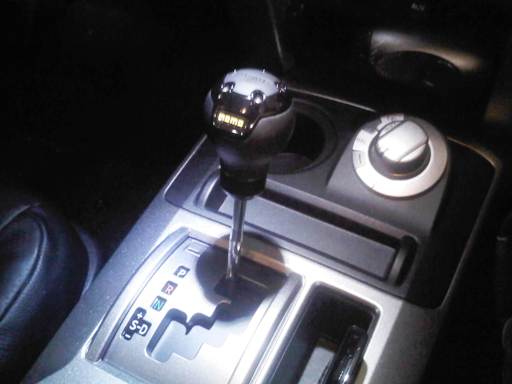

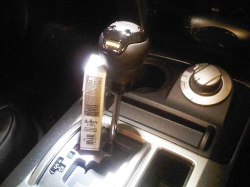

So I got the shift knob and had it on for couple of days. Felt kind of weird having it sitting so tall and the shaft was too thin to install it securely (it wobbles and twists). So I took it off and really studied the new shift knob and figured out how to solve both problems.
The package came with five different "caps" in different sizes so it tops off the shaft and use three screws to tighten the shift knob to the "cap". I used the narrowest cap and there was room to wiggle. What I also found out was the shift knob itself is pretty deep. With just one cap on there, there's about an inch of empty space. So I proceed to put one of the useless cap in the knob all the way in, cut off the top of a second one so the shaft can go through, make a hole of the last cap (the one sized closest to the shaft) so the shaft can go through and hit the top of the shifter, and finally cut off tiny pieces of rubbers to fill any voids for the third cap.
Attached is the finished product. It sits much lower now and doesn't wobble or twist.

Way to improvise and make it happen pimsta!
Looks good:pimp:

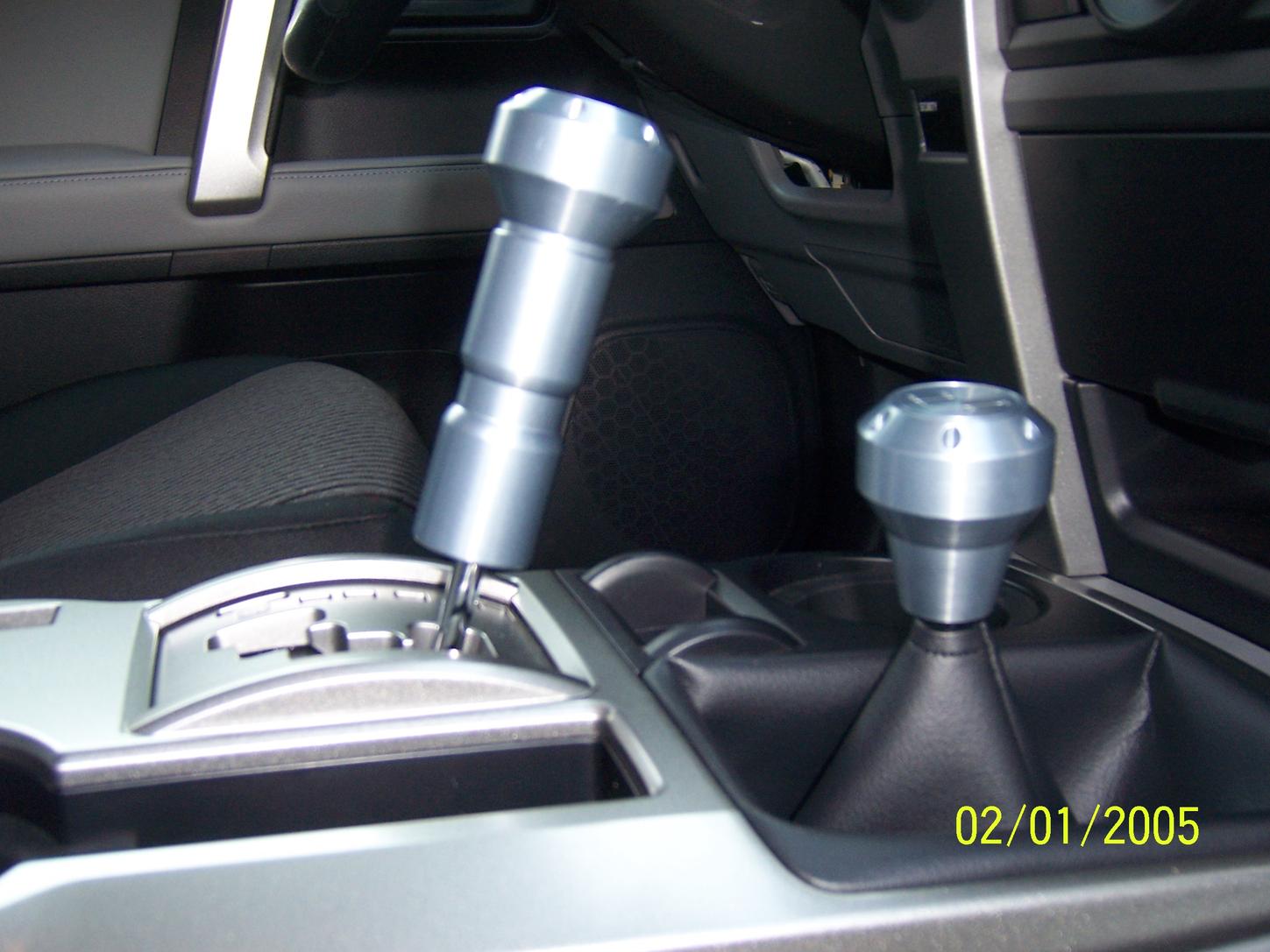

Here's a set I got for my 5th generation. I will get a set that has 4R on it in the future.

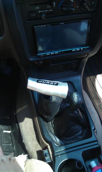

After 200k, the stitching finally blew out on the shift knob on my 5spd. I looked at all sorts of stuff ... I like the TRD option, and there's plenty on ebay for $30-40. There's tons of other options - I like the Momo/Sparcos but the price ... can't justify >$100 on a shift knob, no matter how purty.
So I went with the knob that I had on my old FJ-40. I know I'm probably breaking some rule of automotive etiquette here, but so what :P ... feels good, looks good, a little different ...
(edit: apologies, didn't realize this went into the 5th gen threads; just followed up on some of my 'shift knob' searches ... )
