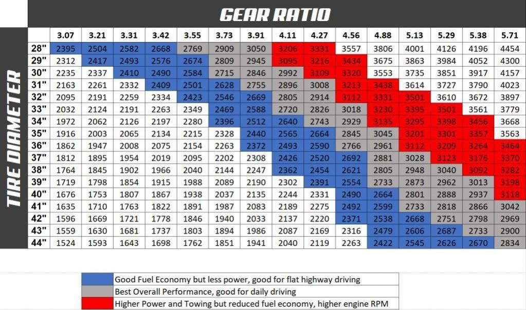

People love charts....
Chart is based on a drive gear of 1:1 at 65 MPH using a manual transmission.
Automatic transmissions will run a slightly higher RPM do to slippage.
Auto 1:1 is 3rd gear/OD off. Chart is what I used for my choice.
My 01 at 65 is turning 3225 by factory tach which puts it in the 4.88 gears.
Turn on OD rpm's drop in the 27-2800 range avg. 18-19 mpg on Hwy most times.
It a sweet spot for me Lockers add extra oomph when I need it.
