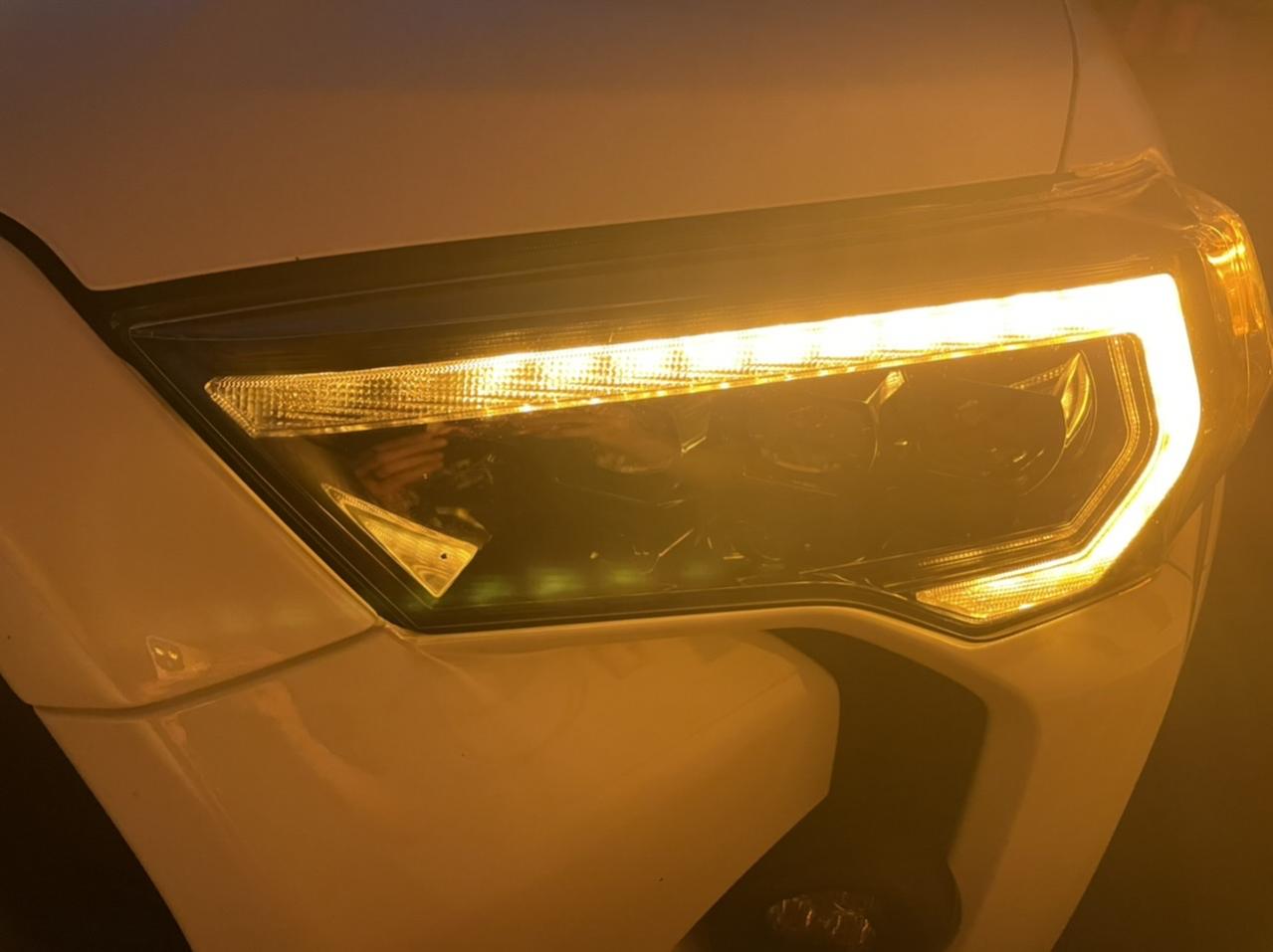

Adding to the gen 2 failures. 1 month and drl LEDs are going out which I believe may be causing a random hyper flash issue while signaling.
Makes no sense, TBH. Did you not order the add-on to counter hyperflashing issues at time of ordering headlights? Did you do the install yourself or have someone else do the install?
It’s simple plug and play no add on needed. It’s a bad headlight with bad LEDs. I just hope this is a one time thing and it doesn’t happen with my replacement.
