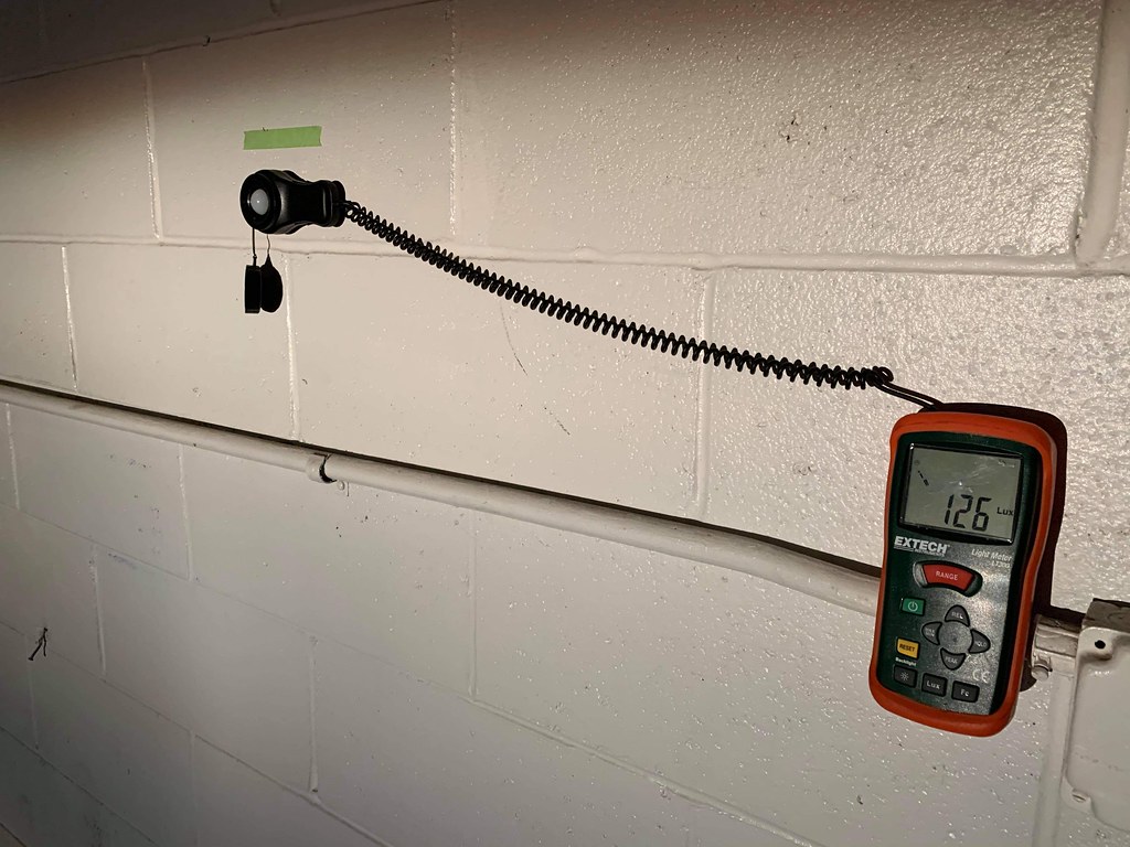

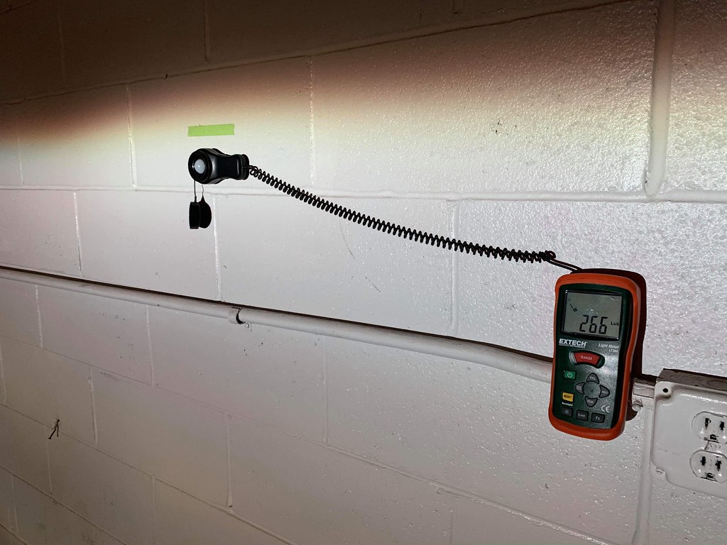

Lightwerkz did a test on the old housings + my bulbs and got a reading of 92 lux. Putting my bulbs into a brand new oem toyota 4runner housing netted 156 with the same bulb. 70% increase! This confirmed my suspicions and since I needed to get new headlights anyways I got the GEN 2 morimoto lights.

Food for thought:
OEM NEW headlights with halogen bulb: 126 lux
OEM New headlights with 35w hid bulb: 266 lux (more than 2x brighter than
oem stock)
XB Gen 2 headlights: 440 lux (3.5X brighter than oem stock)

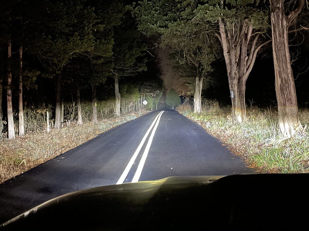

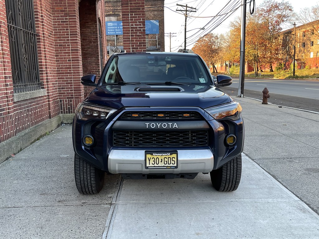

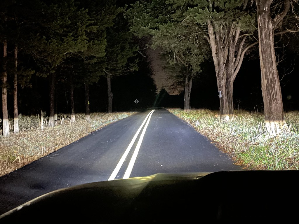

I have attached some pictures and a link Lightwerkz made to showcase the lights.
Lights on
The output is excellent as seen in the pictures.
Low Beams only
High Beams
Low Beams + Diode Dynamics SS3 Pro Fog lights in yellow

Great post! Pictures with the trees in the background helps a lot to give people an idea of how it looks in reality. Watched the video you linked and do wish your shop covered the turn signals to see how it looked when activated. I believe there's two options for the turn signals if I'm not mistaken? First one is straight up blinking while the second option is to have a sequential-style blinking. Which one did you go with?

I have nothing to add to your post here but I just wanted to give you compliments on the Voodoo avatar you have there - the G2 headlights look amazing with Voodoo paint. Rest assured if I saw you on the road, I'd be flailing with my arm out the window giving you thumbs up as a nod that I dig your 4Runner!!

Thanks for adding those awesome comparison pictures. How do you like the beam pattern cutoffs for the G2 lowbeams vs the HID setup?
Was just thinking "wow those lights and the darker housing looks hot on a black rig" right before I saw this post in the thread. :)
It was actually my pictures. The light is so much more focused and Intensity was great. Worth the upgrade for the people that care about lighting.
