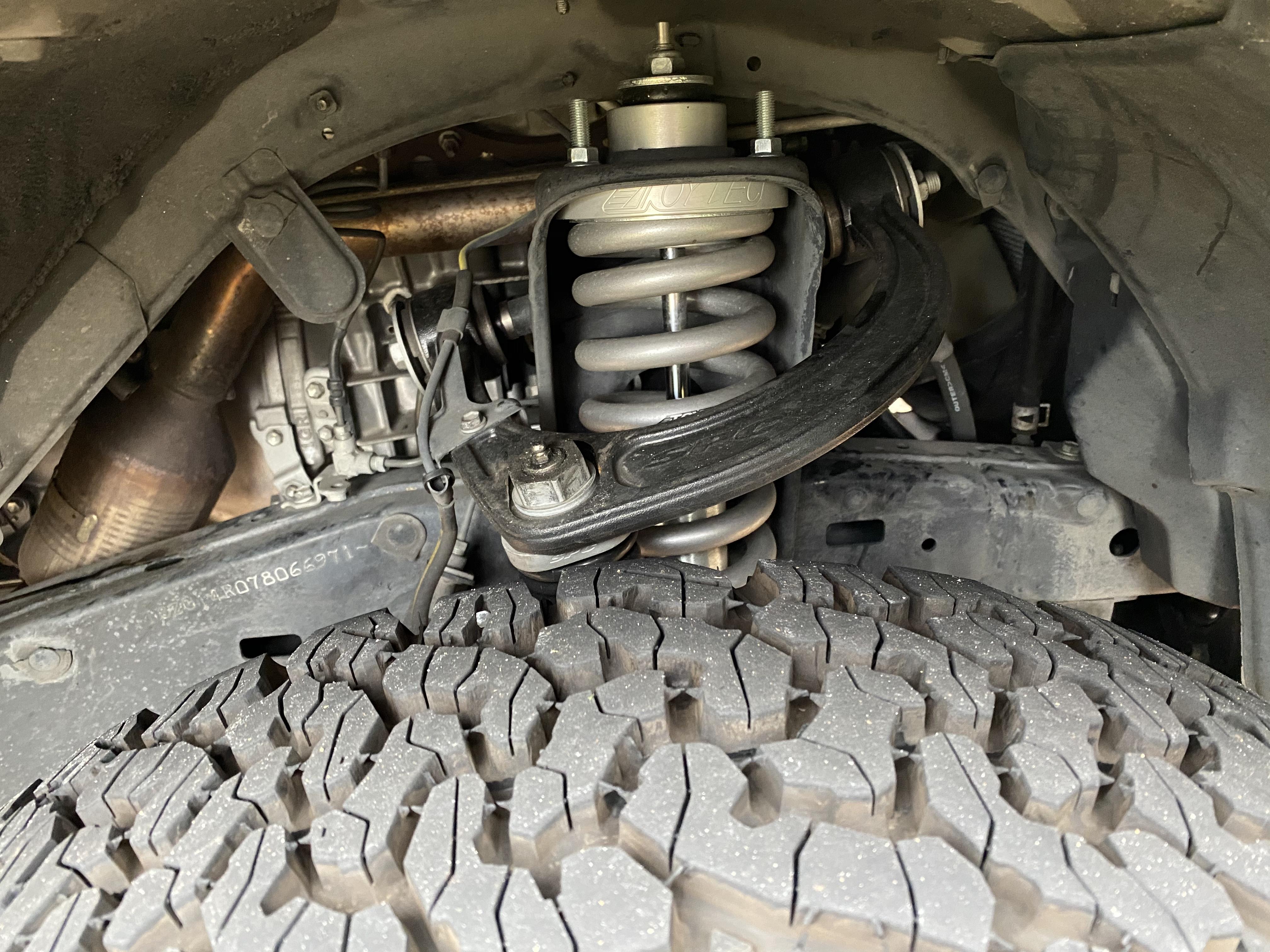

I'm about to pull the trigger on SPC UCAs and a Dobinson's lift. When I do, I'm going to need to get an alignment after I install myself. What have people found to be the best option for getting the SPC UCAs aligned? I can try and find an off road oriented alignment shop, and make sure they know how to deal with SPC UCAs, or I can get a lifetime alignment from Firestone, do the SPC rough aligning myself, and then have them do the rest. Any opinions?

Set LCA cams for max caster (front cams facing each other, rear cams turned all the way out) Set SPC balljoint at slot "D" with camber slider all the way out (what SPC recommends). Take to shop and let them fine tune ONLY THE CAMBER VIA THE SPC BALLJOINT, and the toe via the tie rods! Tell them LCA is off limits! If you do this, it will retain great road manners and pushes the tire forward in the wheel well to help clear the body mount etc. Just set my buddy like this recently and its perfect!
Interesting. Will have to see if I can find a shop that will work with me to that degree. That's exactly what I'm looking for. I need to clear the Body mount as much as possible.

Also Titanium is right. The tire needs to be pushed forward with the upper arm only. Mine was +3.0 on each side and is no where near the body mount with a 285/70/17 and 17x9 -12mm wheel. Only slight trimming in the front needed.

Slight misunderstanding, the way I described would be using the LCA to move the tire forward. The SPC UCA would be used to adjust for camber so that the LCA can be used for caster. If you try to max caster via the UCA it ends up pushing the wheel further back into the rear of the wheel well. Positive caster adjustments made at the LCA allow the wheel to go forward whereas positive caster adjustments made at the UCA cause the wheel to go back further into the rear of the wheel well. It’s interesting how that measurement is an inverse reaction depending on where the adjustments are made.
