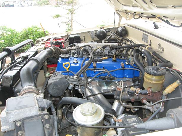

DOA means DOA Racing. They make cams and higher horsepower 22RE engines. Like the one in the photo that's in my 4Runner.
Check out LCEngineering, Engnbldr.com, and DOA Racing. They all have websites and lots of performance mods for 22RE engines.
Still not sure if you'll be able to pass people! :D
