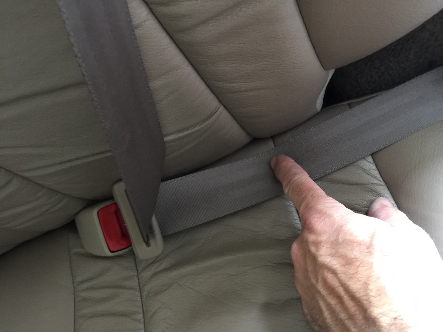

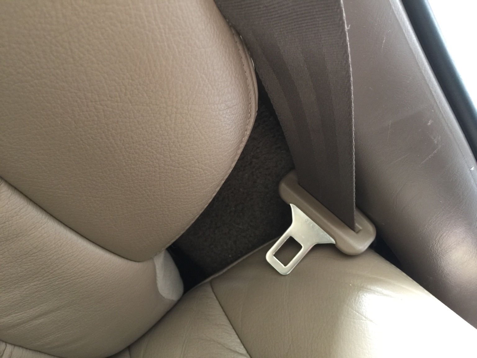

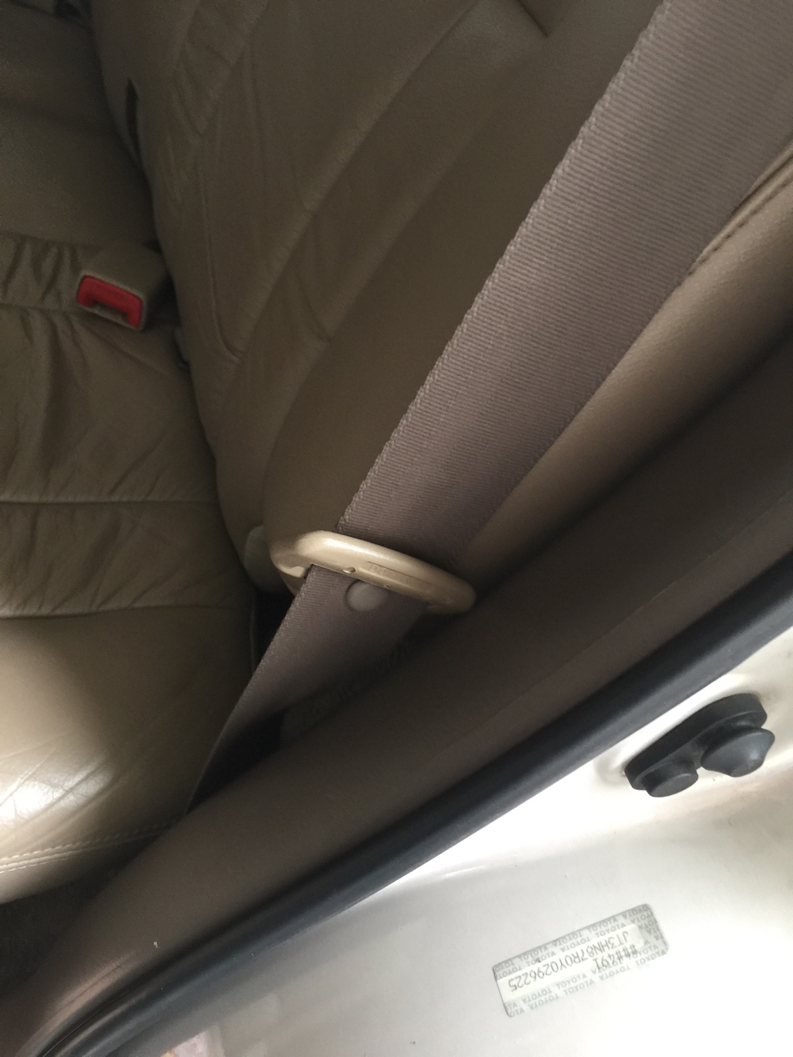

Hit up PnP to see if I could find those little buttons that stop the seat belt buckle from sliding down into the closing door.
I hate this about the rear seat belts.

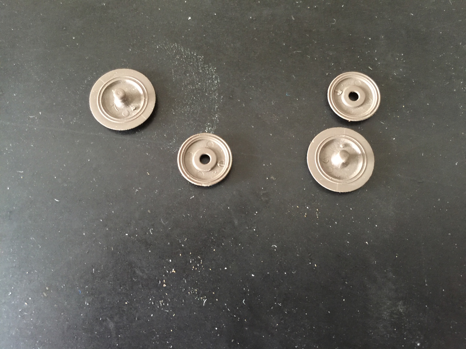

Found in late 90's Camry. Driver and front passenger seat belts.
Buckled the belts and picked a spot easily repeatable on the other side. Used a drywall screw to part the stands of the belt. DO NOT CUT A HOLE!
Why Toyota didn't do this OEM, IDK!

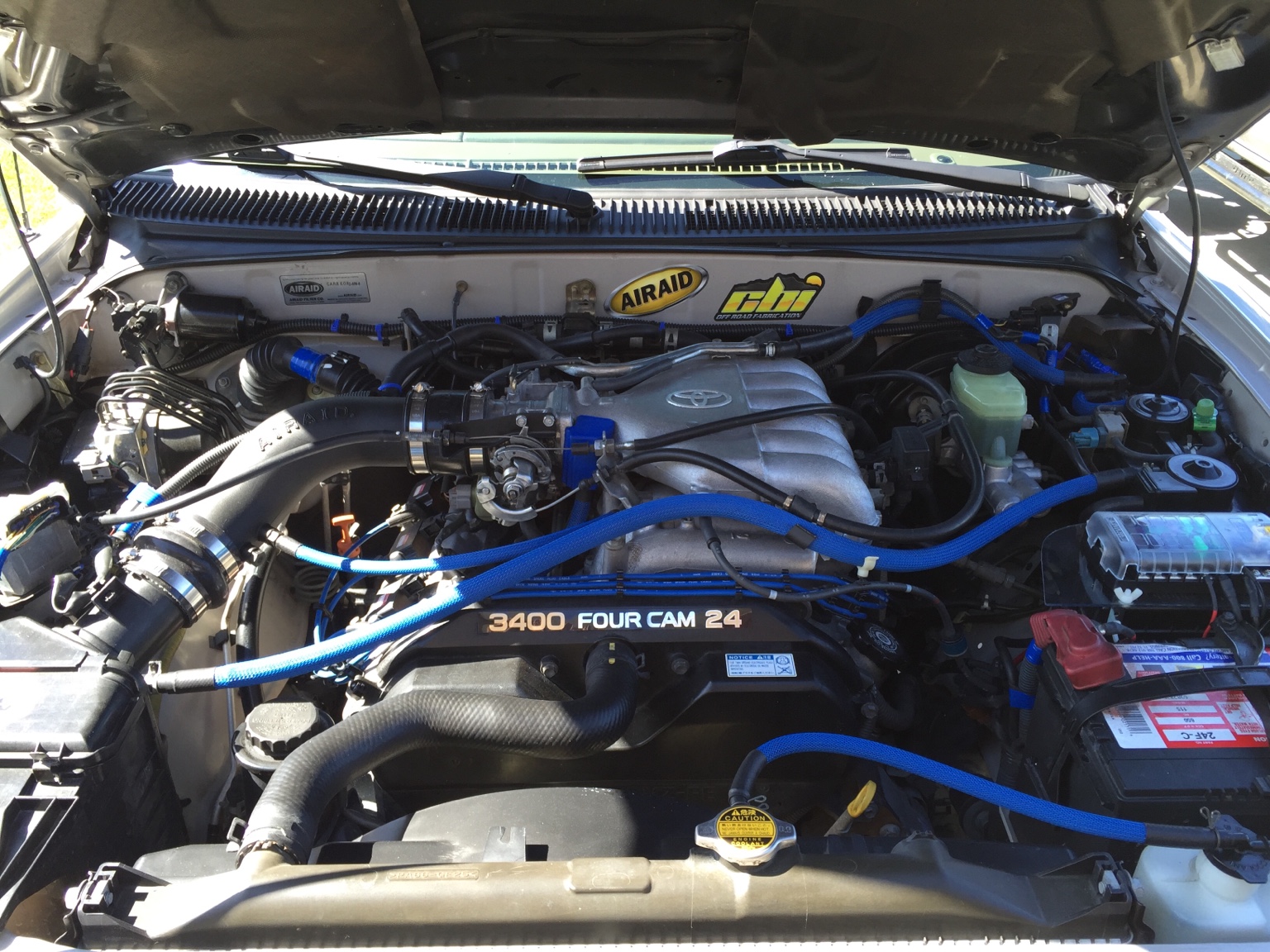

Classin' up the runner with some LV...
More blue...

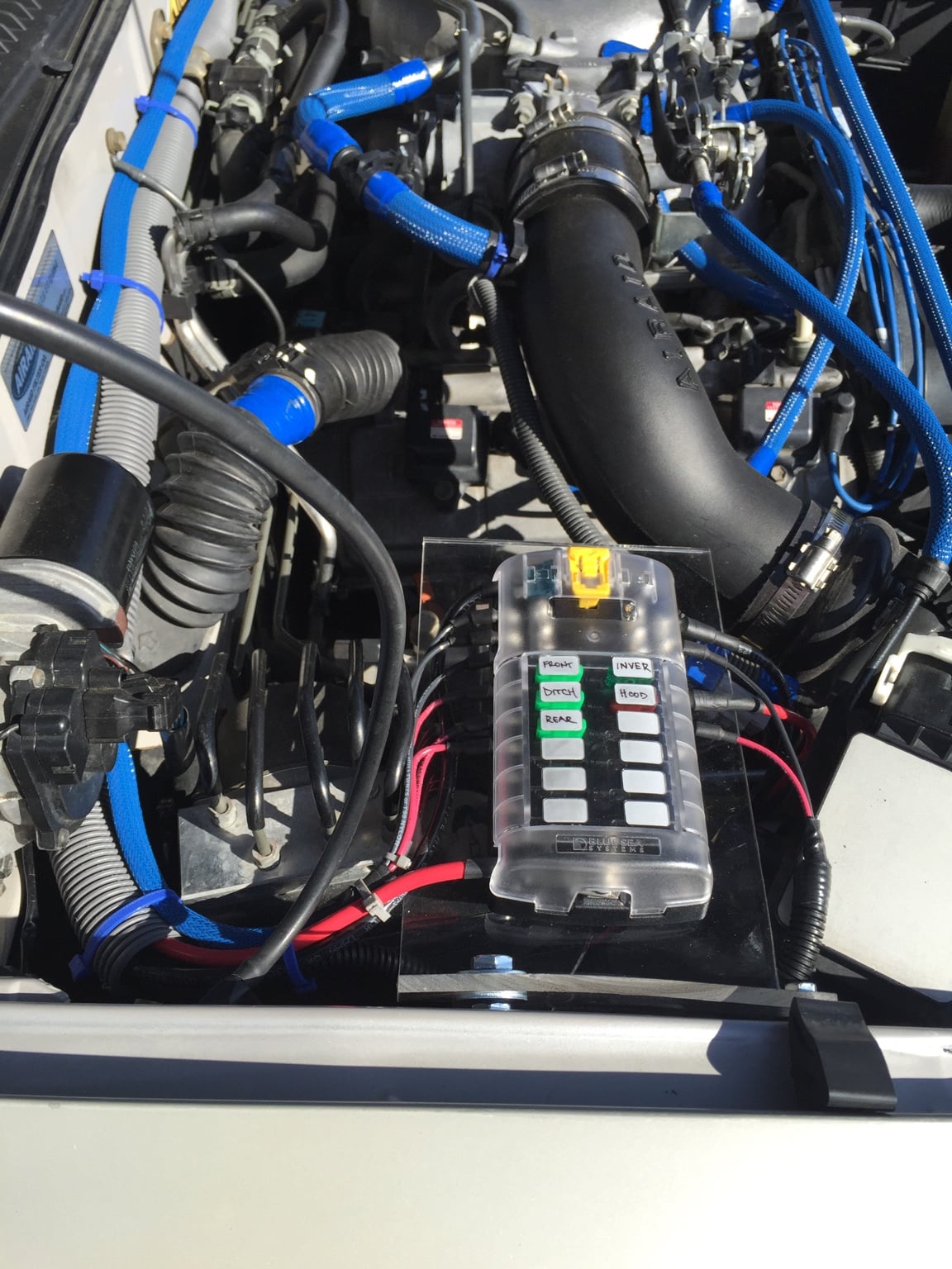

and a 12 slot fuse block.

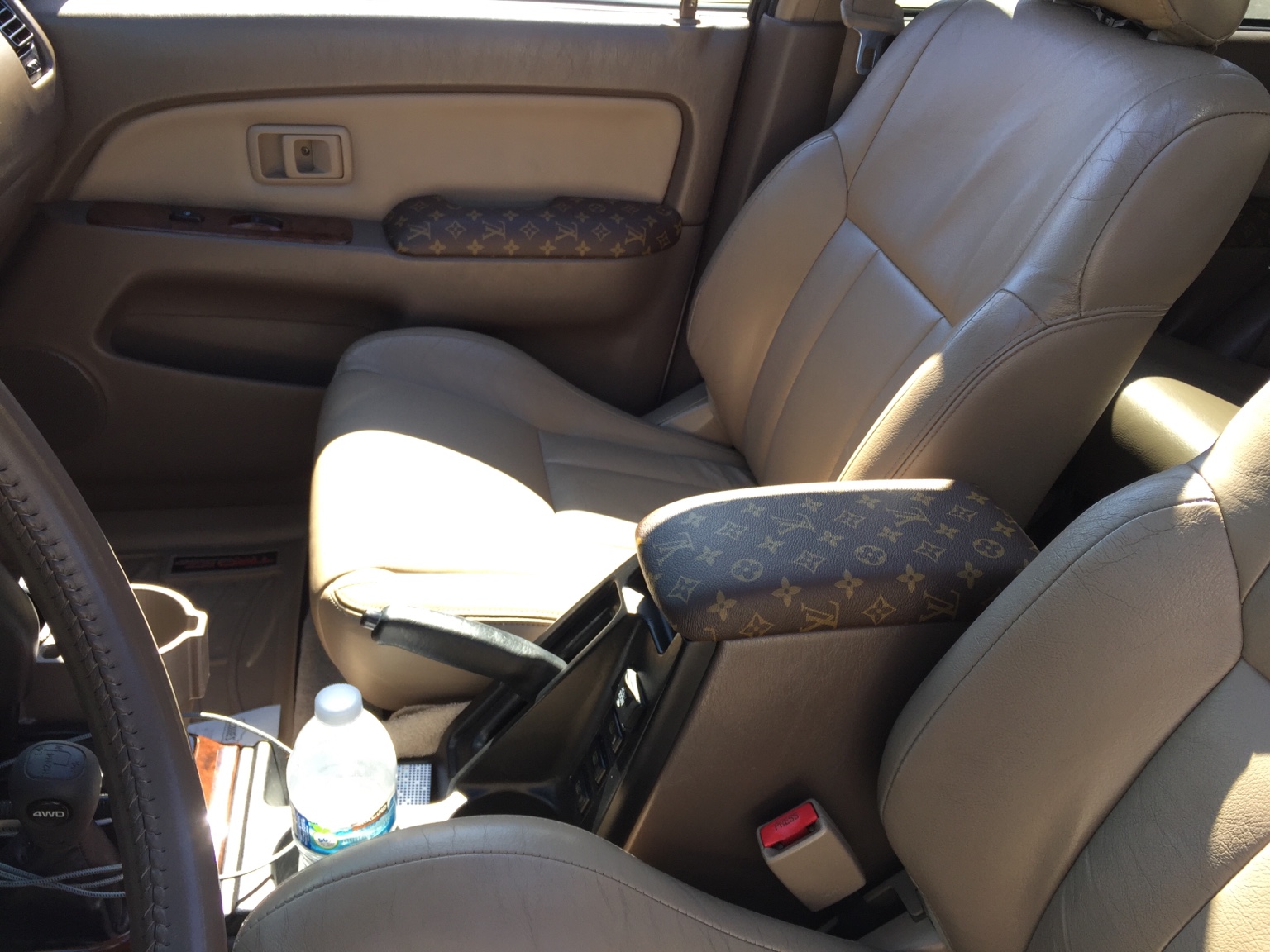

The center console was a chore but I didn't want wires running all over with the kids want there stuff charging.
Pulled the ashtray. The bezel has tabs to bend up so you can remove the back piece. Trimmed the bezel with tinsnips so I could reuse it.
I had some scrap oak panel I cut to size, drilled 1" holes and plugged in the OEM 12v adapters. Ran power from the ones up front. It'll take some finagling to get the cup holder to work.
Some superglue and your good to go.

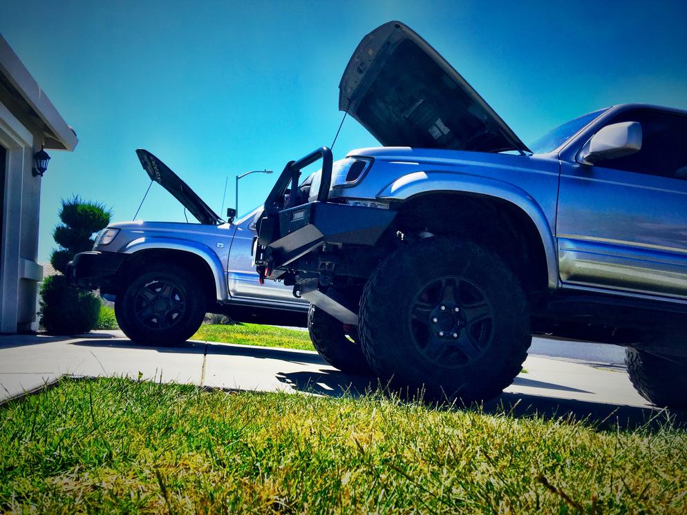

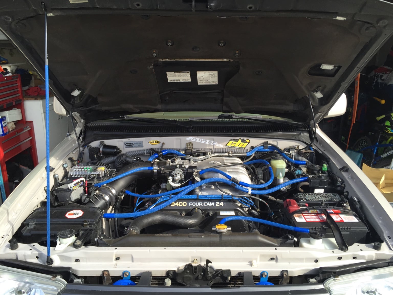

Pretty mellow little mod day today with the GG
Remember, you're not truly "modding" unless you have the hood up

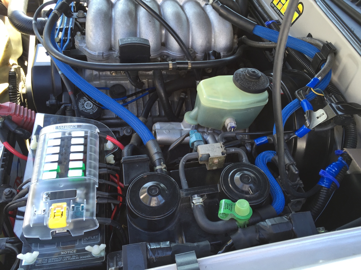

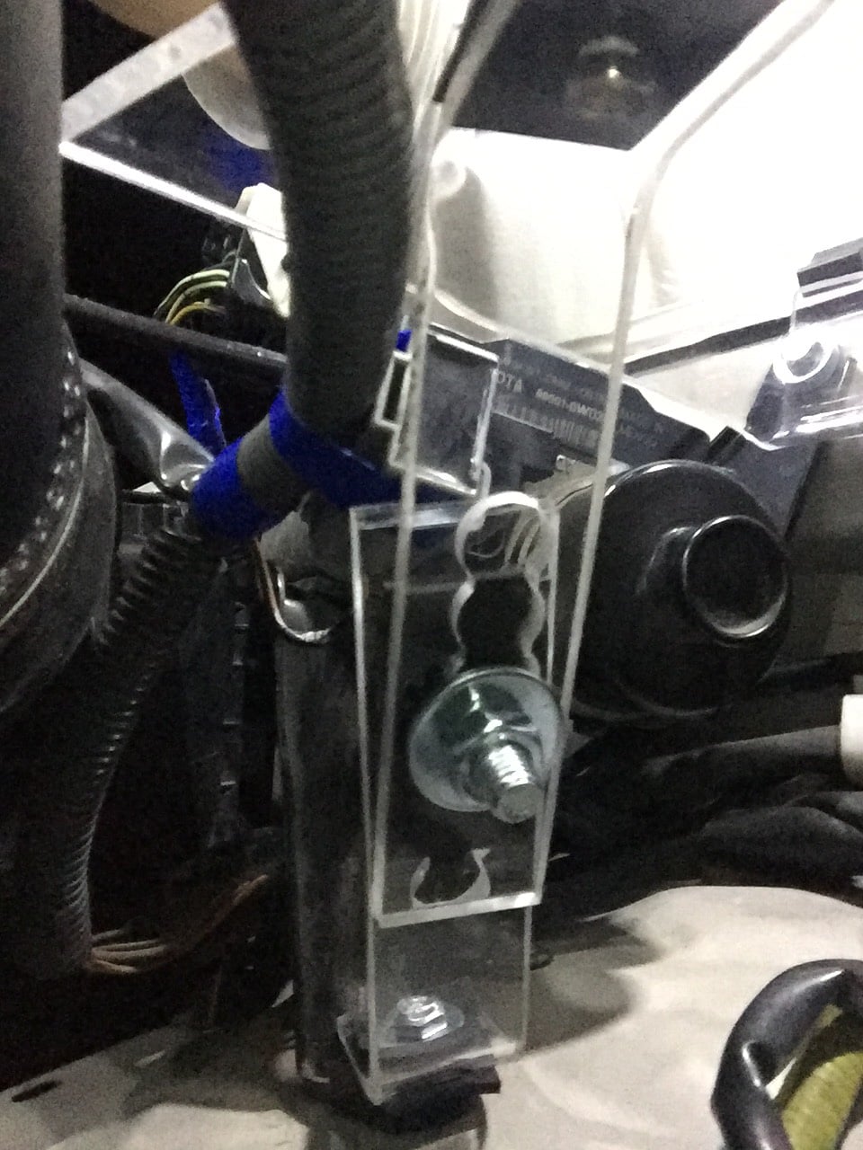

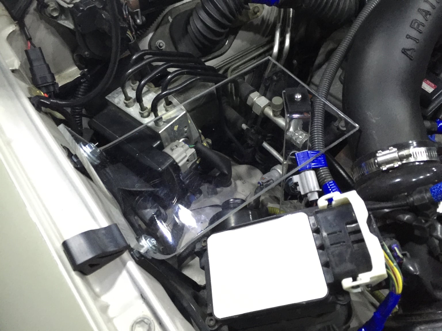

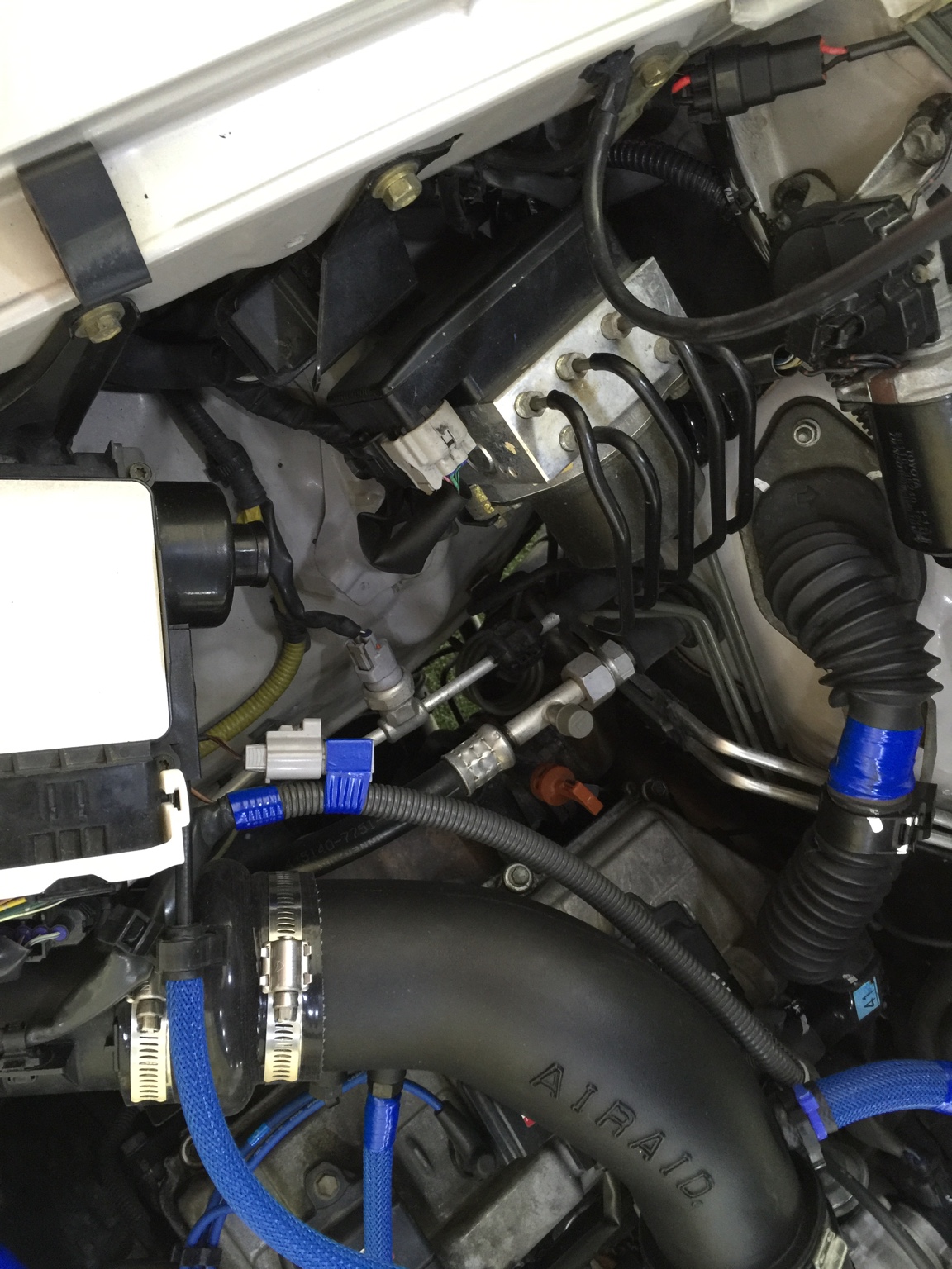

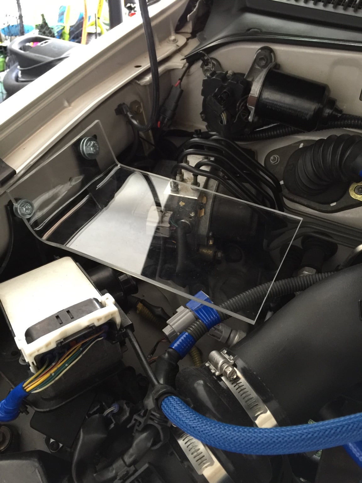

Bluesea fuse block relo...
Moving it to here from on top of the ORM fuse box.

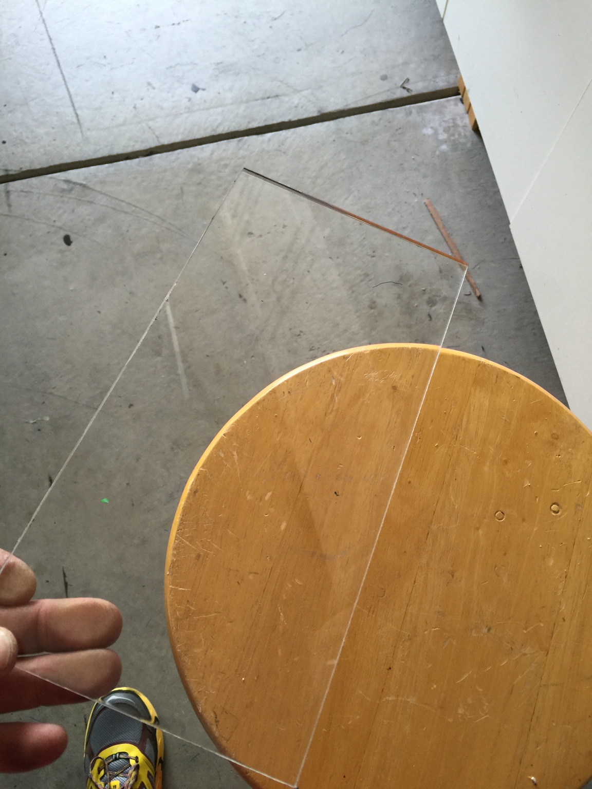

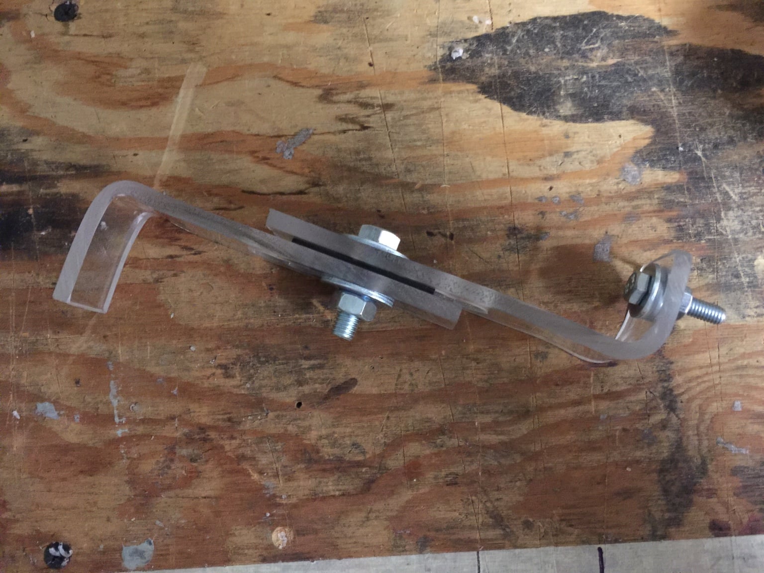

1/4" acrylic heated and shaped with a heat gun.
Made my bracket.
Long night but it's done.
