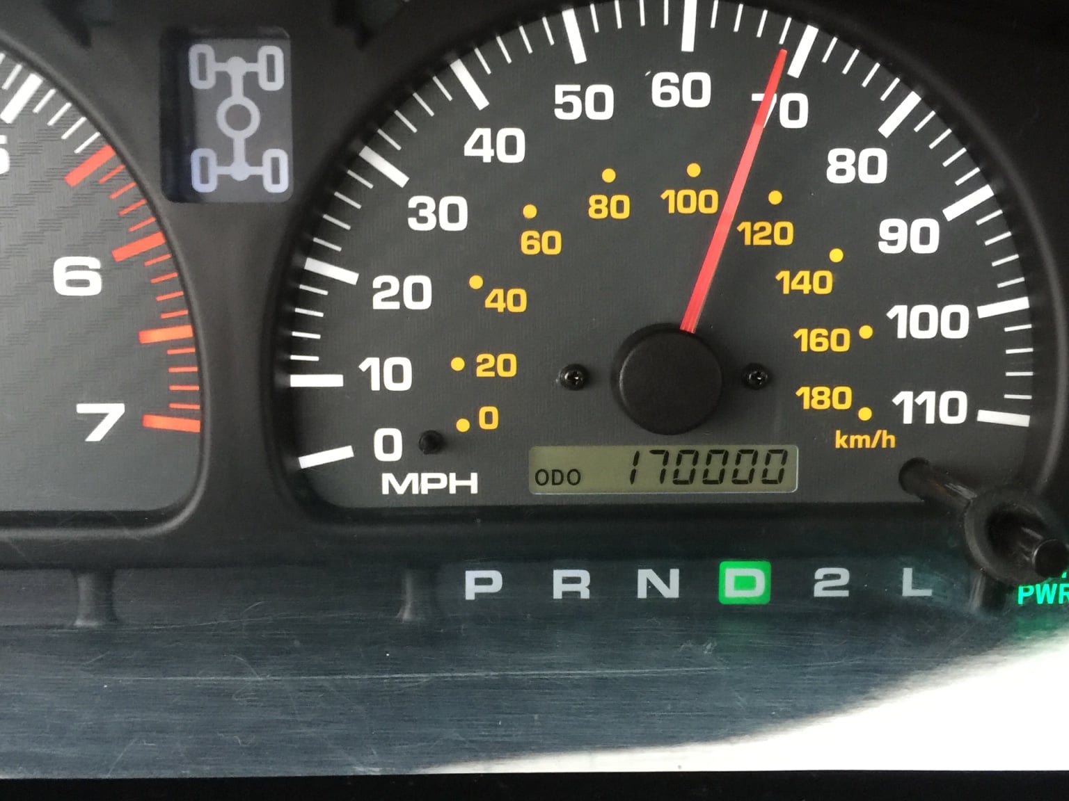

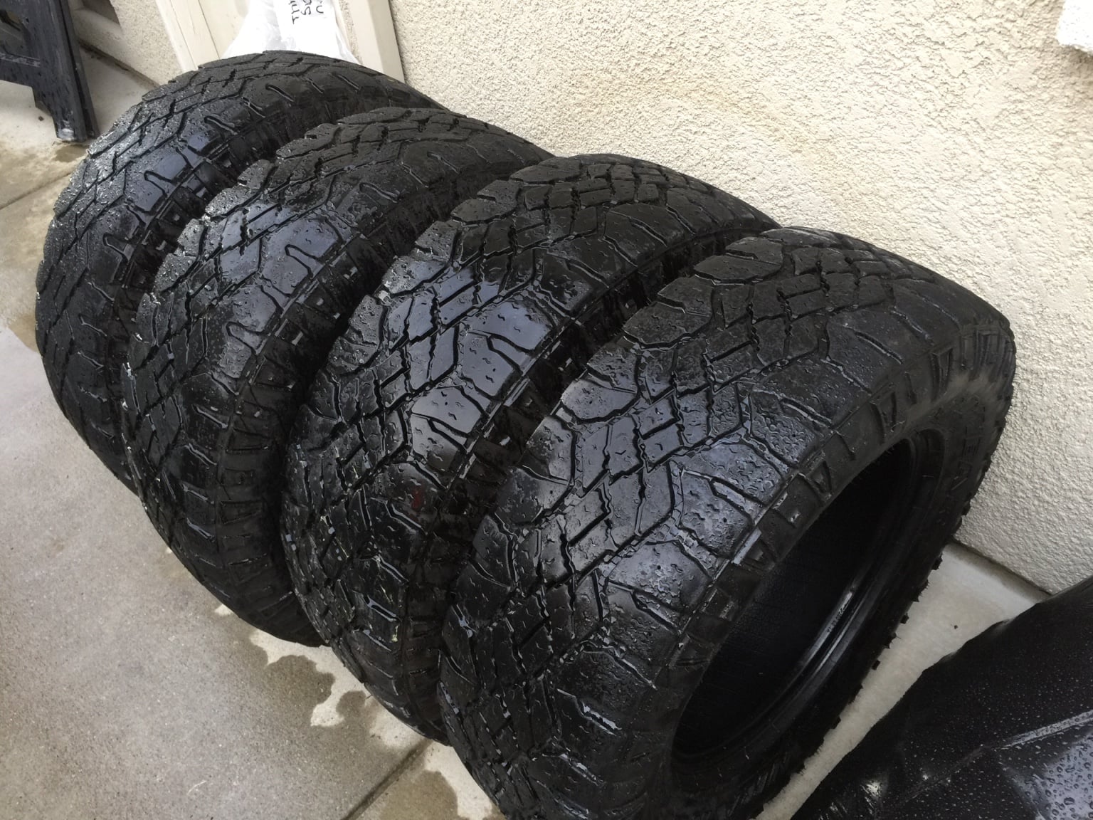

Picked up some used 265/70 17 Duratrac's to get my lifted stance right and turned 170k...
They grow up so fast.

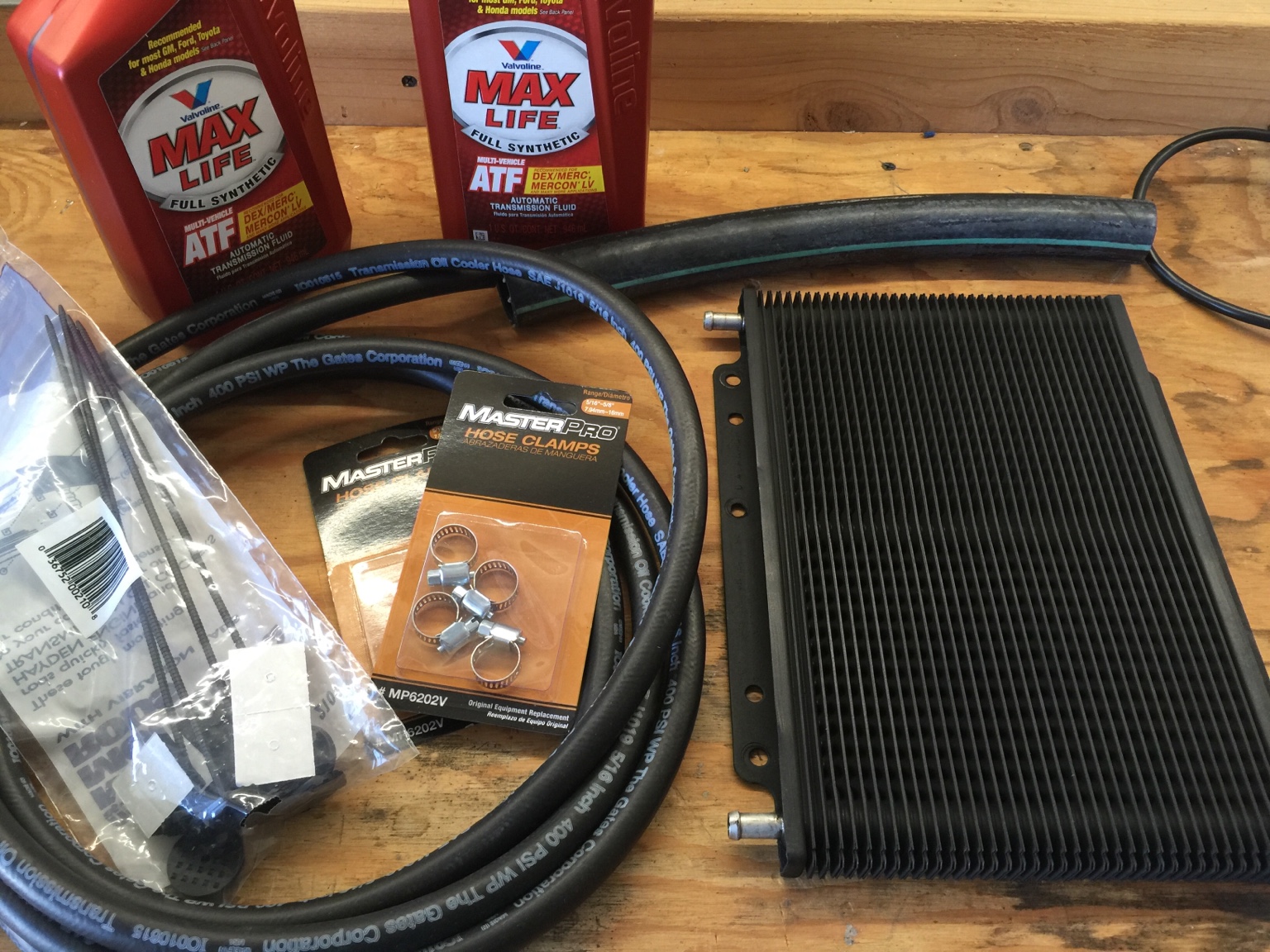

More lift parts ordered. Getting ready to do the trans cooler mod.
Which cooler did you go with? I'm planning on adding 1 when I do my timing belt. There's a small one that has a built in fan that I was looking at but without a supercharger and with me not towing very often I think it's overkill. Probably going to go with b&m 70264.
Sent from my SM-N910V using Tapatalk

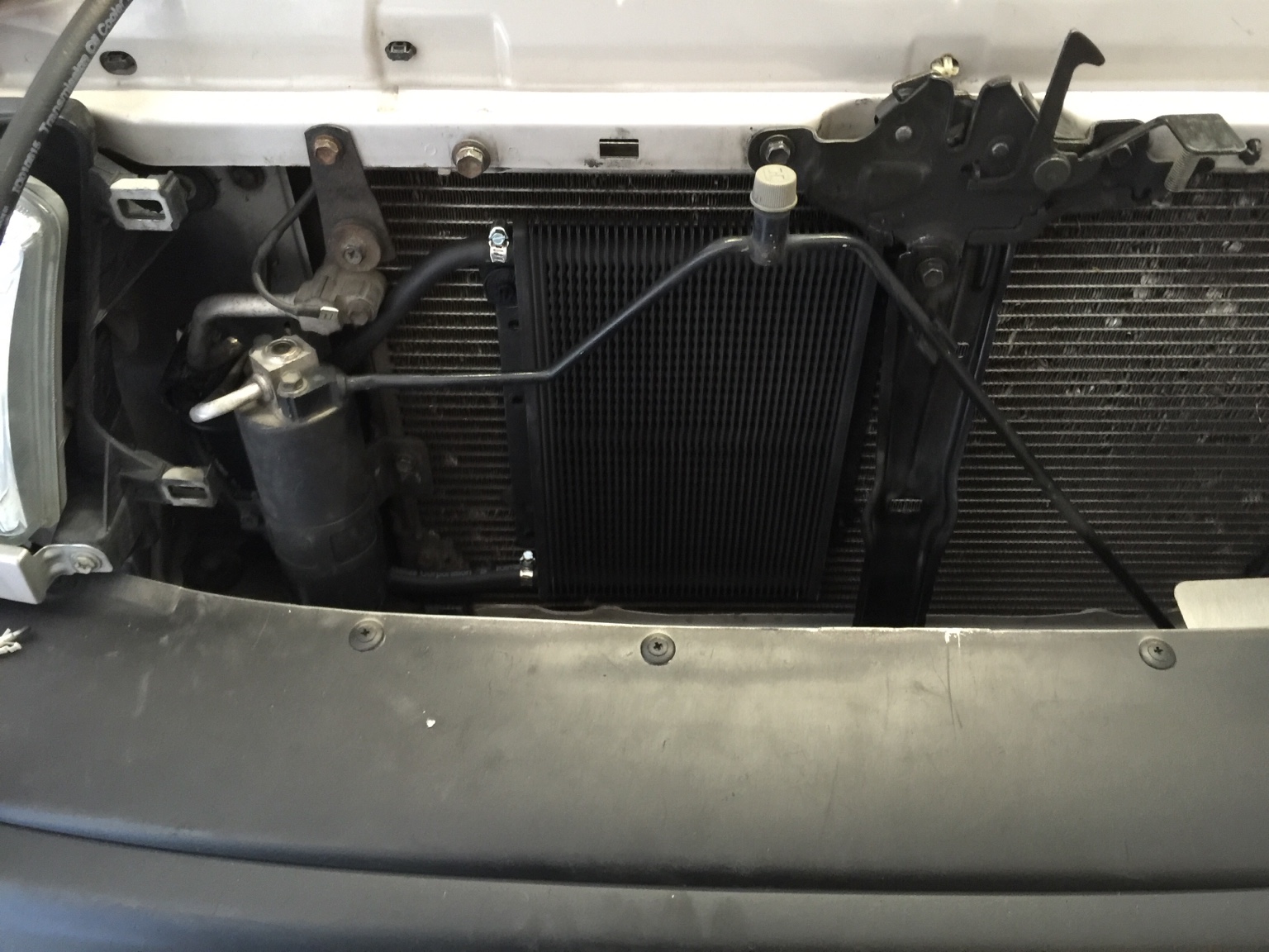

It's out of a 2500 Suburban. Same markings as the smaller B&M everyone goes with.
Trans cooler complete. Looks like it running 20°-30° cooler than before.
Pro tip... Make sure they give you 3/8" hose not 5/16" before you start.

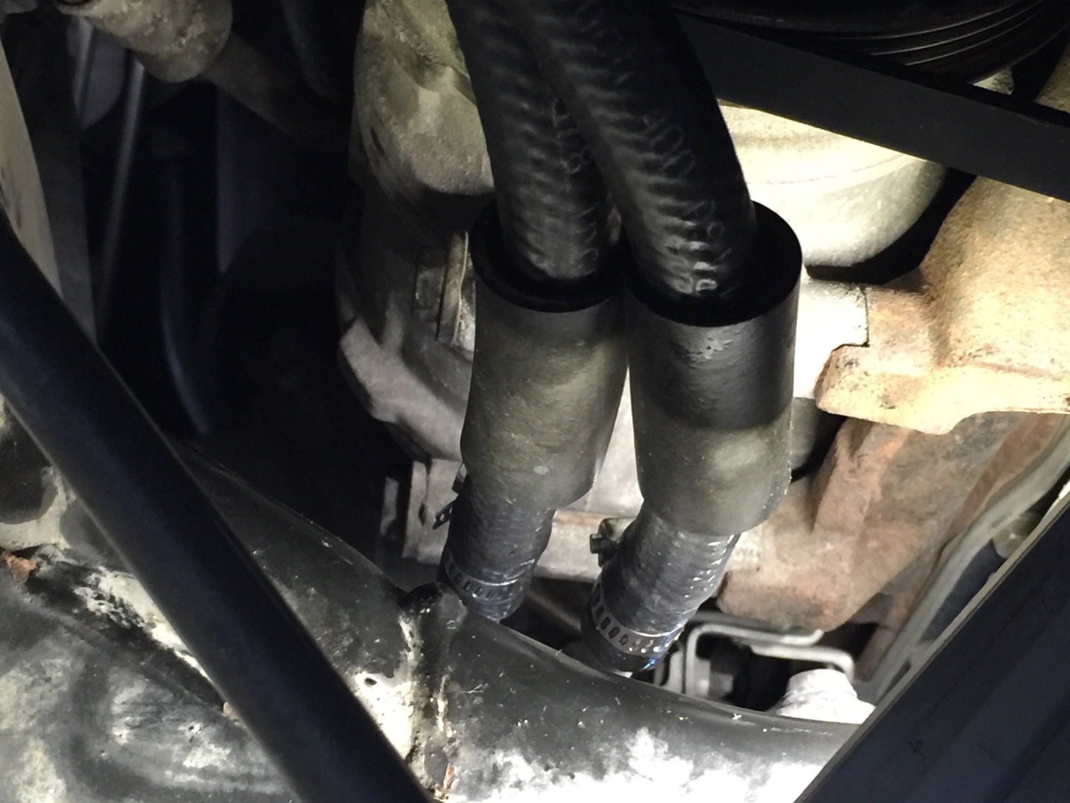

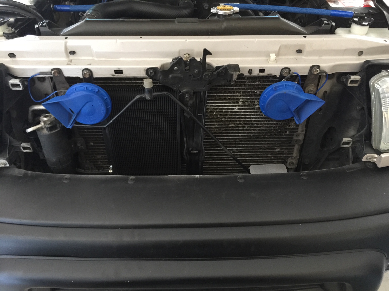

Pulled the grill, horns and decided on placement. Disconnected the a/c condenser and installed trans cooler. I mounted it with the ports on the side to allow gravity to aid the fluid passing through the cooler.
Ran hoses through a hole on the radiator support and used 3/4" heater hose to protect the hoses. It'll be a tight fit so use some rubbing alcohol to help it slide.
Getting to the hose claps is a ***** if you've got big hand... Thankfully my kid got home from school.
Defiantly happy with the resulting trans temp.

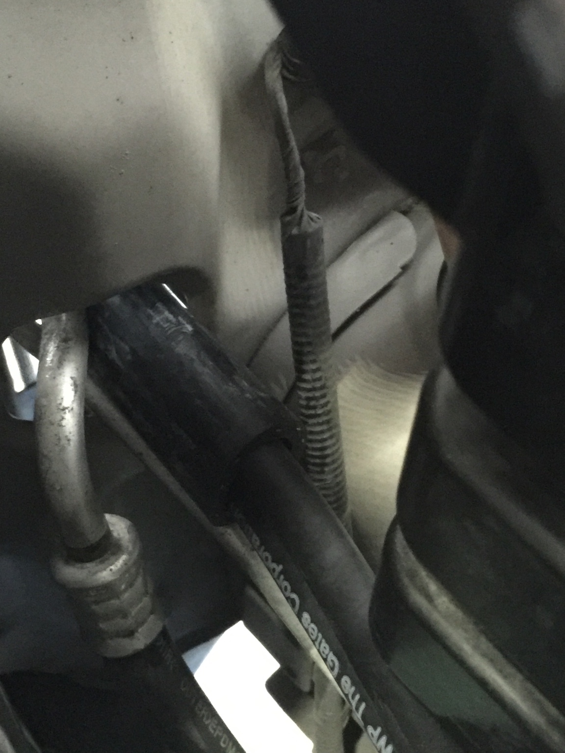

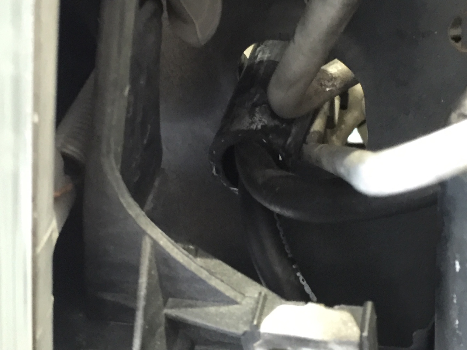

I highly recommend junking those clamps and getting marine style hose clamps, which will not cut into the hose like the cheap ones are doing. Learn from my mistake on this one.
I'll take a look at those. Gotta be honest I'm not real motivated to pull apart everything I just did.

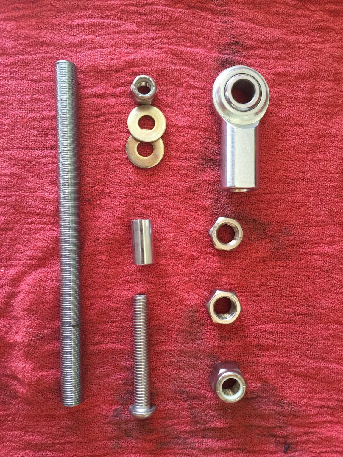

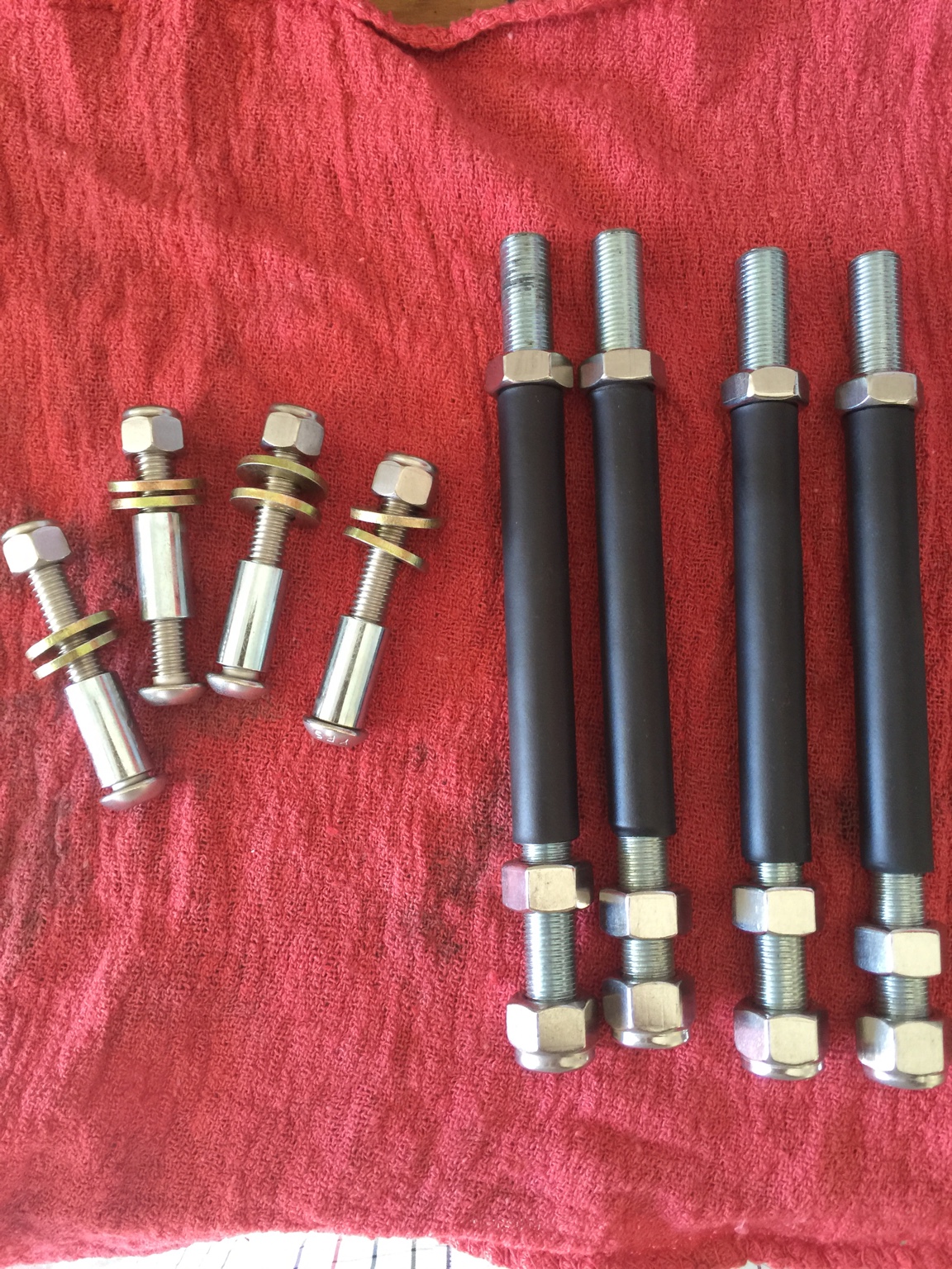

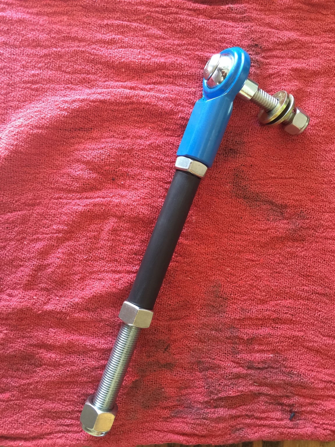

Decided I'd DIY my links instead of paying someone else to.
Parts needed
4-1/2"x20 heim
4-1/2"x20 threaded rod cut to 9" (will size to lift
4-1/2"x20 stainless nylock
4-1/2"x20 stainless jam
4-1/2"x20 stainless double
4-1/2" OD steel sleeve
4-3/8"x24x3" button top stainless
4-3/8"x 24 stainless nylock nut
8-3/8 grade 8 washers
2-bushing sets from Wheeler's
The black is just 3/4" heat shrink to cover the exposed threads.
Had to add my touch of blue... Think I may be taking it too far. Haha

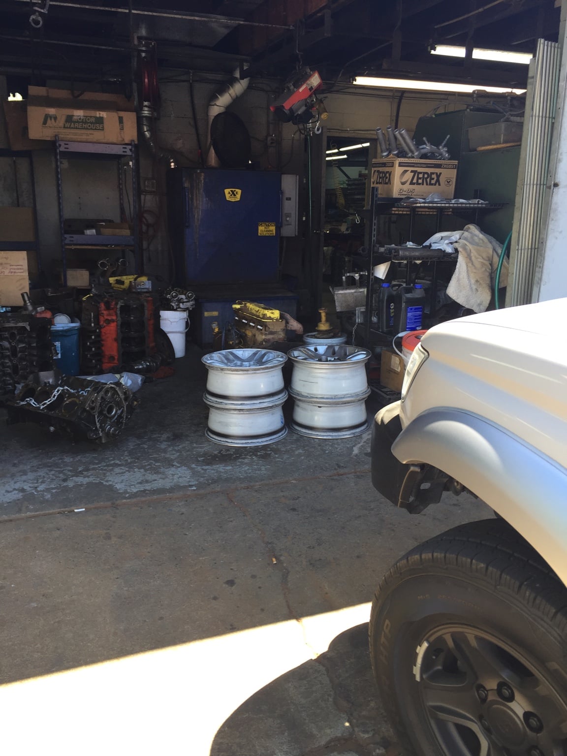

Just dropped my Sequoia/tundra wheels off for media blasting. Should be done sometime tomorrow.

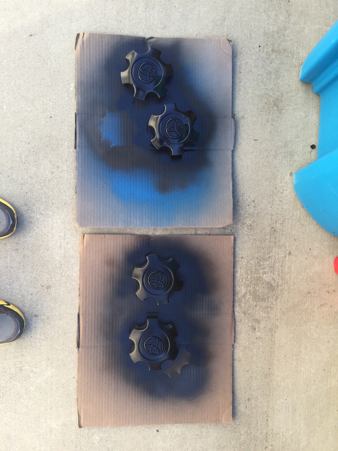

Some finish testing on the center caps
Semi gloss (top) v matte (bottom)
