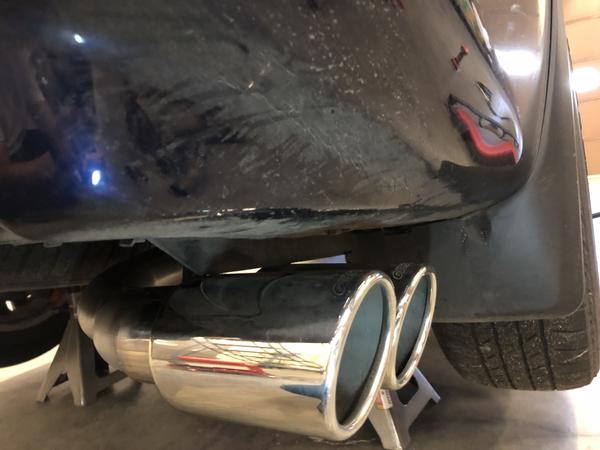

5 weeks later, mine has finally arrived. I plan on doing some measuring tomorrow at work to see if I can fit it on my LE with longer rubber hangers or if I will need to have some welding done.

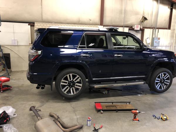

Removal of the old exhaust was a bit more challenging than I expected. I was hoping not to have to cut, but the bolts between the tailpipe and muffler were so densely rusted I had no choice. I borrowed a tailpipe cutter from Autozone, but I couldn't get all the way through, so had to sawzall the rest of the way. The forward two bolts were not rusted but were very difficult to get loose. Removal took me 2-3 hours with all my snags and getting a faceful of rust and metal shavings.

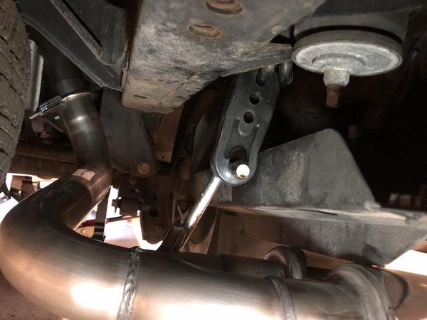

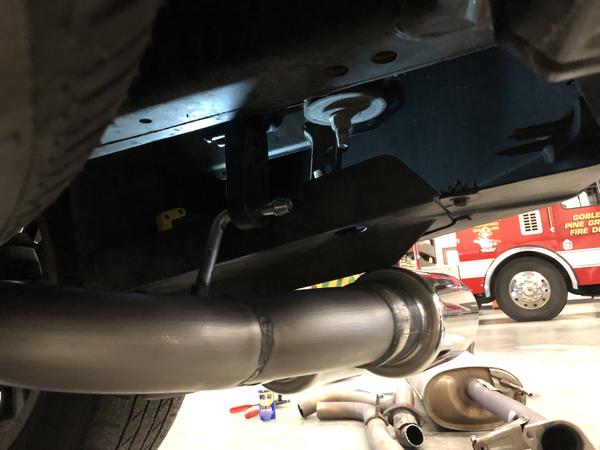

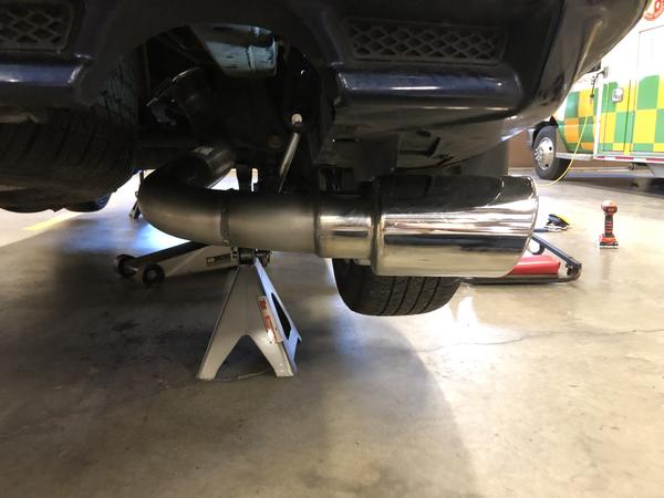

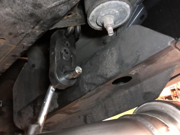

After removal, things went much smoother. Installation was a snap and took less than an hour. Since I have a Limited, I replaced the rearmost hanger bushing with a longer one from ebay but it is still a bit too short. I may have to trim a little plastic or work something else out so the tips hang a little lower.
No review on sound or performance yet, I am still at work until tomorrow morning. Picture below for your education and/or enjoyment.
Thanks for the info on how to get this to fit on the LIMITED MODEL. Good to know just a longer rubber extension will do it.

We tried installing it at home but it wouldn’t fit perfectly. Ended up melting the black rear valence a little bit. No worries though, took it to an exhaust shop and they had to cut and weld it to make it fit right. Should have done that initially.
Any other pics from the rear? My 2010 has the same rear valance and I’m also worried about the look with anything else other than the rear exit exhaust.
