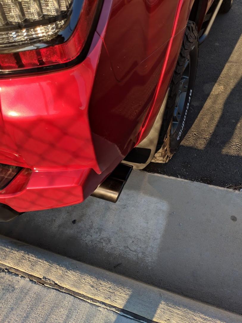

The fit and finish is decent but not as good as the MF. I like the tips but I wish I would've went with the single because the rear tip sticks out farther than the front because it doesn't follow the contours of the bumper since it's designed to fit the Limited as well which has a different bumper profile. Also, the packaging was a disappointment. Everything was just thrown in a big box, which is usually ok but not with powder coated/painted parts. The tips were all scratched up when I took them out of the box. Luckily I had some high heat matte black so not that big of a deal but still.

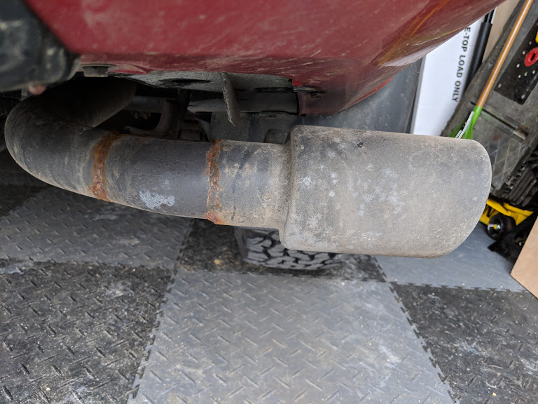

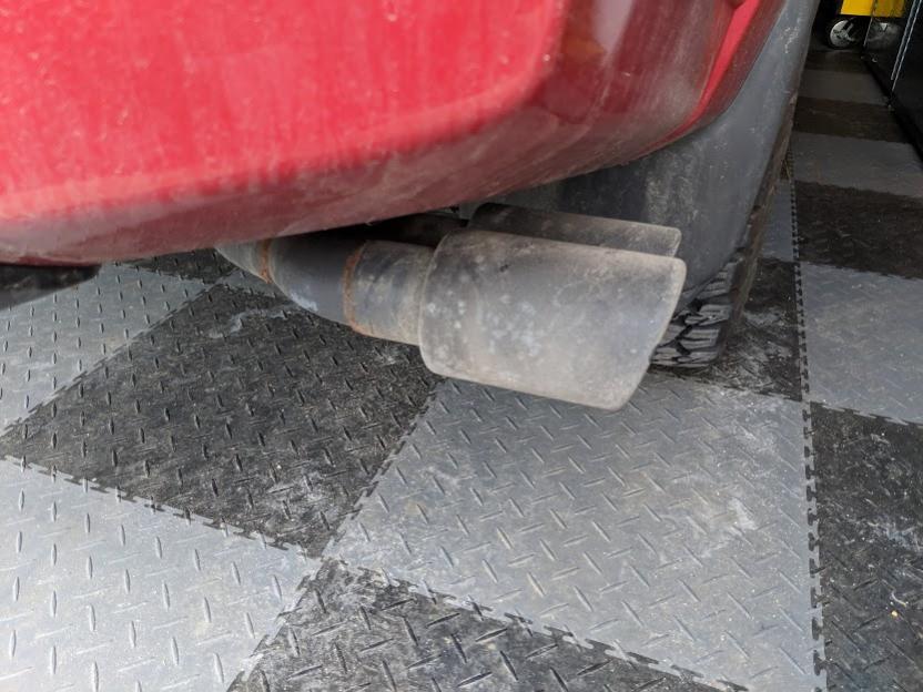

Just yesterday I noticed that all the welds on the tips are all rusted already, that's a huge disappointment, I mean come on I've only had it on here for a couple months. Not sure what I'm going to do about that just yet.

And here are my tips now. Granted they are a little dirty but so far not holding up so well.

The Gibson is 409 stainless, and can discolor and show surface rust, which is common with 409. This stainless system is WARRANTIED FOR LIFE. If you see slight surface rust or discolored surace on piping, it's the carbon in the metal, again which is common, this will never make a whole or wear through, as it's surface. If you are ordering the SS (stainless steel) you are protected for life with the warranty on the SS, which I stand behind. If anyone is looking for something that doesn't discolor, 304 SS would be a better choice, BUT a choice that can sometimes be 3-4 times the cost. There truly is no system that is this inexpensive that sounds this good. A little more here on surface rust.

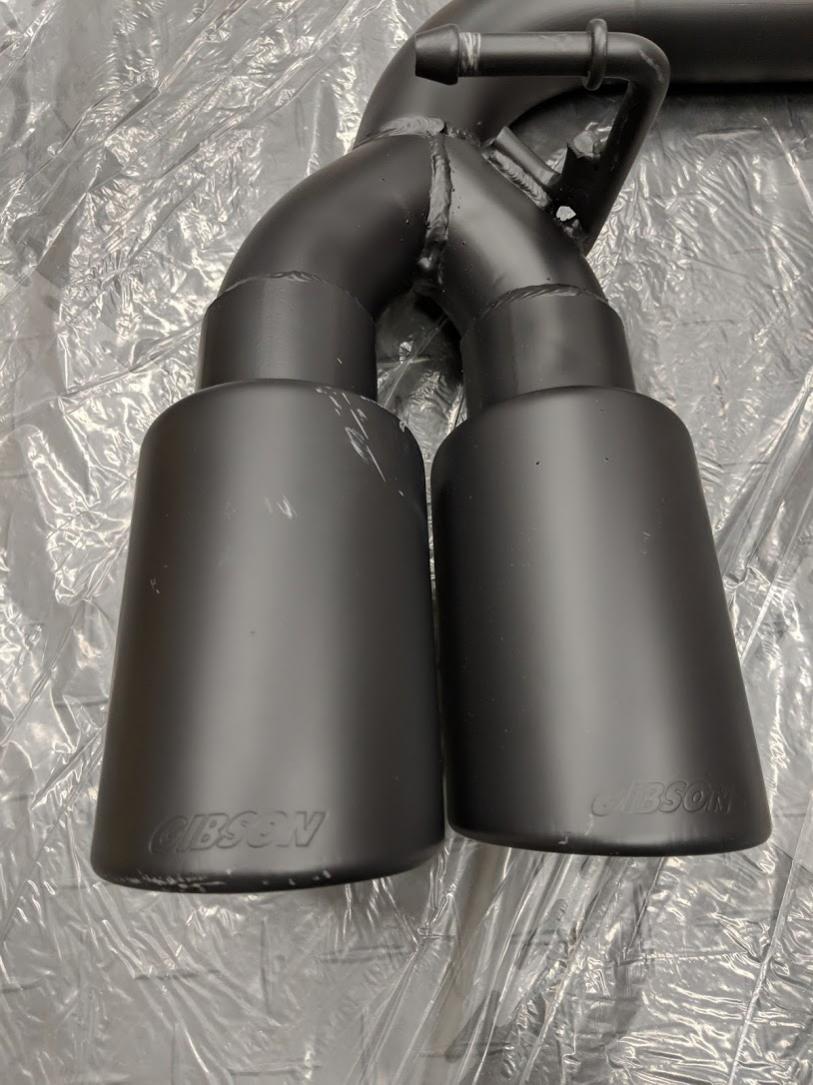

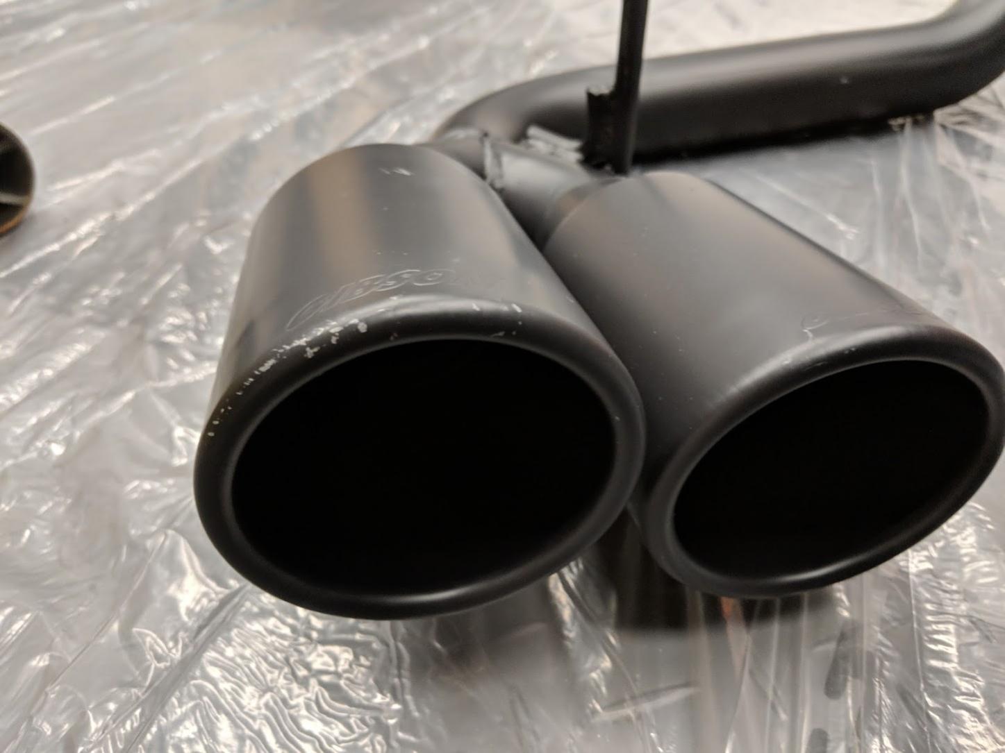

Fit and finish could be better, the black tips are nice, but like was previously stated, they came scratched because of the terrible packing job.
Aside from that, i'm happy with it for the price point. Is it the nicest exhaust i've seen, no, but it was sub 500 for a stainless system with a powdercoated tailpipe/tips.

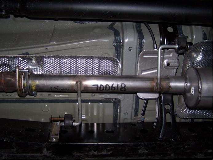

Did everyone reuse the stock exhaust gasket between the Y-Pipe and the aftermarket Gibson headpipe? The instructions did not specify to reuse the stock gasket and it looks "oversized" for the flange on the Gibson headpipe.
Yes the factory metal gasket is to be reused – no concern over size – nothing really has changed at that juncture point with the Gibson Two Bolt Flange it mirrors the factory connection – You will see that the gasket is oversized before you have your install shop or when you do it, start the removal and install and once the Gibson is installed it will look the same as was the factory.
If you look closely enough – in this image you will see the factory metal donut gasket installed on our headpipe 2 bolt flange and larger than our pipe – it’s by design.
