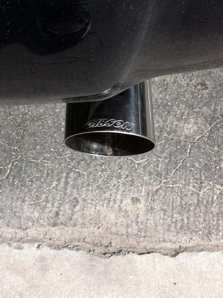

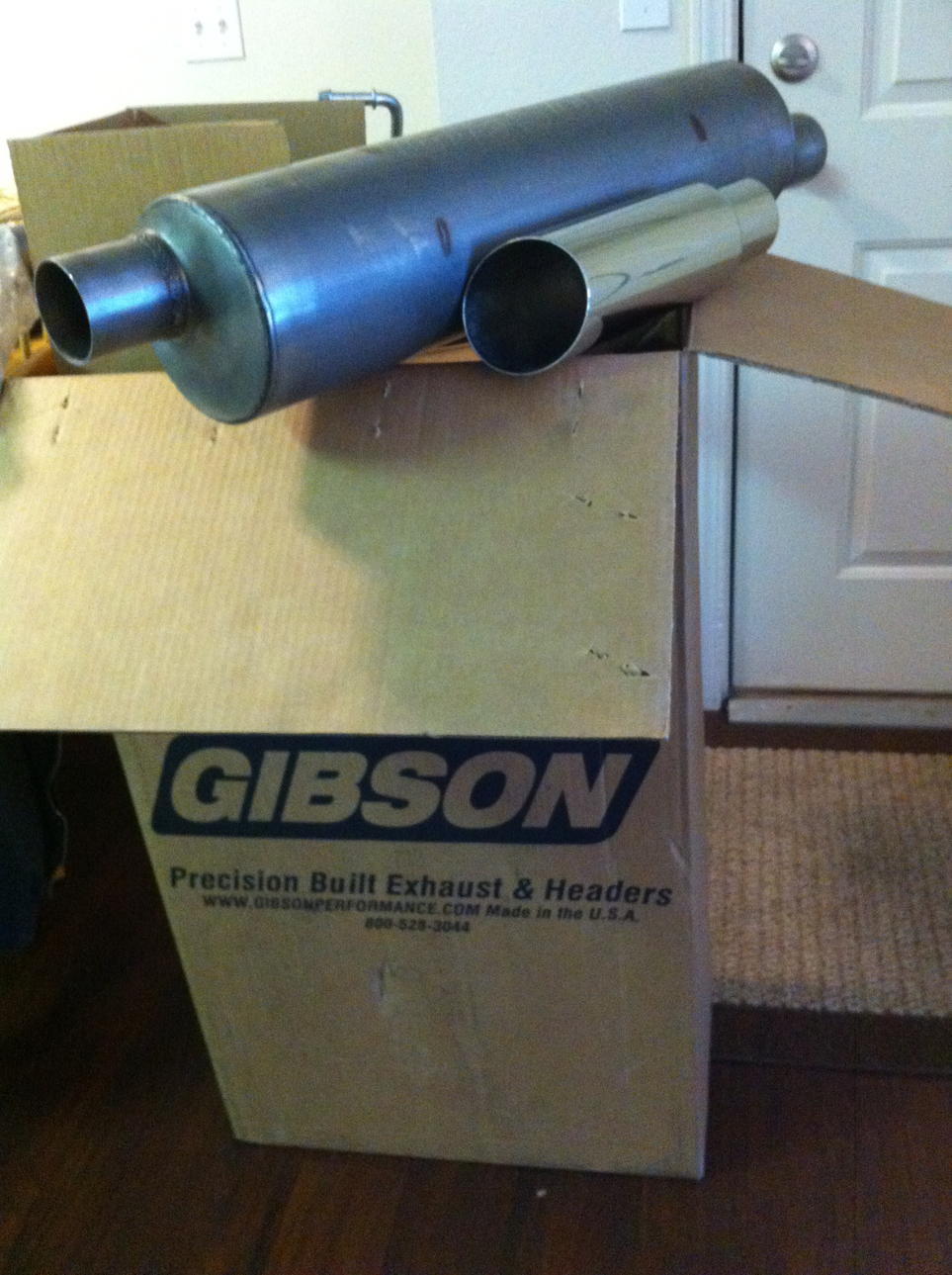

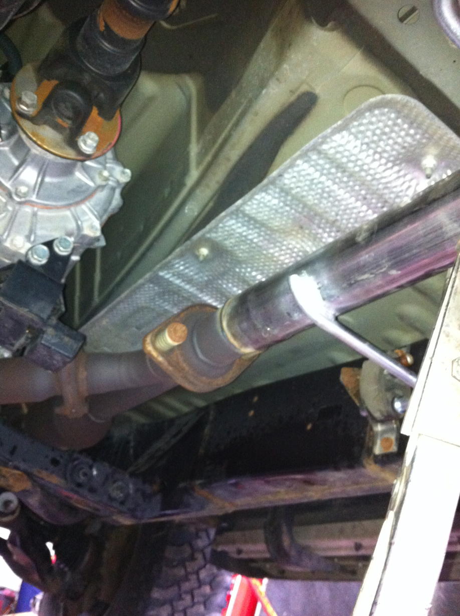

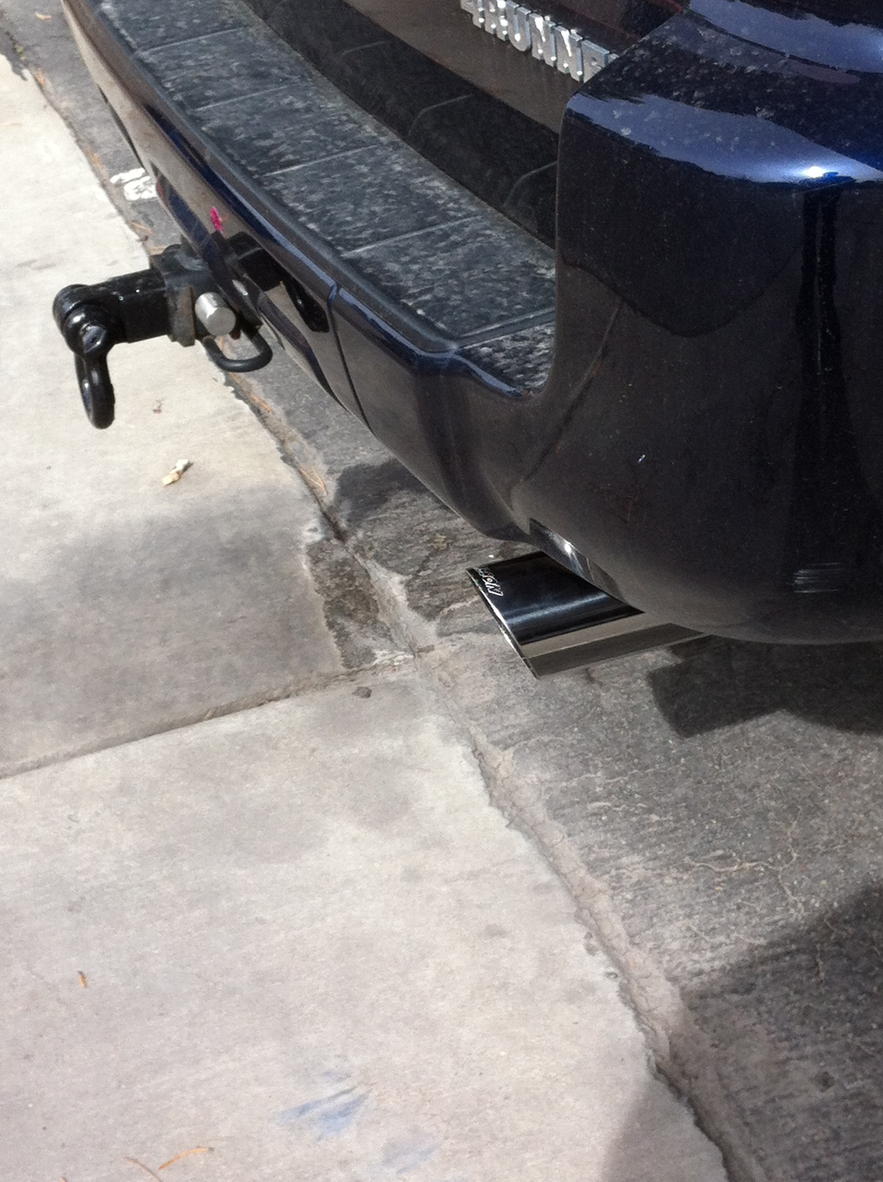

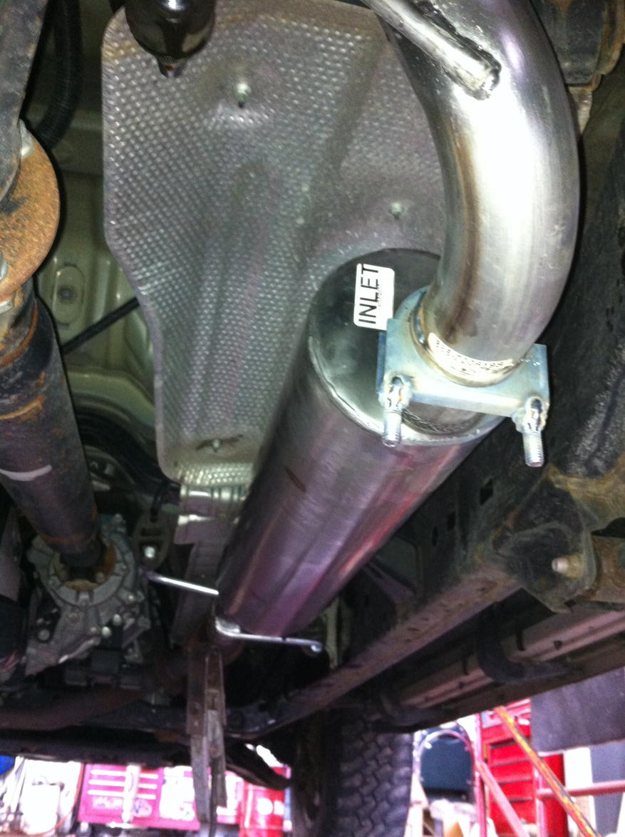

Had the Gibson cat back exhaust installed. Only paid $190 through Amazon, and paid $140 for the labor today. It's the Stainless steel kit. This is the 618708 kit witch is for a 2004 4.7 but it's the same as the 618707 kit besides the head pipe is shorter (the one that connects to the converter) Talking with mechanic and after some thought? We decided to put the muffler on backwards and not install the flange from the Gibson kit. It saved breaking the factory bolts lose and replacing the factory flange witch is a better design and seal than the Gibson. He welded up everything much better than just using the kits clamps.
I don't have a pic of the inside of the muffler but it has 2 large baffles on one half and shark gill type baffling all through the pipe inside, so to catch the exhaust like a parachute. Installing it backwards lets the air flow much more free the guy has been doing custom installs for 10 years and said it would sound better. He was right! Also the mechanic did not like the muffler air flow compared to a flowmaster or magnaflow. But the body of it is very well built and solid. it's not a V8 so the sound is good for what it is. (4.0)
Also decided not to turn the pipe out the side for now see if I like this.
So far I'm very happy with it and how it turned out.
Lost about 50 pounds of weight and gained allot more clearance than the factory exhaust.
Like it or not just want to share some info.

Over all I would say this is a very well built kit it's a bit quieter than some of the others, and even Gibson makes that claim. Reversing the flow on my muffler gave it more sound I think some may really like it and other may hate it. It's not a V8 so you have to keep that in mind I think it would sound better on the 4.7 L for sure.
I'm still thinking about putting the tip out the side I cant open the back window while driving the fumes come straight in. Also the smell was really bad at first during its first heat up but has gotten much better over one day.
The mechanic said this muffler reminds him of the design of a glass-pack but with a bunch of baffles and louvers inside to catch the exhaust. I really wish I would of taken a pic of the inside of the muffler to show everybody.
