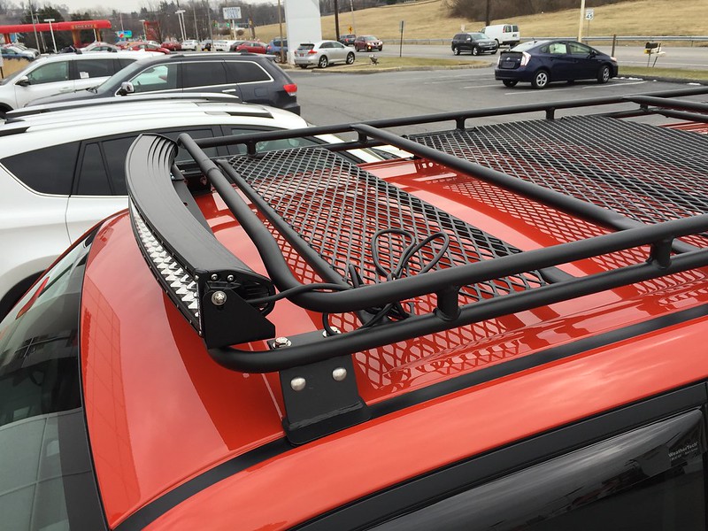

So I just received my Gobi rack and I requested for them to not include the two support bars in the front of the rack so that I could install my 40" Led bar but when I received the rack the supports were there and they gave me the adjustable bars on the rack instead. Must have been some miscommunication... Anyways I was looking for some mounting options. I got the universal mounts but those don't work because I would have to attach it to the bend part of the rack. I saw desert dawg make a custom L bracket but I was wondering if there were any other options out there as well.
No options that I am aware of, I didnt think you could even mount a 40" bar while the vertical supports were inplace without it looking funny (either way to high, below the rack or sticking out infront of the rack). If the misscommunication was on their end (you have proof of the way you requested it?) I would let Gobi now and ask that they make it right. If thats paying a local shop to cut the bars, weld, re powdercoat or if thats sending it back and starting over again I don't know. I like the adjustable bars so no comment on that but if you want it exactly the way your ordered (fixed bars, 40" LED ready) then I bet the only option is to have them make you a new one.

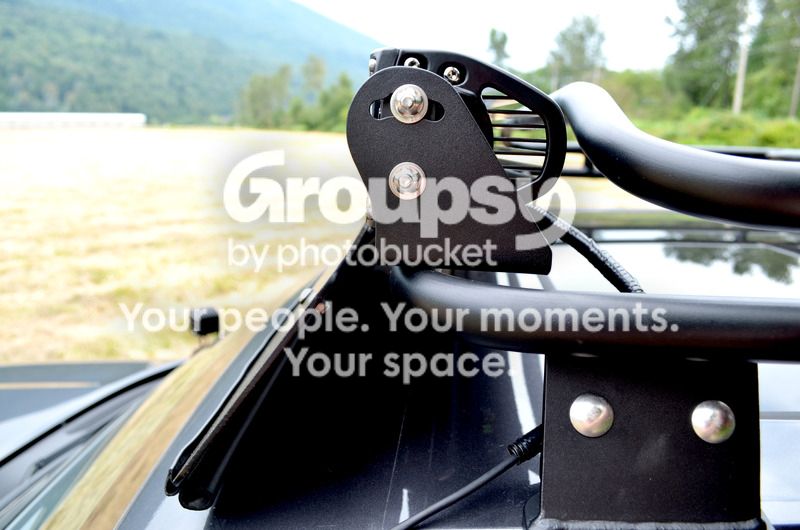

[MENTION=62757]chudiddy[/MENTION] where did you get the bracket to hold the light? I have a curved bar as well and I saw that [MENTION=107769]Desert Dawg[/MENTION] was able to fit one with his custom L brackets with the support bars. but im wondering if it would still fit with the cradle you have. I cant seem to find it anywhere and the only ones I see that are similar are made for jeeps.
When I ordered my Gobi Rack I told them what light bar I was installing and they sent me the rack all set up for it.
^^^ Definitely the way to go; unfortunately, I wasn't as smart as [MENTION=62757]chudiddy[/MENTION] to ask Gobi to custom fabricate the mounting brackets for my light bar so had to come up with my own solution after the fact. Even so, I was able to clear the front supports and still keep everything looking pretty clean.

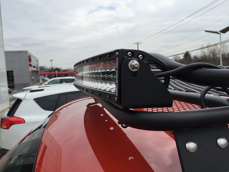

Gobi will arrange for someone to pick it up and ship it back at no cost. But now after staring at the rack for so long I really come to like the adjustable crossbars on top and having the ability to remove it for more storage options. I also have a curved bar and after mocking it up it seems to clear the support bars in the middle. Im trying to see if they can send me the light cradle that comes with the light bar ready racks like the one chudiddy has.
Here is what mine looks like.
At first I had cradles like [MENTION=62757]chudiddy[/MENTION] but the light bar was hitting the rack. I also didn't like that the other cradles only had one mounting location. It would take no time to just pry the light bar up to steal it.
If you contact Gobi, and give them your light bar Sku# they can send you the some ones.
