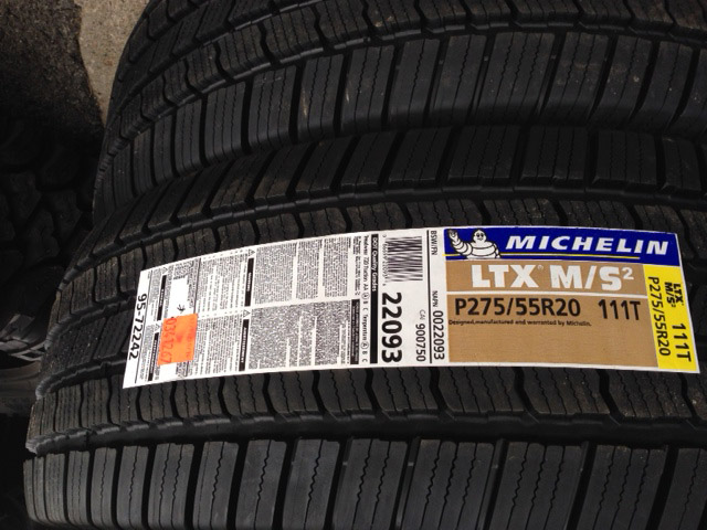

Just to confirm before I drop $850 on some tires: this chart says that 275/55/20 tires fit the stock wheels/stock everything? i.e. LTX MS2s, which are available in this size should fit on a totally stock vehicle without issue?
I have the LTX MS2s on my 13 Limited with stock wheels, and I have no rubbing issues.
The chart is only a general reference... you should probably also look at the manufacturer's specs for actual fitment on 7" width for the tire you are contemplating. Last I checked there were only 3 tires in 275/55/20 that are ok'd for 7" width.
