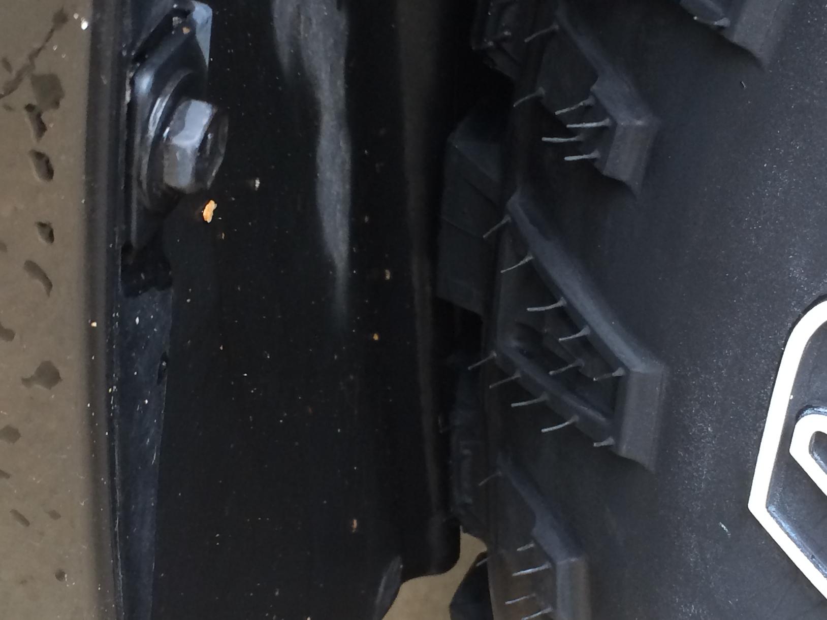

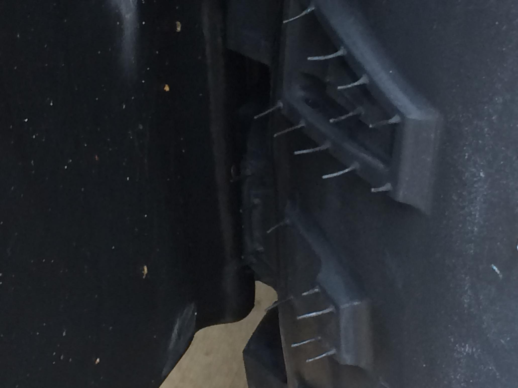

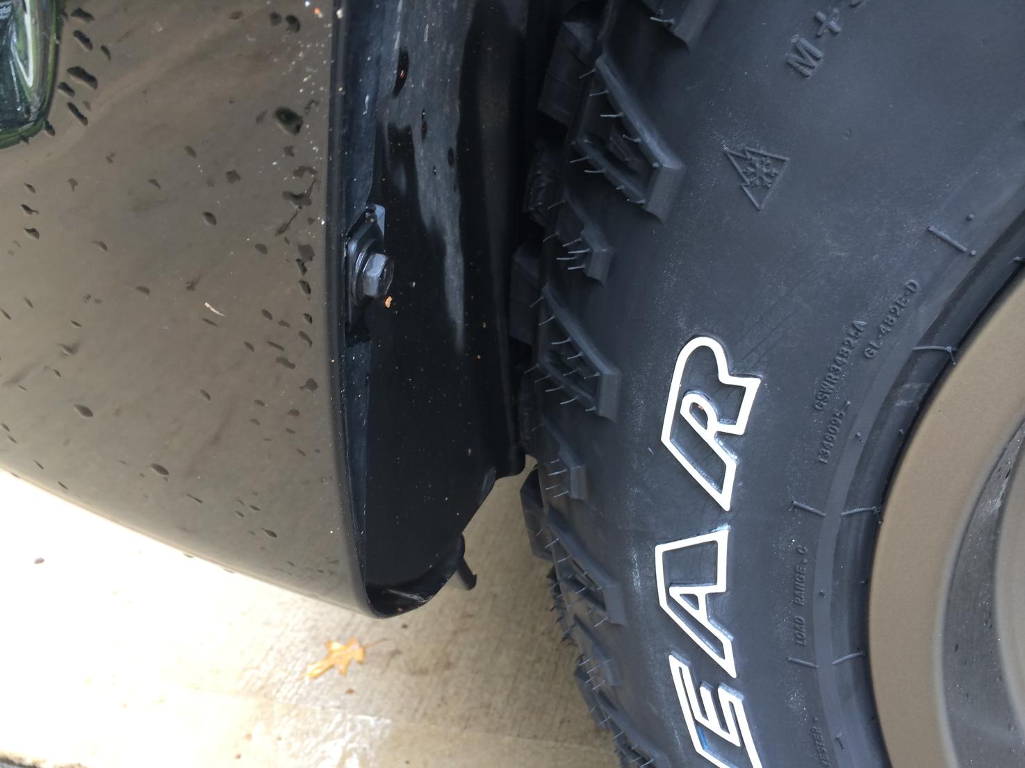

So an update on this. I chose to go with the TRD rims that were 17" x 7" when I found out the 17" x 8" was a two piece rim. So glad too because they look awesome. With that said I went with some Goodyear MT/Rs 275/70/r17 instead of the 285/70/r17 because the Goodyear rep said that size would definitely rub. He also stated the 275/70/r17 would rub when the tire is up in the wheel well and turned. He was right. However, there is very minor rubbing. At the present moment, everything else is stock. Here is a picture just for fun!

That's why I made the "Will It Rub?" color yellow. Depends on what tire you run, what alignment spec you have, what the new wheel offset is etc. Believe it or not everyone's 4Runner is a bit different, hence adjustable alignment bolts. I can say you will rub. Depending on everything else, you might have to move the inner liner forward, you might have to trim the mud flap, you might have to trim the front cover a bit, and if you really are bad you might have to do a body mount chop. None of these things are hard but you will have to do something. Even if you lift you have to do these things. Don't want to do anything? Stop at 275.
