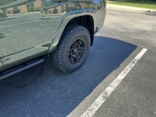

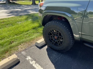

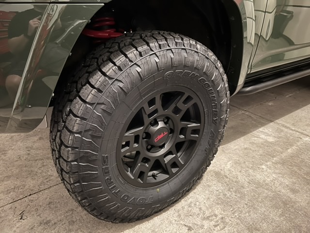

I just fit Toyo AT3 in their new size 34x10.50.
Pro wheels, with 2.25 lift
Fender liner pushed forward and trimmed, JBA arms, front mud flap removed.
I had my caster maxed at alignment. I have maybe 1/4” clearance from the body mount, and about 1/2” from the JBA arms hitting the tire.
It fit though, no rubbing. I added super bump stops up front as well just in case, but so far haven’t made contact on full lock with the wheel stuffed as much I can screwing around on curbs

Like the BFGs these are clearly not really a 34. 33.5 unmounted, and with a load more like 30
I bet a 255/80 is actually taller loaded. But, I wanted a little more width

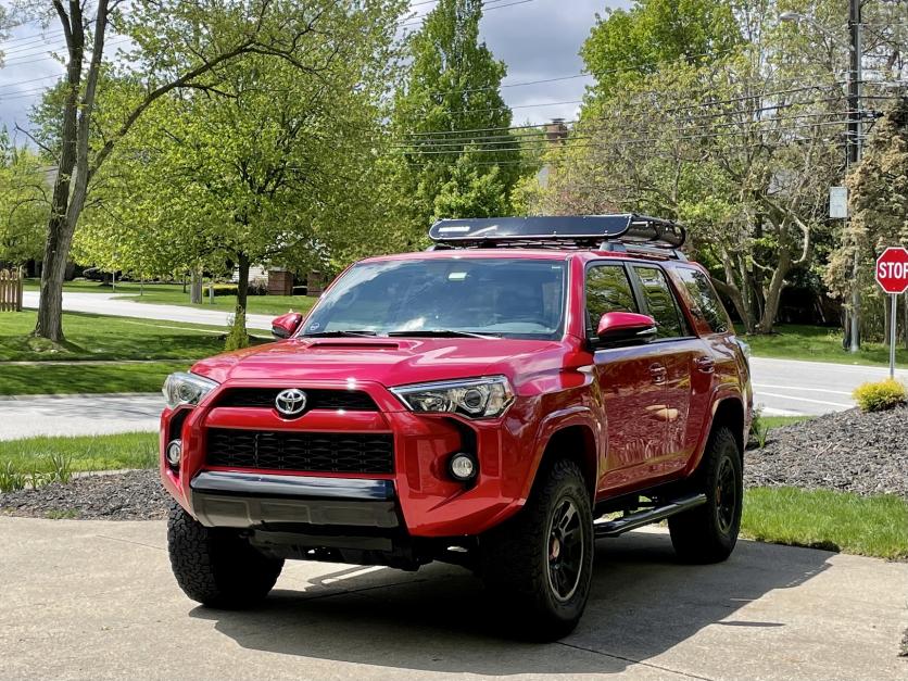

My old truck as a reference point. 2017 ORP, Bilstein 5160 (lift: 2.5" front and 1" rear), 17x9 ET 0 wheels, 285/70-17 BFG K02. Minor fender trimming and fender liner mod. Front mudflaps removed.
