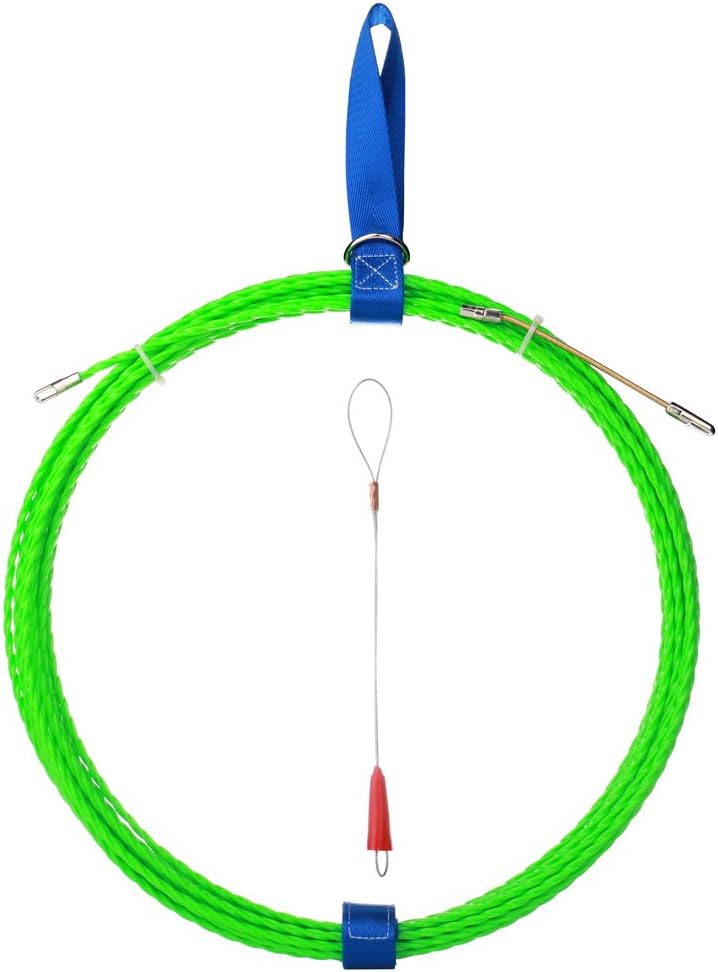

Alright folks. I need to get one wire through the firewall and need to go through the main grommet with the main wiring loom. I have a 2020 pro and that thing is tighter than a frogs butthole. How in the world do you go through that without accidentally cutting wires?
I’ve already used the smaller hole above it that has the removable grommet. So I’m running out of options.
Fish tape wire puller...
although before I had one of these I used a wire hanger which worked.
Fish Tape Wire Puller Through Wall Wire Threader Fish plus Fish Cable Fastener with Steel rope 20FT(6M) - - Amazon.com

Straighten out a coat hanger, then use electrical tape to secure the wire to the coat hanger. Wrap the tape down the hanger a little so that it forms a bit of a “cone” leading up to where the wire starts, and then just pull the hanger through. Easy as that.
