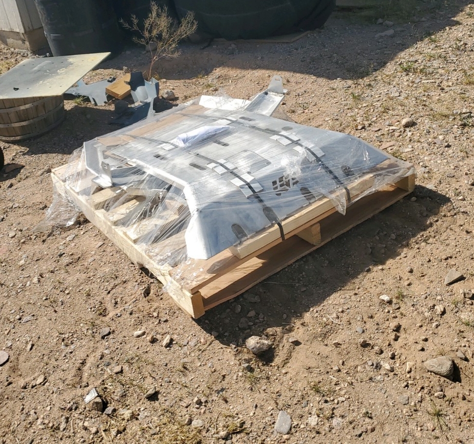

In addition to the Eibach suspension and JBA control arms, CBI aluminum skid plates have been ordered.

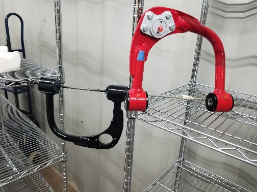

In the meantime the nice, pretty, bright red paint on the JBA control arms is not right for my 4runner. The black paint will be well-cured by the time the slab is ready.
CBI aluminum skid plates will be here and painted by then too.

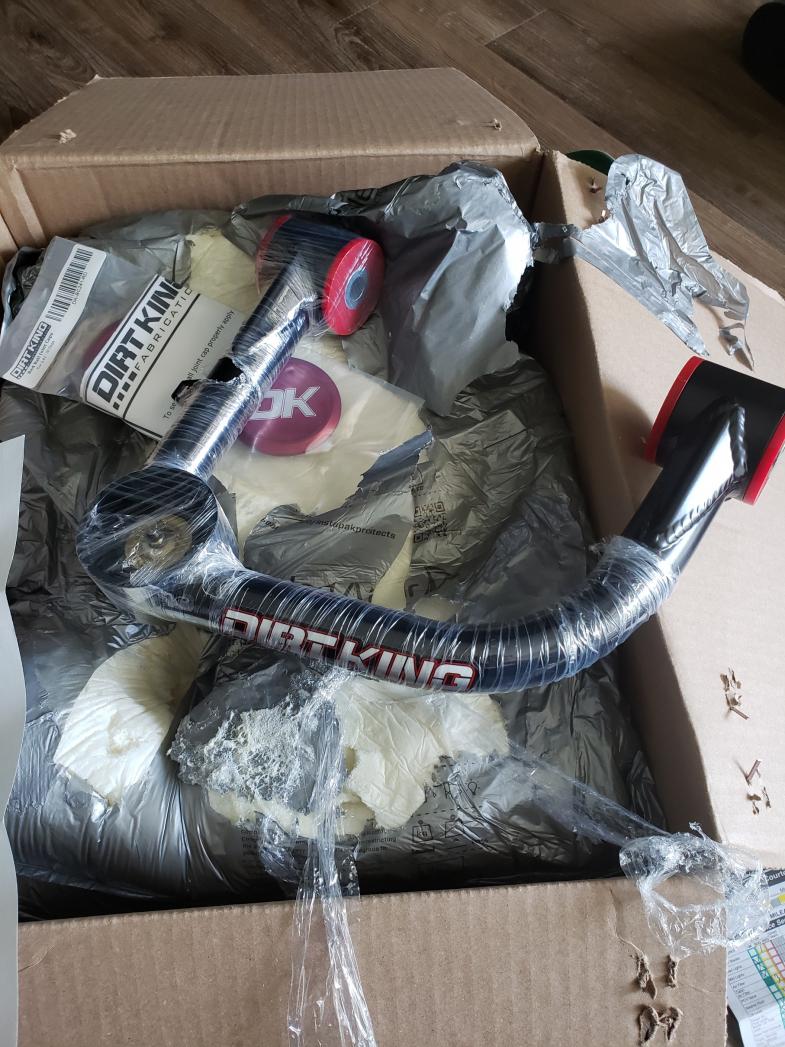

All this talk makes me wonder if I should upgrade...my dirtking ucas just arrived.
2020 trd pro

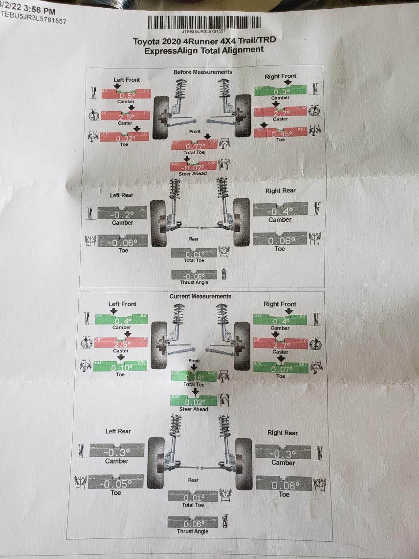

The before alignment is mostly in red because I had just added the eibach lift springs for the trd fox shocks. As you can see the after/current caster is in the red. Not sure if he did best he could, but I know he did not remove skid plate, so I don't think you can adjust rear cams without removal. If that even matters.
Anyways, I don't currently rub on body mount, will putting the dk uca cause me to have to do a bmc?
Any input welcome...
2020 trd pro

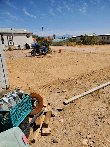

Work began on the 20' x 25' slab yesterday. Graded and substrate. Back Wednesday to frame it.

I found that the JBA arms were great - except that they interfered with my tires without spacers in some alignment setups, but not in others. It's very close and happens on full steering lock. But it's something worth considering. It was more of an issue with the 20" wheels than the 17's. I trimmed the material a bit to clear. No reason to buy the HD version. There's practically no load on the UCA and they just add extra dead weight for no reason.

Installed Dirt King tubular ball joint uca yesterday and got an alignment today with 5 degrees caster and everything else within OEM spec. it really is a night and day difference driving and I wish I did it sooner. I had them sitting for a long time and finally got around to it. UCA are totally worth it, even with just a 2" lift.

All the parts have arrived. UCAs, assembled coilovers, rear springs & shocks, lean spacers, and skid plates.
UCAs and skids need to be painted.

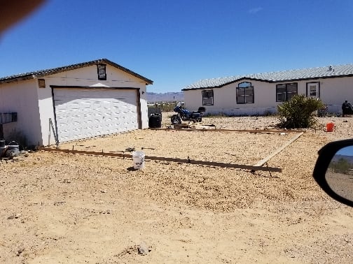

The slab this work will be done on is being poured today. Then 20'x20' carport. Then install parts.

they really just poured it on grade huh. concrete always cracks but at least throw some ABC rock and compact it lol. no footers for the carport posts to set on either?
It has compacted underlayment, it's just the same color as our soil. Also, Wife doesn't photo doc things too well.
The carport was supposed to arrive Tuesday. It's still in transit. Not the end of the world.

I got everything installed yesterday. They were only able to get it to 4.5 degrees as at 5 it whacked camber out. Maybe because I'm only at 2" of lift. It's pulling right a little bit which I knew (they told me and I test drove it) and it's livable, so took it anyway because I was there and they offered to have me bring it back whenever to get the alignment perfect. The shop owner is a friend of mine. Otherwise, it rides and drives well.
I'm wondering if I go back down closer to factory spec (3.3) it will make a difference in the right pull. Maybe 3.5-4 degrees with a little difference between the sides to make up for the crowned roads? Or, does it just need a finer tuned alignment.
