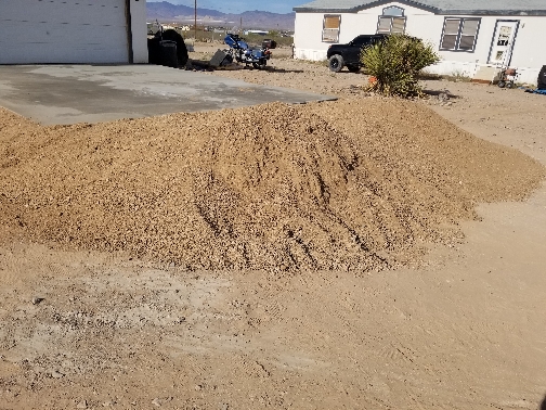

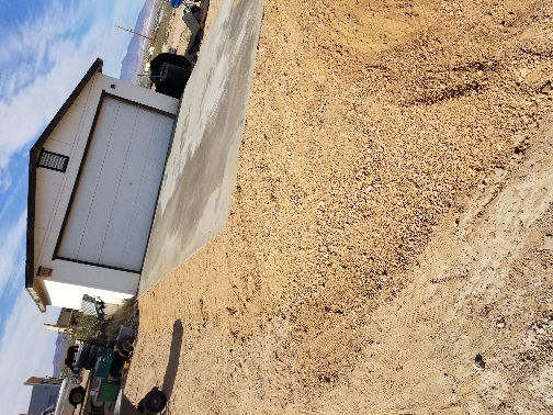

Had more of the underlayment brought in and now filling in around the sides and end. They dumped it right at the end. I moved 136 wheelbarrow loads, paying the price now. That's getting rough on this old body.

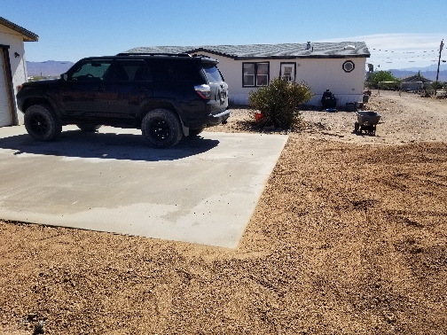

Before heading to work on Wed I had to be the first one to park on it, so I drove over the mound and took a picture.

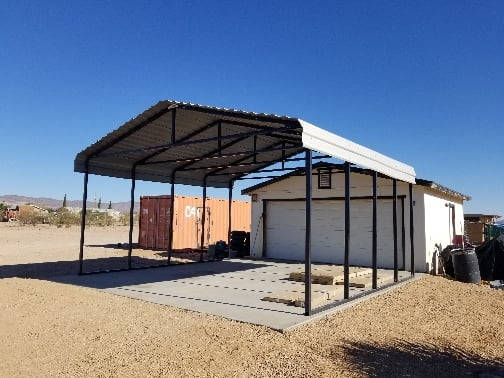

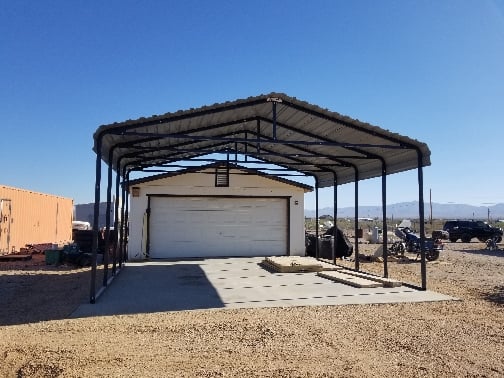

Carport arrived so that will start going up when I get home Mon morning. Projects are difficult when I'm home only 2 days a week.
Sent from my SM-G955U using Tapatalk
I now have a place to work on the 4runner and our other vehicles. Level, flat, smooth, no more dirt, rocks, and cardboard.
Who put those boxes on my slab!?! That's a greenhouse. More projects.

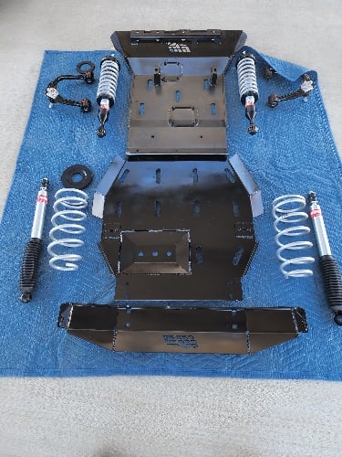

This might be my weekend (Mon & Tue) to install the parts.
Upper control arms.
Front adjustable coilovers (¼" spacer on the left).
Rear shocks and springs (½" spacer on the left).
Aluminum skid plates.
A lot of work and no one can see it unless they crawl under the truck.

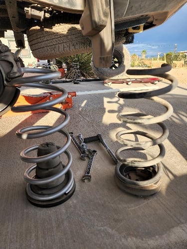

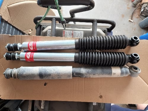

Installed the rear. Not settled, the rear went from 37½ish" to 38¼ish". Have the numbers written down, too tired to go get them right now.
Got up at midnight, started driving at 1am. Got back at 11am. Got home around 2pm, took a nap and started the install around 5pm after feeding the horses.

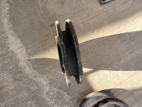

There was a 1" spacer on top of the OEM rear springs. The Eibach springs are the same height as the OEM + spacer. The Eibach shocks are about ¾" longer than OEM.
