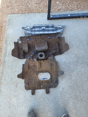

All OEM skid plates off.

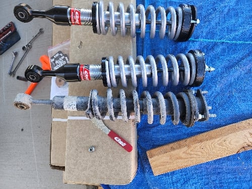

New Eibach Pro truck coilovers are the same overall length as the OEM + 1½" spacer. Spring is shorter.

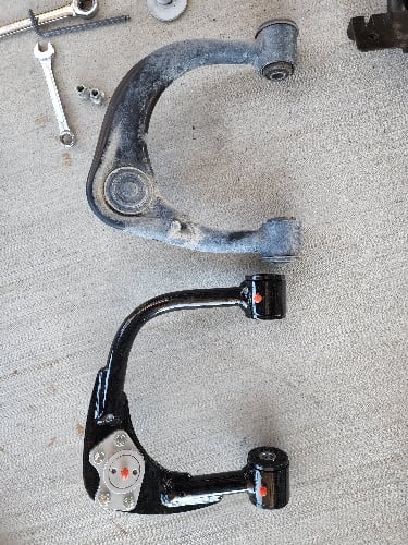

JBL upper control arms appear to have more clearance than OEM. And that increased caster that started this.

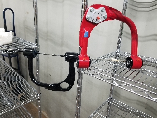

May have missed it, but did you paint the JBA arms black yourself?
Yes.
The rest of the 4runner is blacked out. Bright red control arms would bother me, lol. The aluminum skid plates were painted black too.
All done. Had interference issues with the front skid plate and my aftermarket front recovery brackets. Had to decide whether to remove the brackets or whittle away a bit of the front corners of the skid plate. Ended up removing the brackets. I will probably use the plastic filler piece as a template and make one out of sheet metal to fill the void.
Initially the truck is taller than before. It came with 1½" spacers on front and 1" in the rear. Eibach Pro Truck suspension coilovers and rear springs are the same length as the OEM with the spacers.
