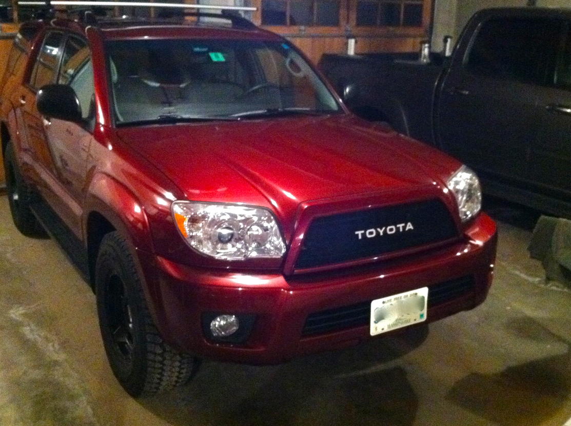

These are 275/70R17 Goodyear "Extreme AT"s but they have the same tread pattern and sidewall as GYSAs so they should give you a good idea how they look.
I'm running Overland Warehouse Radflo Adjustable COs up front (~2.75-3" lift) and Sway-Away 1.5" rear coils (~1.75-2" lift). More pics if you click the link in my signature.
