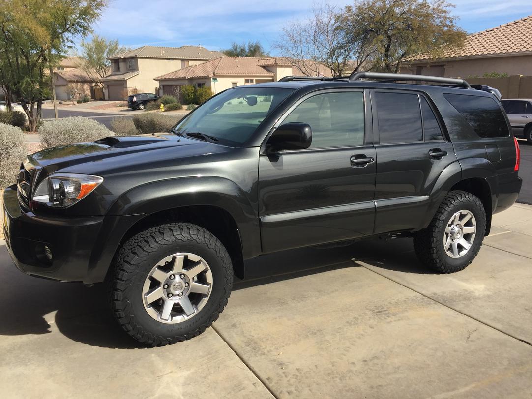

Thanks to discount tire I got ro ride on the E load for almost a month while they ordered the C range. They then had to order a couple more C load tires as I must have gotten a couple of bad tires and had some shake so its been a long haul to get to were I am now. So figured I would share my experience between the 2 very different set of tires. The E load set was alot firmer and it brought out creaks and rattles that I never had on my truck which is a 2008 Sport V8. At 7.7 pounds heavier per tire it also cut into the power as well. It still road well on the highway but at slower speeds it was way to firm. After getting the few bad tires worked out I am overjoyed at how great the truck drives with the C range. Alot less rattles and the power gains between the 2 different sets are very noticable. I also had removed my spacers and put new rims from a 2016 TE for $300 and I and super happy with it now. For 120,000 miles its pretty clean and hard to believe its a 9 year old truck and will be around for years to come.
