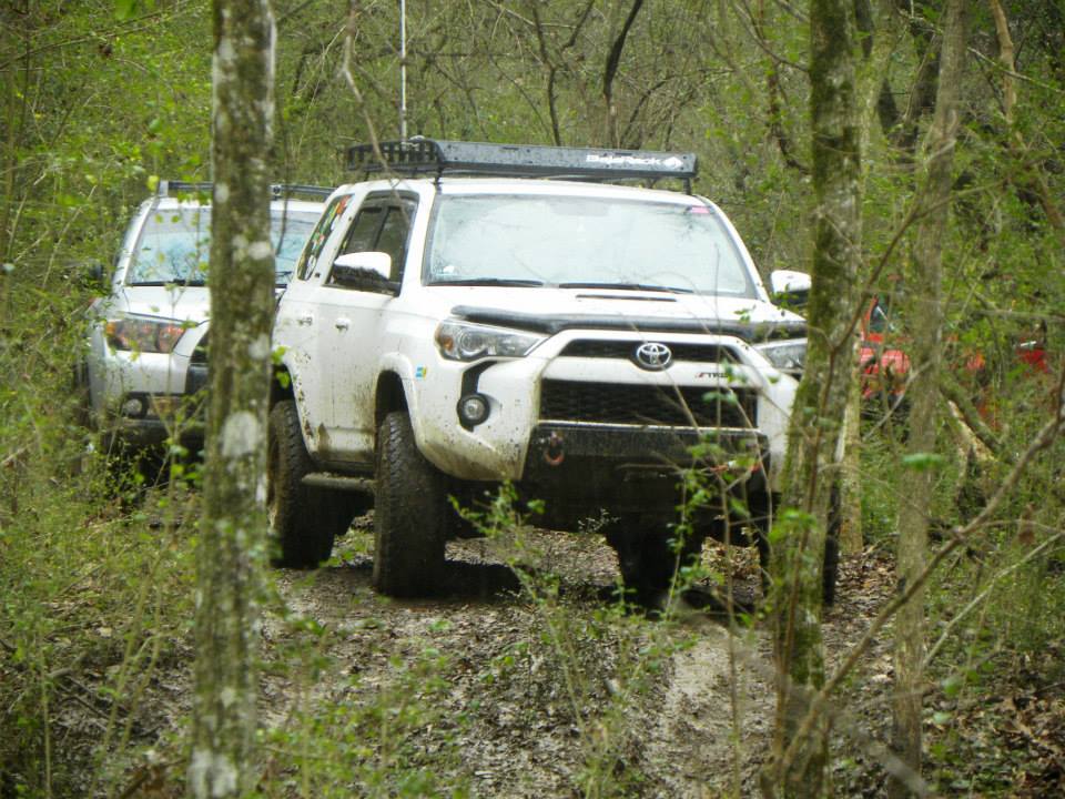

PS. those woods trails are tight but not a rock to be seen :P throw in basketball size rocks, 30-40 degree incline, and 2-3 foot ruts that snake through the whole thing and welcome to early 1900's AZ mine roads.
