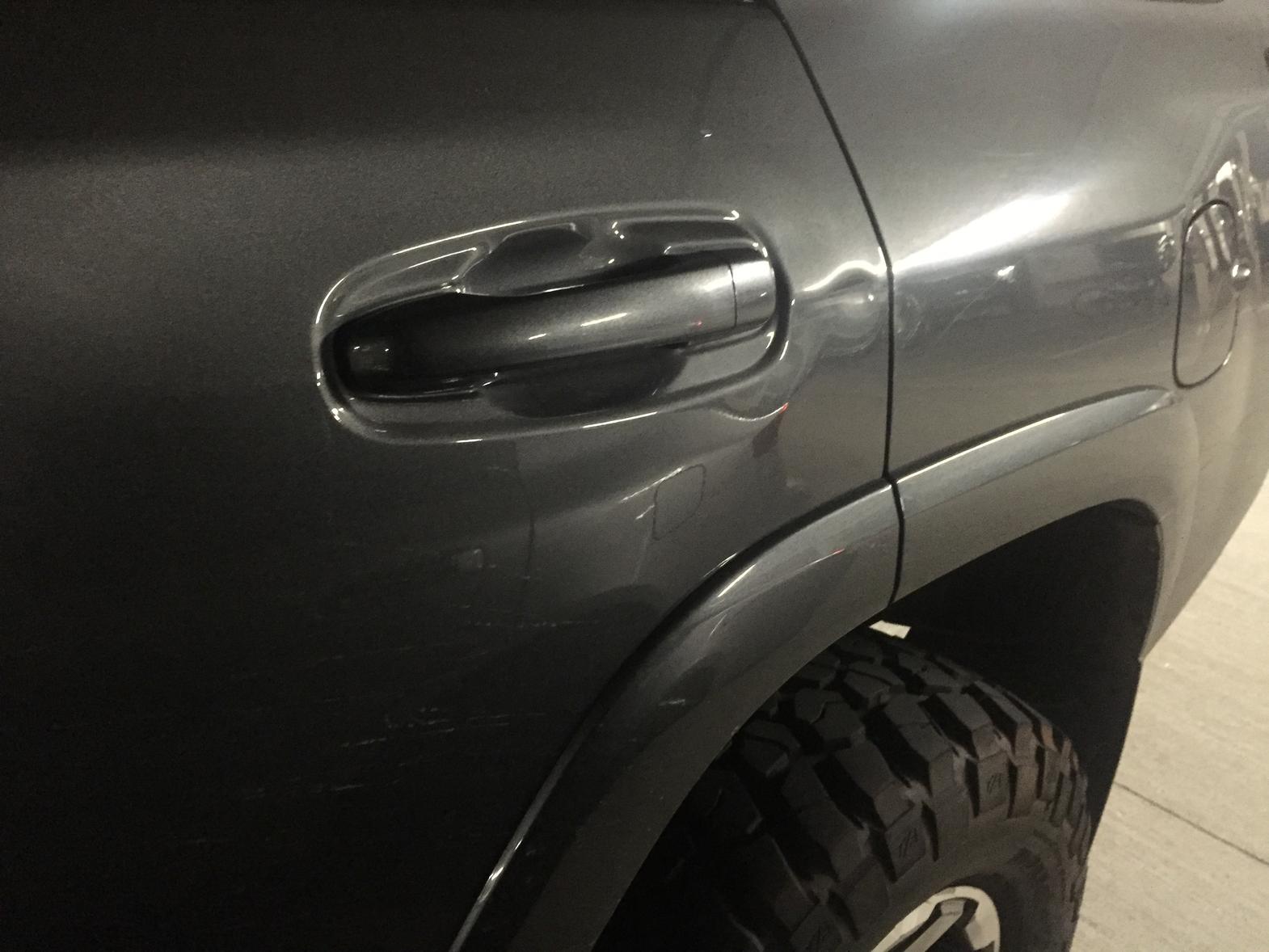

Been There Done That , in Moab i never felt the 4runners size (was not running lots of trails howevER) but out in the woods is a different story and you do appreciate how the earlier gens would fit into tight spaces better.....obvious trade off for interior room, comfort etc.
There are a few tight spots
