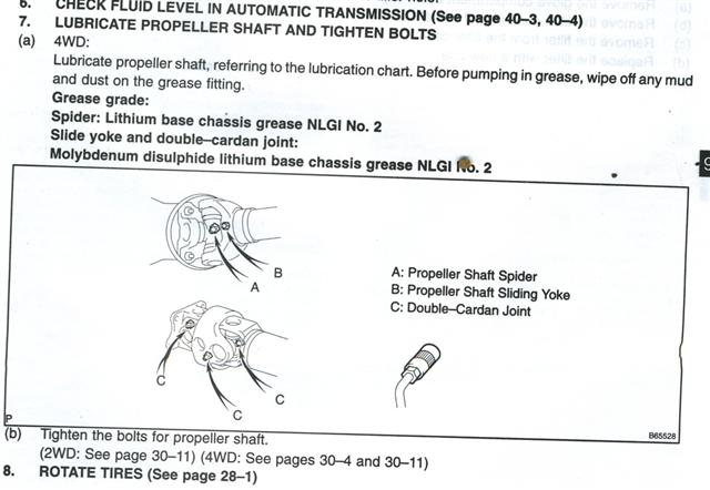

this may help

Anyway, I found that there are two fittings at one end of the drive shaft and one zerk at the other. And, being a 4x4, I have both a "front" and a "rear" shaft. {If I found all of them, the total is indeed six.}
I squeezed them full of grease until I saw it ooze out from a nearby orefice. Hopefully, I put in the right amount. Of course, I'll grease it again when I change my engine oil & filter in another month or so.
