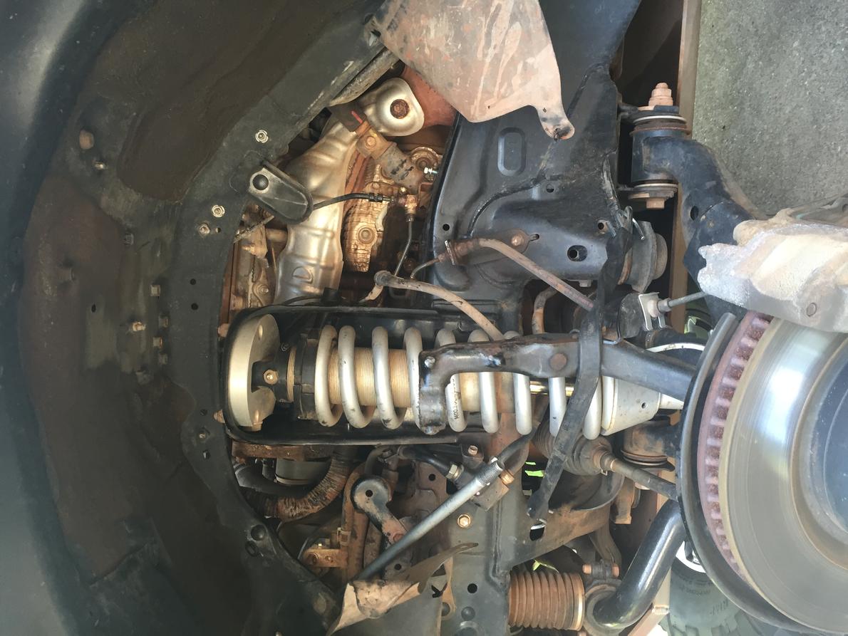

I think I need some advice. I got the grease gun and grease. Per procedure I'd like to loosen the bolts first. One side is 17mm and the other 19mm. Only tool I can get onto either side is a wrench. I can't get a socket/ratchet in there. Basically space issue as the tools interfere with the inner body panel. As a result I think i just don't have enough leverage to loosen either side from the wheel well area. How should I be going about this?
Any advice is greatly appreciated.
Remove the splash shields, remove the 12mm bolt and push the brake lines out of the way.
Ahh, I didn't think about that. Assuming this works, then I think I'm set as I need to loosen one side effectively.
One more question, should I put anti-seeze on there?
I would go more for blue loctite. The bolt gets regularly splashed with grease from the LCA bushing, it is constantly moving, and having it loosen up is easily catastrophic. Personally, I use a lock nut.

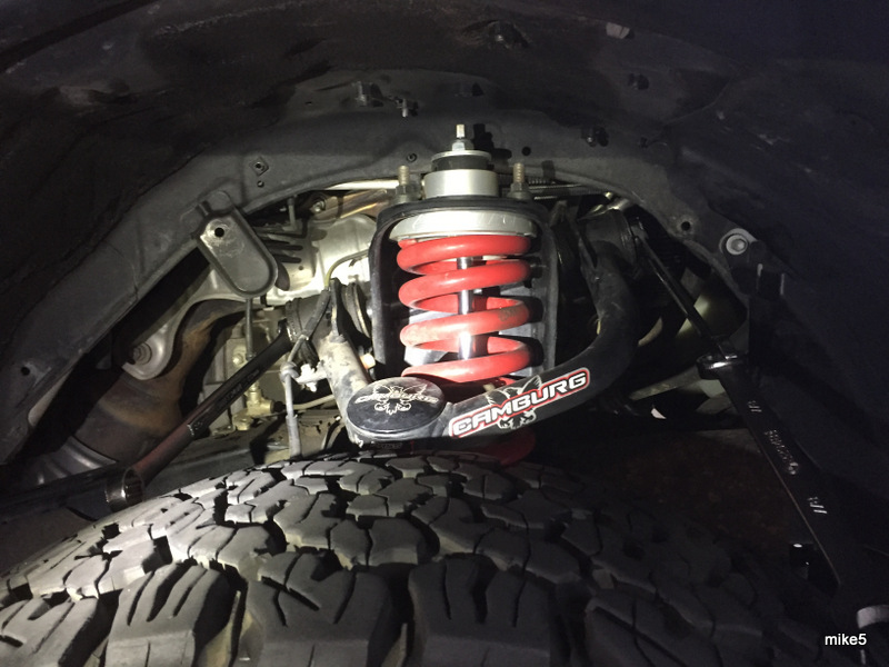

I think I made some progress today thanks to this thread. The work is done on the passenger side and I'll tackle the driver's side later this week.
I bought the items needed from Amazon:
Grease Gun
Grease (contains PTFE)
Here are the rough steps:
- I jacked up the front of the car maybe 3 inches to get a little bit more room in the wheel well
- I removed the top clips of the rubber wheel well liner to get more room
- I removed the two bolts for the brake line (one from underneath hood and the other from wheel well) and moved the line slightly out of the way. Given the tools I used to do the job this may not have been needed.
- I used wrenches on both sides. On the 22 side (left in picture), I placed it on there and wedged it against the tire so it wouldn't move
- On the 19 side (right side of picture) I used two wrenches for leverage (got the idea from this video)
The last two steps above is what got the damn thing to turn. I suspect it was tightened with an air gun. I loosed the bolts enough so that I could see movement by the bushings next to them. Finally I pumped 3 or 4 pumps of grease into either side. Once done I tightened everything up by hand using the leverage trick. Not sure if the torque wrench would have fit on the 22mm side (although I couldn't find the socket, so didn't try).
I also did not use loctite because I couldn't really see the threads. I think though I could have removed the 22mm nut without any concern and put loctite on there. I'll try that on the drivers side.
The picture below shows the leverage trick as well as the wrench leaning against the tire during the loosening process.
My recommendation, use a pair of vice grips on the 19mm (bolt) end, and get an impact socket and 24-36" breaker bar for the nut end. Ideally, tighten the UCA bolt with the UCA disconnected from the spindle and tighten until it makes noise, then back it off until it is quiet and locktite or locknut it in place.
