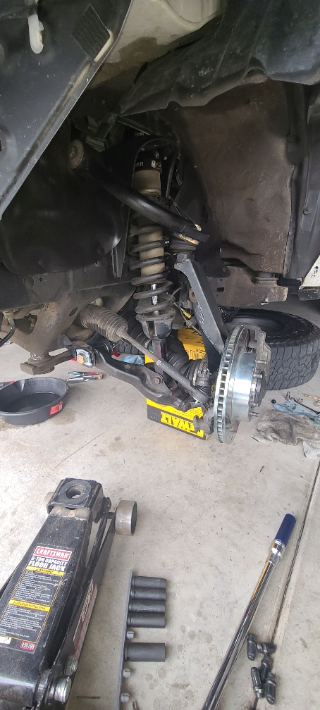

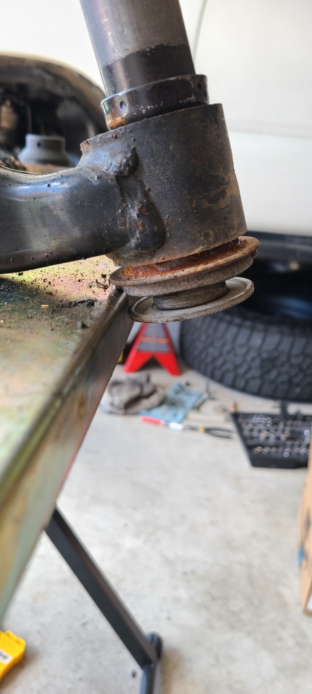

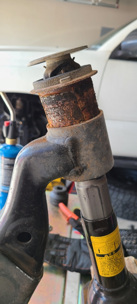

Passenger side I worked on a bit this morning after breakfast. The ball joint finally gave after two days of penetrating oil sitting on it. I heated that bad boy up, and stayed on the trigger on the impact. I was about to give up and drive to a shop to have it pressed out when I noticed the seal had broken, it had about a 1/8 inch gap between the joint and LCA. I reassembled the press and gave it some more and slowly but surely it pressed it out.

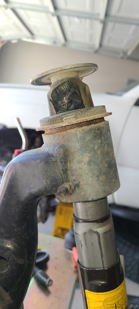

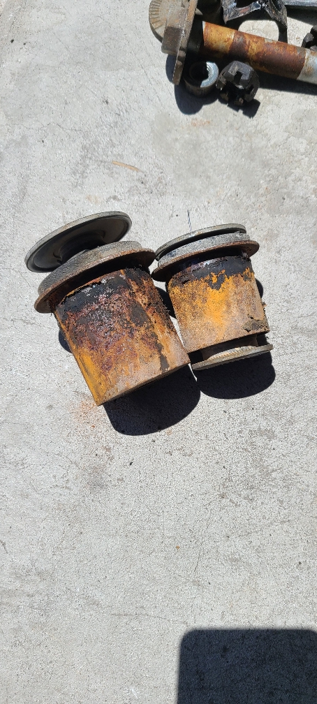

I got the bushings out easy peasy. Some pictures to make [MENTION=429038]y=mx+b[/MENTION] envious again.

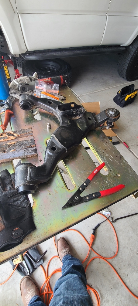

I installed the new bushings and ball joint after cleaning it up. Tomorrow I'll weld the spindle gusset on. Reassemble and go have the toe set by the shop. Unless someone has a good video or write up of how to do it in my garage.

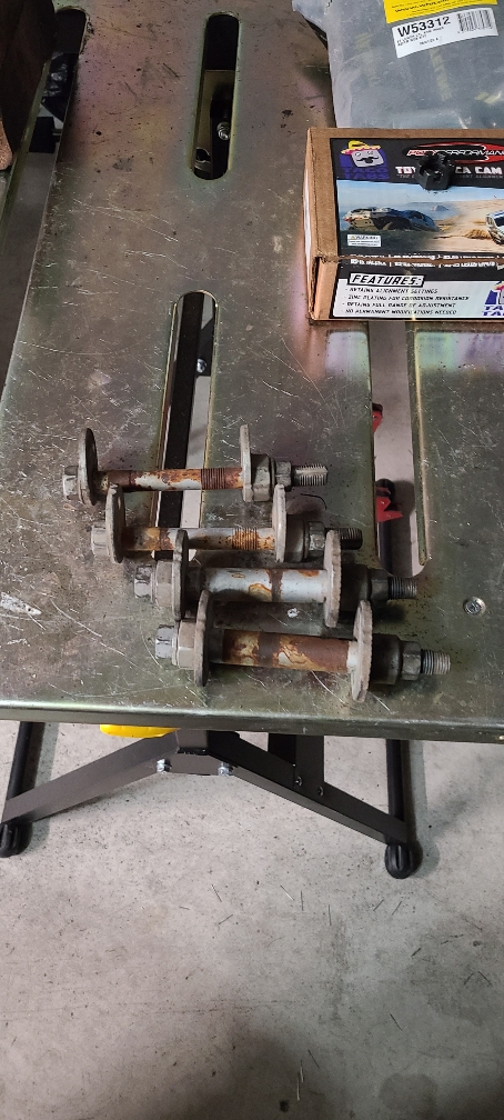

Are you suggesting this isn't something to be envious of lol. I see an intact cam bolt and both bushings together with shells in one picture, and I think it must be photoshopped lol
Wow, that makes me wonder how you even got the job done in the first place. You must be a determined individual lol.
Pic of rebuilt LCA. I accidentally broke the grease zerk off on the LBJ, I'm gonna have to drill it out and buy a new one. What do people use in these? I use Mobile 1 for the drivetrain and rear sway bar bushings. Will that work in the ball joint and tie rods?

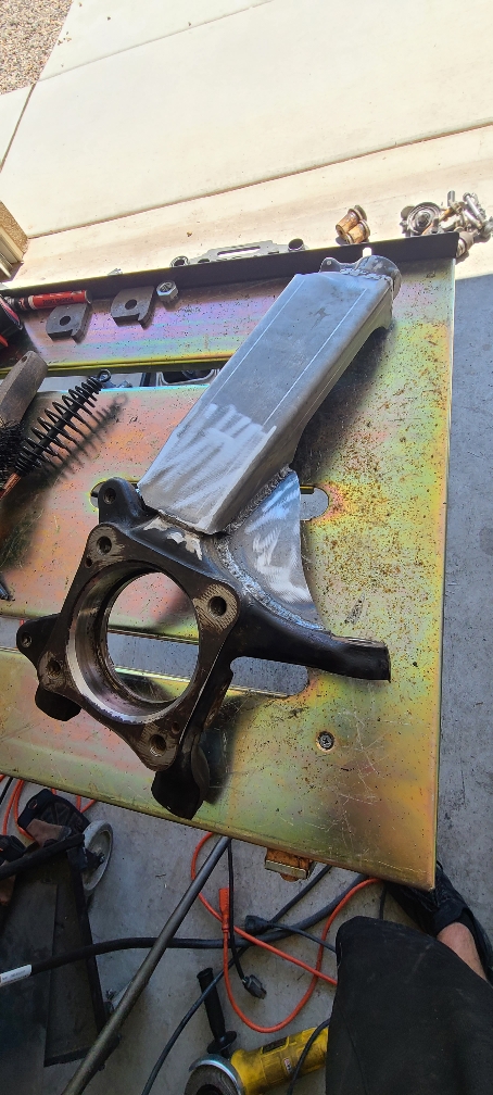

Passenger spindle gusseted.

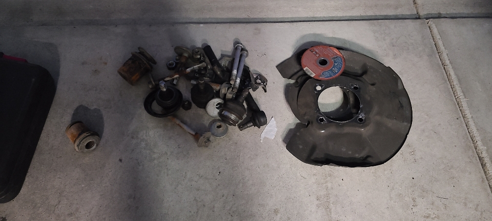

Pile of parts removed. Not all but most.
The cam bolts are still ok. Anyone have use for them? Not seized, could use a good cleaning for the surface rust but still functional. $20.

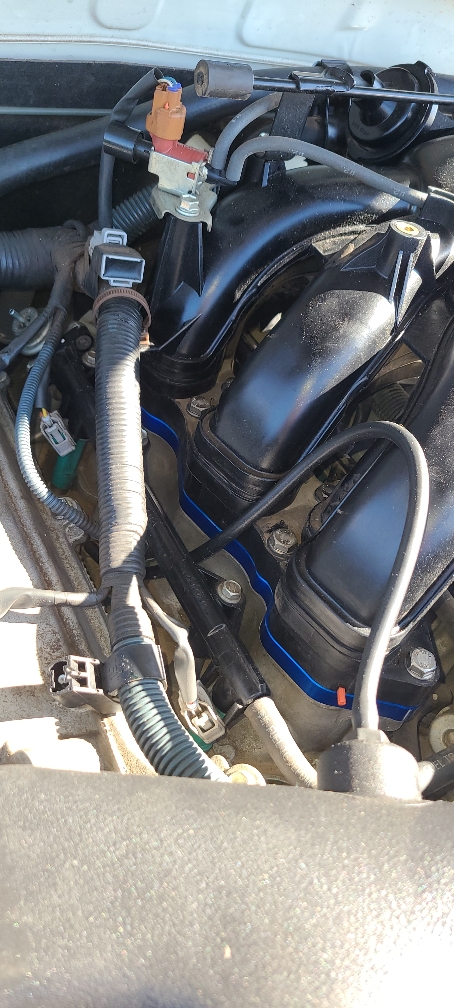

Installed my exhaust cam gears and intake plenum spacer last night. Overall not too bad as long as you stay organized. Lots of bolts to remove.
While I had everything apart, I installed fresh valve cover gaskets, plenum gasket, throttle body gasket and PCV valve.
Very pleasantly surprised at how clean everything was at 155k. No sludge or grime.
Feels peppier and idles much smoother. Will report back on MPG's after a few tanks.

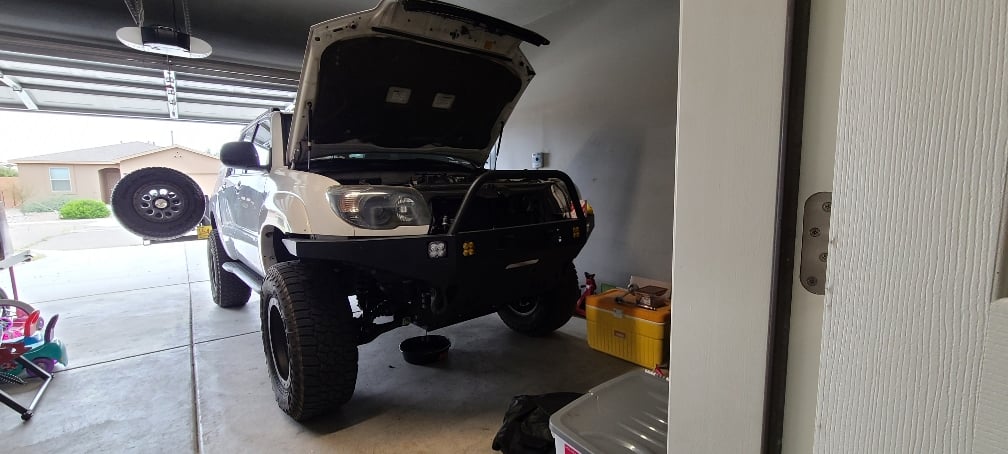

So I finally feel like I've done enough to the rig that it merits a "build thread" of sorts.
I've been on this forum since about 2014 when I bought the thing and came across it by accident searching for cheap strut replacements. Yeah that back fired big time. I don't have photos from real early on, just a few from when I got my first wheels and tires. Anyway, here goes:
2008 4Runner SR5 4x4, plain Jane and bone stock. Purchased May of 2013 with 89k on the clock for in the neighborhood of $19k. Unlike some of you, I bought this vehicle not knowing a thing about it. Never owned a Toyota, never off roaded, didn't care it was 4x4 except for driving in snow once twice a year, just caught my eye on the lot. Ichalk it up to sheer luck that everything worked, including the 4x4.

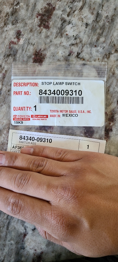

Picking up my son from preschool today I had to try two or three times to get the old girl out of park. At first I thought it was just me as I had not driven it in a few days.
On the way home, the VSC and ABS lights came on. If I researched correctly I need a stop lamp switch (brake pedal thingamabobber). I ordered one from McGeorge for $23 shipped, I've had great experiences with them. Hopefully that fixes my issue.
Got the switch in, took 2 seconds to replace. Unplug blue connector above gas pedal, twist counter clockwise, pulk down. Replacement is opposite with new switch. Issue fixed.
Part number in case someone has the same issue.

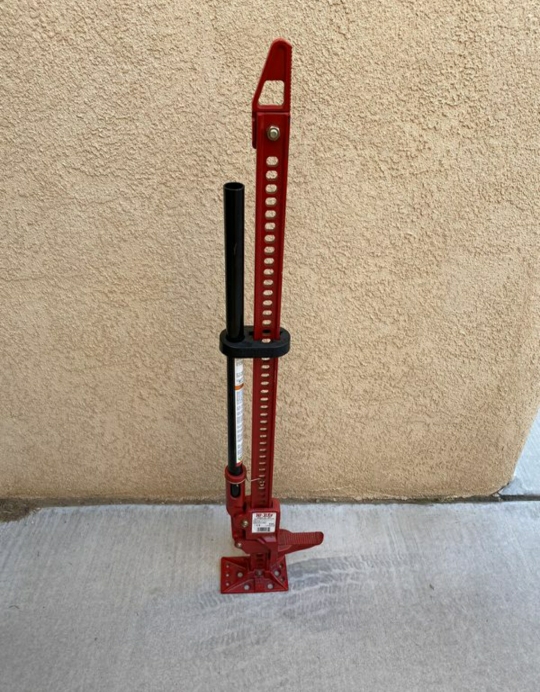

Scored a 48" hi lift for $50 locally on OfferUp. Looks brand new, older gentleman said he never used it just sat in his garage. Now gotta find a way to put it on the Ultraswing. Gonna make my own, not gonna pay $190 for the Rigd accessory that's nuts!

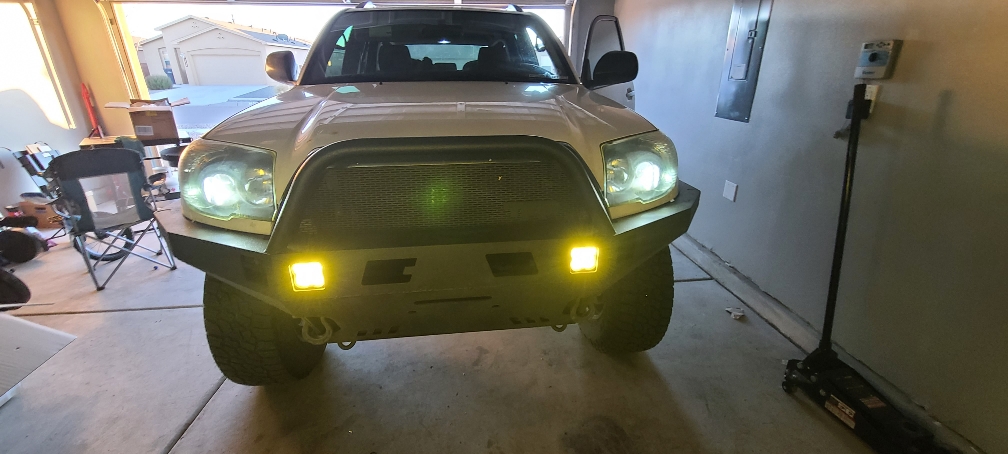

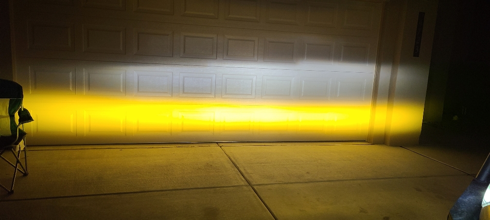

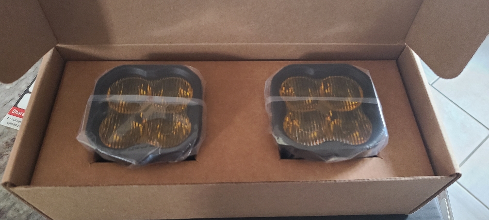

I had been meaning to get some SAE compliant fogs for a while. I initially wanted the Rigid, then BD put some out (have two pairs of their squadron sports currently) but I heard there was issues with heat and the pattern wasn't great.
So for black Friday I treated myself to the Diode Dynamics SS3 Sport SAE fogs in yellow.
The cutoff is killer and the constructions seems very nice. I'm impressed so far!
