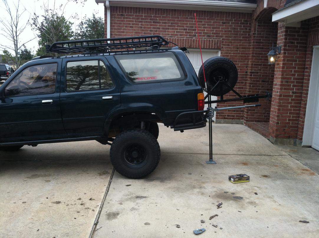

Full droop and it just barely tugs the brake line, that will be my next project along with bigger tires.

That is the max your link arms will let your rear drop unless you loosen bolts. Most accurate flex test will be find a loading dock or rti ramp and do one wheel at a time . I know the 4wheel parts on 610 has one outside we use for flex testing . One on westhiemer might .
Caution have another person with you to let you know when your at the limit and when to stop trying to go higher !

The brake line runs down to the center of the axle and the shocks bottom out at the same point. Only did it to check the brake lines though

you don't want your shocks to be the limiting factor, you links will be. It will damage your shock seals. Plus when your axle pivots side to side it will allow for more droop if your shocks had extra travel and could split brake line. you can do it quick and dirty by pulling clip holding hard line in bracket and letting it float.

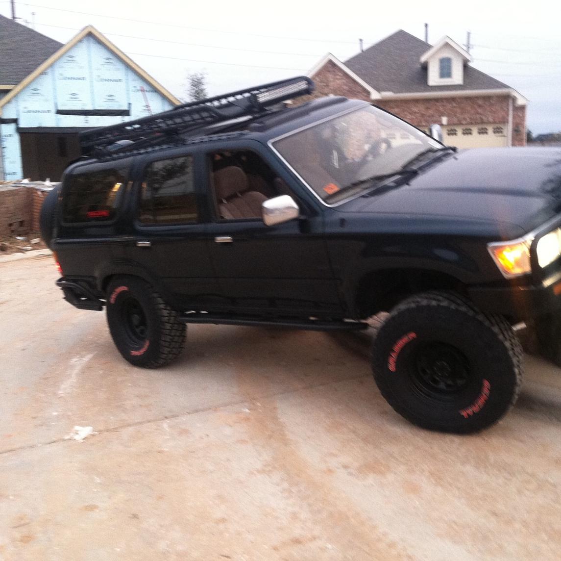

Just put in an order for a set of general grabber red letters, 33x1050, next on the agenda is to install a set of OME HD's in the rear, 4 crawler drop bracket, and weld and repaint my rust bucket of a rola rack. Also looking into using large L brackets to mount the roof rack so that it is lower profile.
Tires look good! Big fan of those General Grabbers.
