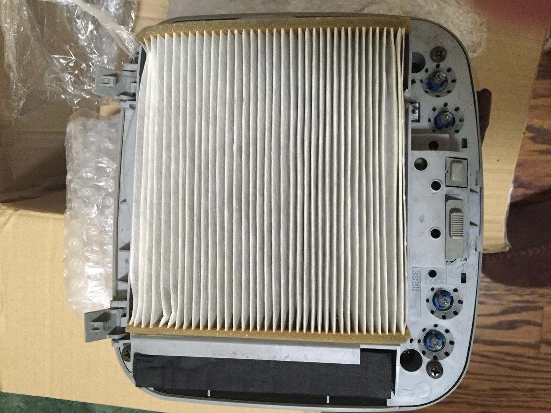

Aux cabin filter and Optitron did arrive though. Since I can't use it I plan to install it on a local truck, catalog and store or sell. This is a pic of the aux unit, had a charcoal filter and regular filter. Also has four LEDs for lighting. Will require some fabbing but looking forward to the install.

JDM Aux in cabin air filter install. Plugs in to existing connector without issue. 4 bulbs rather than one and both fan and filter activate when engine is running.

More pics of the in cabin air filter and fan unit. No plans to LED this cause I really like the appeal of the four halogen bulbs. Filter is needing replacement so I'll be looking for something soon. This was an easy install and plugged right up to the existing connection. Came with a ground and all in all was a cinch to knock out.
