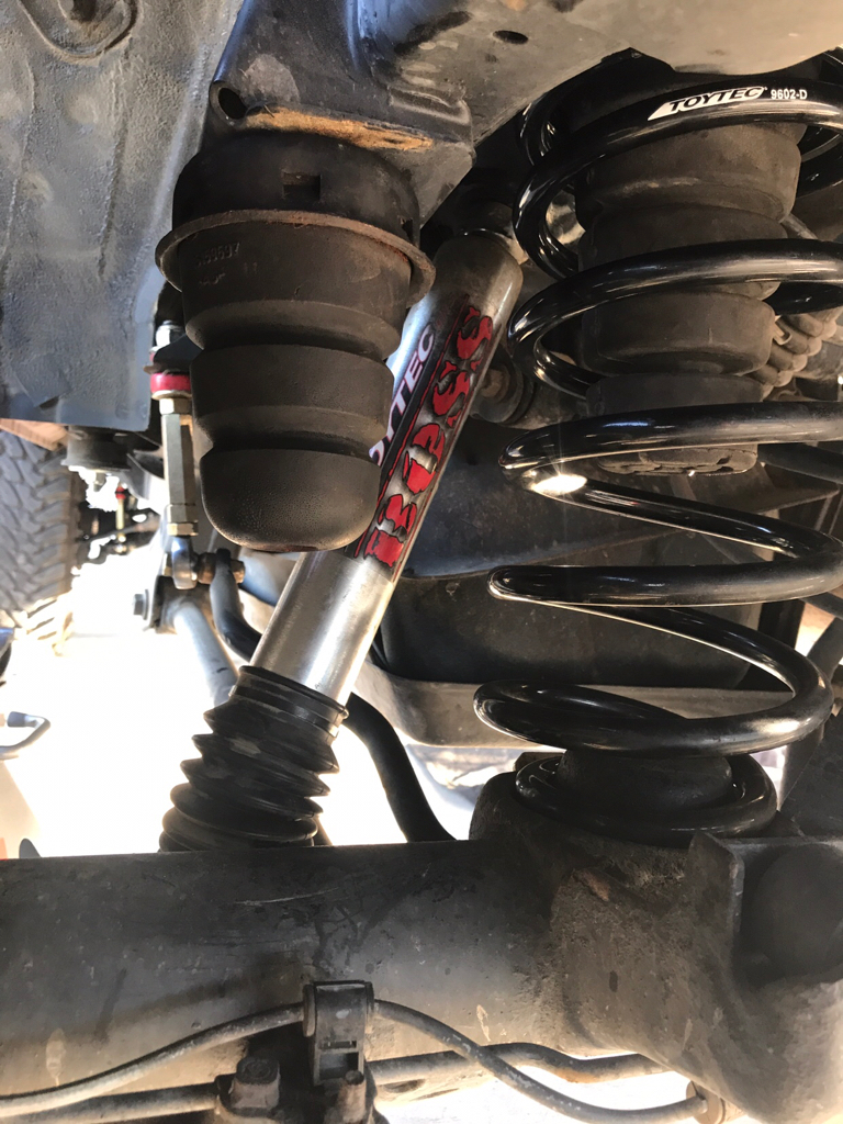

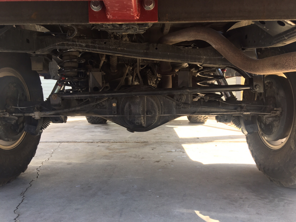

Finally got my Toytec Panhard Drop Kit Installed.

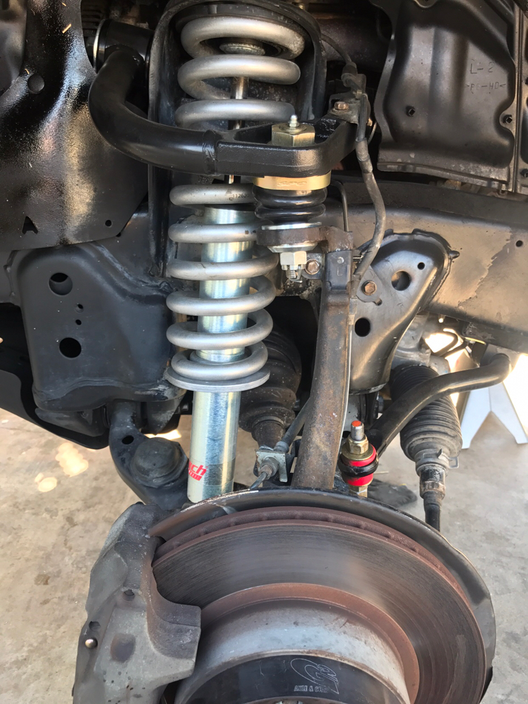

Finally got my SPC UCAs installed last week. Installation went smooth, but had a few issues. Unsure if they were related to the UCA installation but I started to notice a little bit of delay in my throttle response. It doesn't happen every time. It's comes and goes and it's only when I accelerate from a complete stop. I will be doing some research on this, but if any of you have any suggestion let me know.
Currently installed on setting D, might be switching them over to G due to the rubbing on the pinch weld. I managed to hammer it in and so far it's working. We'll see how it handles the trails this weekends and go from there.

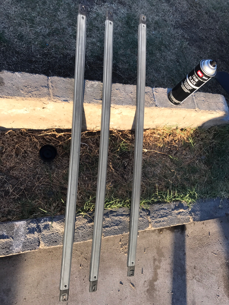

I also da little roof rack refurb with some SEM Trim Black.
After picture to follow, just realized I didn't take any.

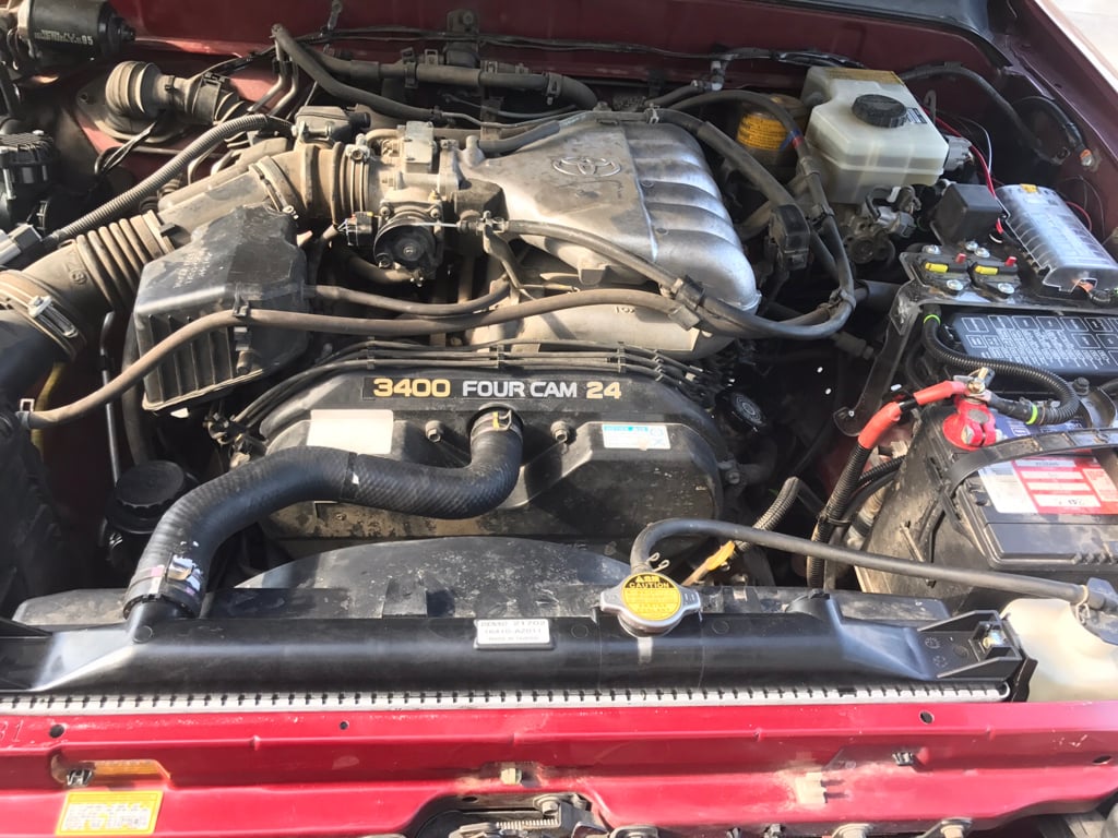

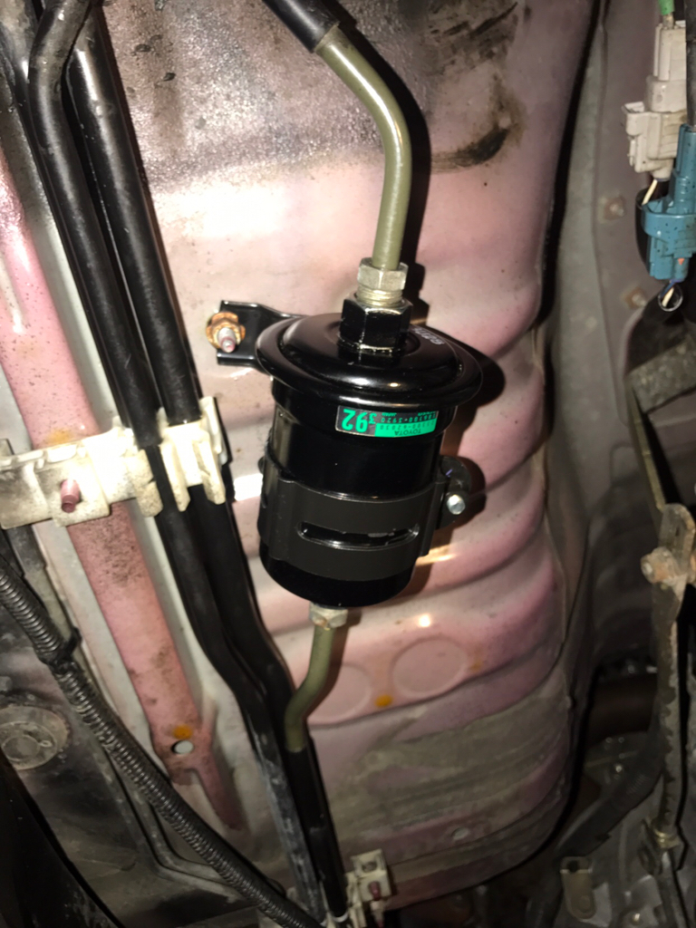

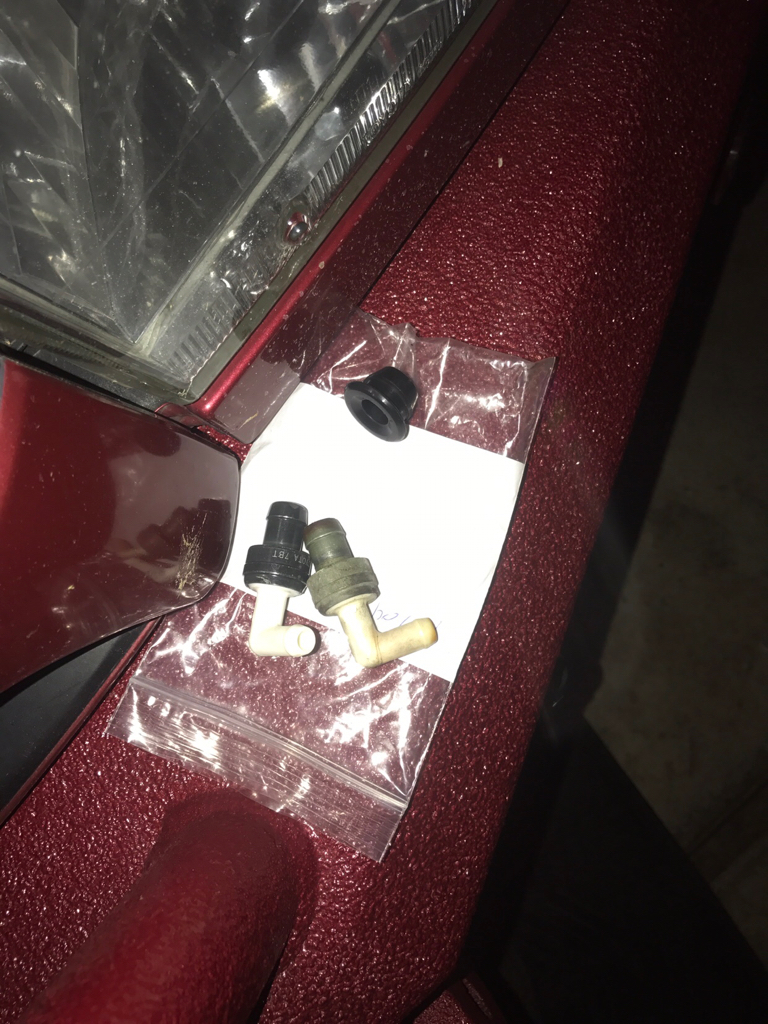

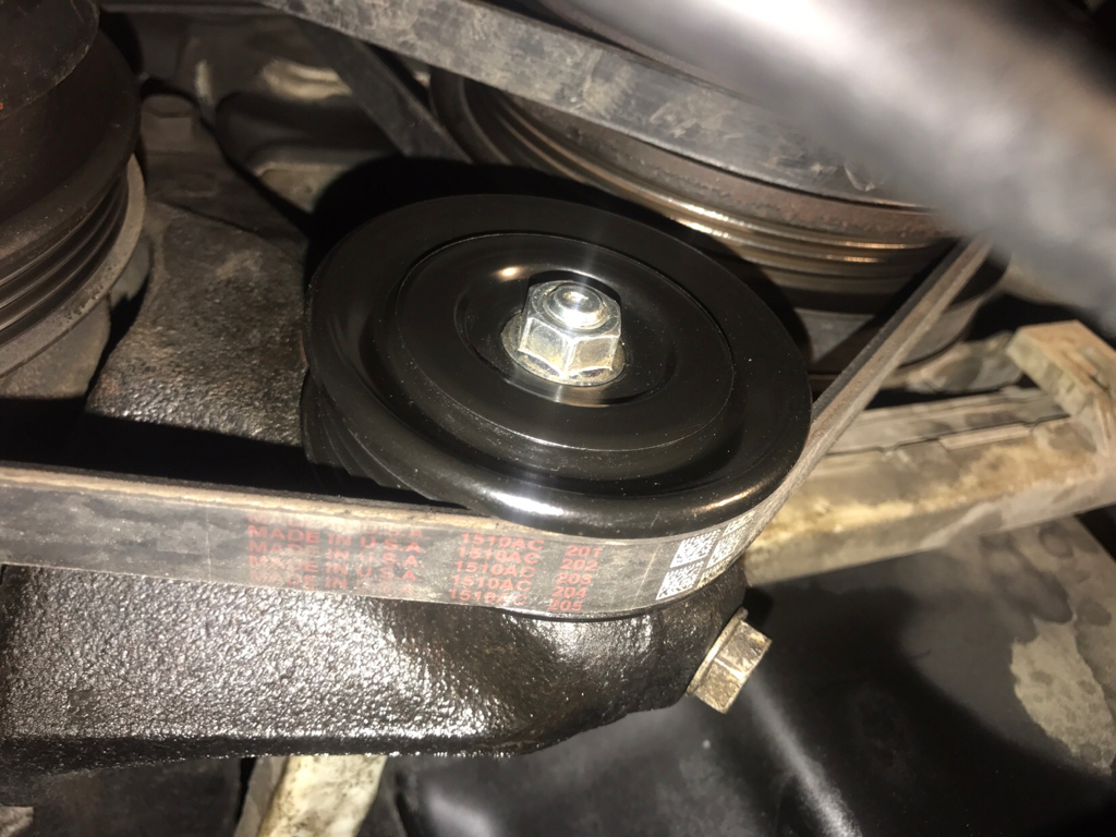

Slowly getting all the parts installed. Got the new fuel pump, Idler pulley, PCV Valve and grommet.
Next up is the Radiator and Trans Cooler. Hopefully I find time this weekend as it'll probably be an all day project for me.

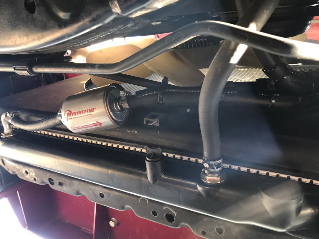

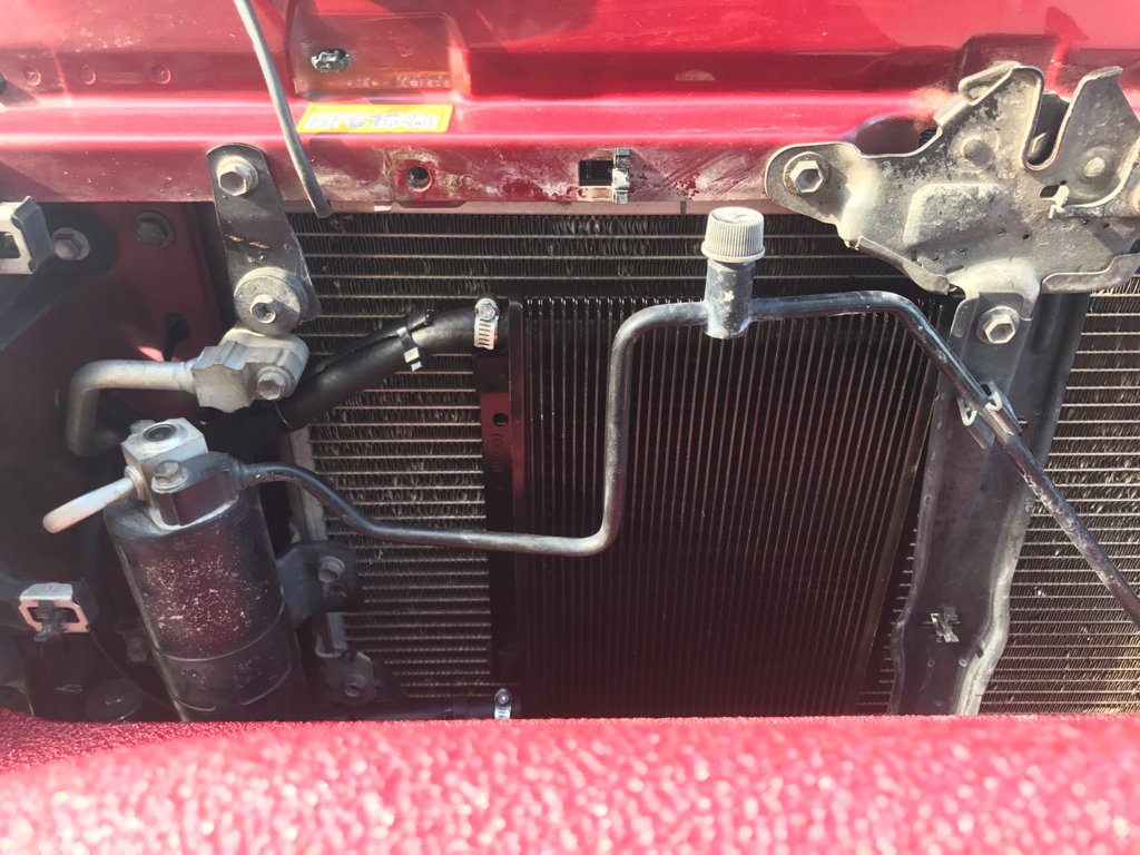

Well, finally got the radiator and transmission cooler on this Saturday. Didn't take too many pictures of the install but here's a few. I ordered all the parts from Camelback Toyota. This was my first time doing this and I couldn't of done it without the help of [MENTION=120071]mtbtim[/MENTION] and his very informative videos. Thanks Tim!
I ended up doing a lot more abrasive protection then pictured here.
Also put in a Magnefine filter before the B&M Cooler.
Everything seems to work fine, no leaks. Temperature is staying at around 210 on mountain roads. I couldn't be happier.

Why did you get the fuel filter replaced and have you noticed a difference?
Have you measured the distance from the center of the hub to the fender? I have the exact same setup as you in front, and i gained 4.5" That is too much. I do not have a heavy bumper on front, but my CV's are :crybaby:
Anyhow, i'd love to hear your overall lift in the front. Thanks!
Get a 7" electric fan hooked up to the external cooler. You'll be happier. Wheeling up steep grades in 4hi I never see anything over 190. The after market cooler is great but one with a fan is even better.
I'll definitely look into that. Is there any specific one you recommend?
I went with a cheap one from Amazon. Wired it to a relay then a rocker switch. It's a tight fit to get it in but I managed to clear the grill by about an 1/8". When you get the fan it will be set to pull not push. To change that to push, remove the fan, flip it 180, then reinstall. When you wire the fan wire it reversed. ie hot to ground and ground to hot. That will spin the motor backwards and give you true push, which is what you want.

Awesome! Thanks for the info. I'll be getting one pretty soon.

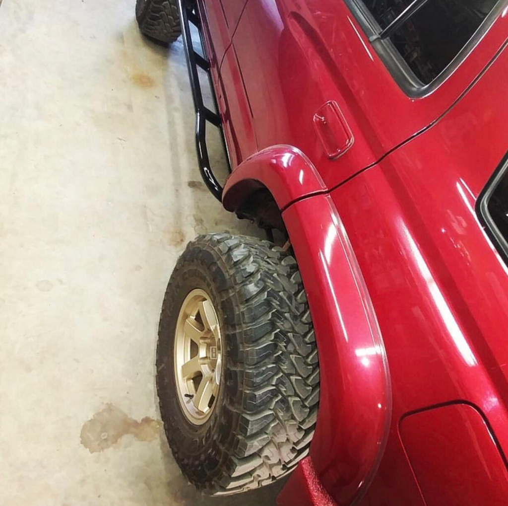

It's been 4 weeks since I installed the SPC UCAs and haven't had any issues. I did have to a little trimming on the inside of my flares to stop some running.

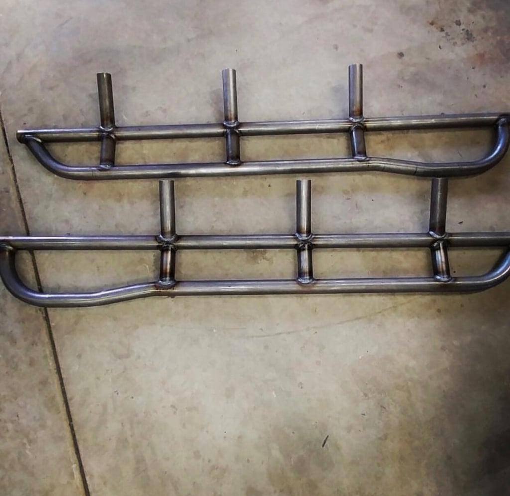

I also got some custom rock sliders installed. They turned out great!

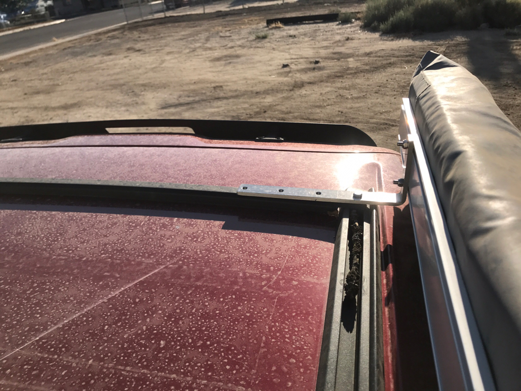

I also came across a good deal on a awning. I don't have a roof rack yet and was curious if there is a way to install them on the stock rails? I am thinking of using the existing bolts that hold the rails in place. Getting some longer bolts with a spacer? I'll have to wait until I receive it to see what I can I do.
But if anyone has any information, that would be awesome!
I've seen it done on the stock rails. Just make some L brackets and space them high enough they are level and bolt the awning on.

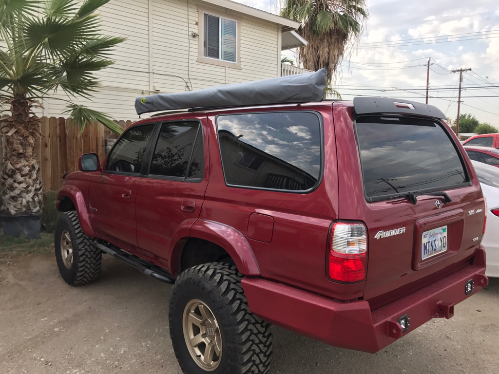

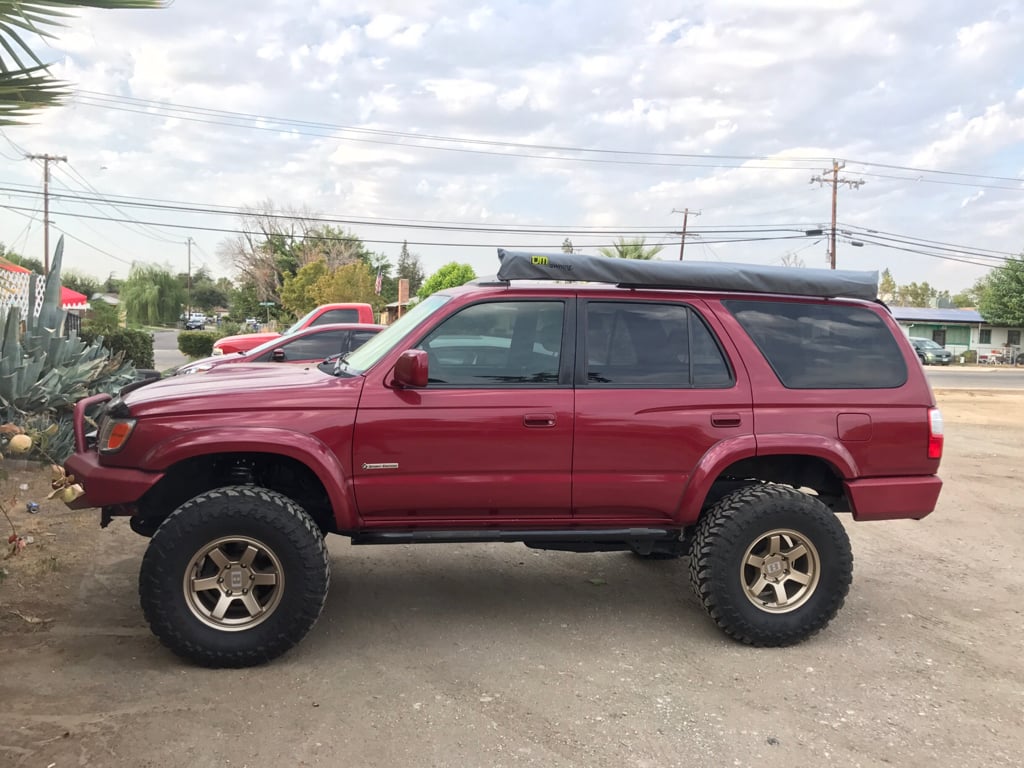

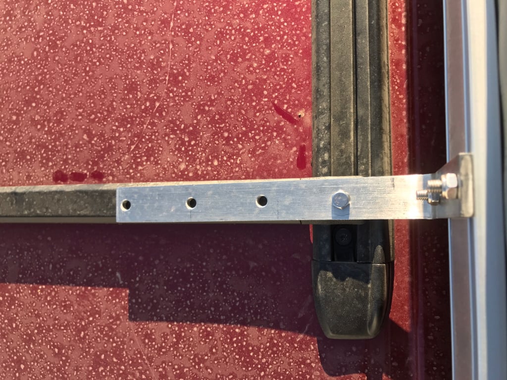

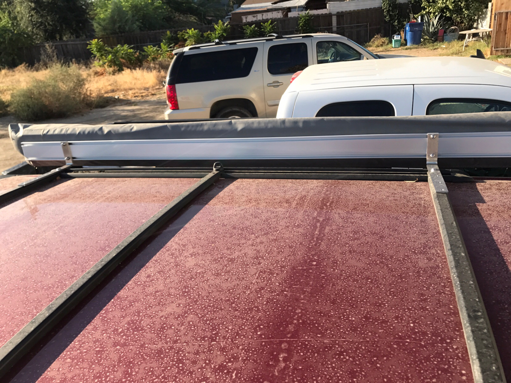

Well got my TJM awning installed a couple weeks ago. Haven't had the chance to update this but here's a few pictures.
Awning extended.
Awning extended with ARB Room with floor.

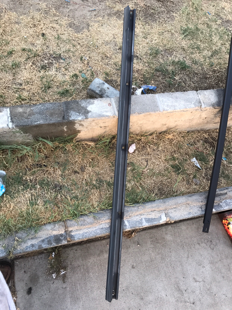

This is how I mounted it to my stock rails. All the hardware came with the awning. I ended up removing the thumb wheels on the crossbars and using that bolt up the supplied L brackets. The bolts that came with the awning were a perfect replacement for the thumb wheels. I didn't have to buy anything. The awning even came with a ratcheting end wrench! How awesome is that.
Man, I love this Runner!!
