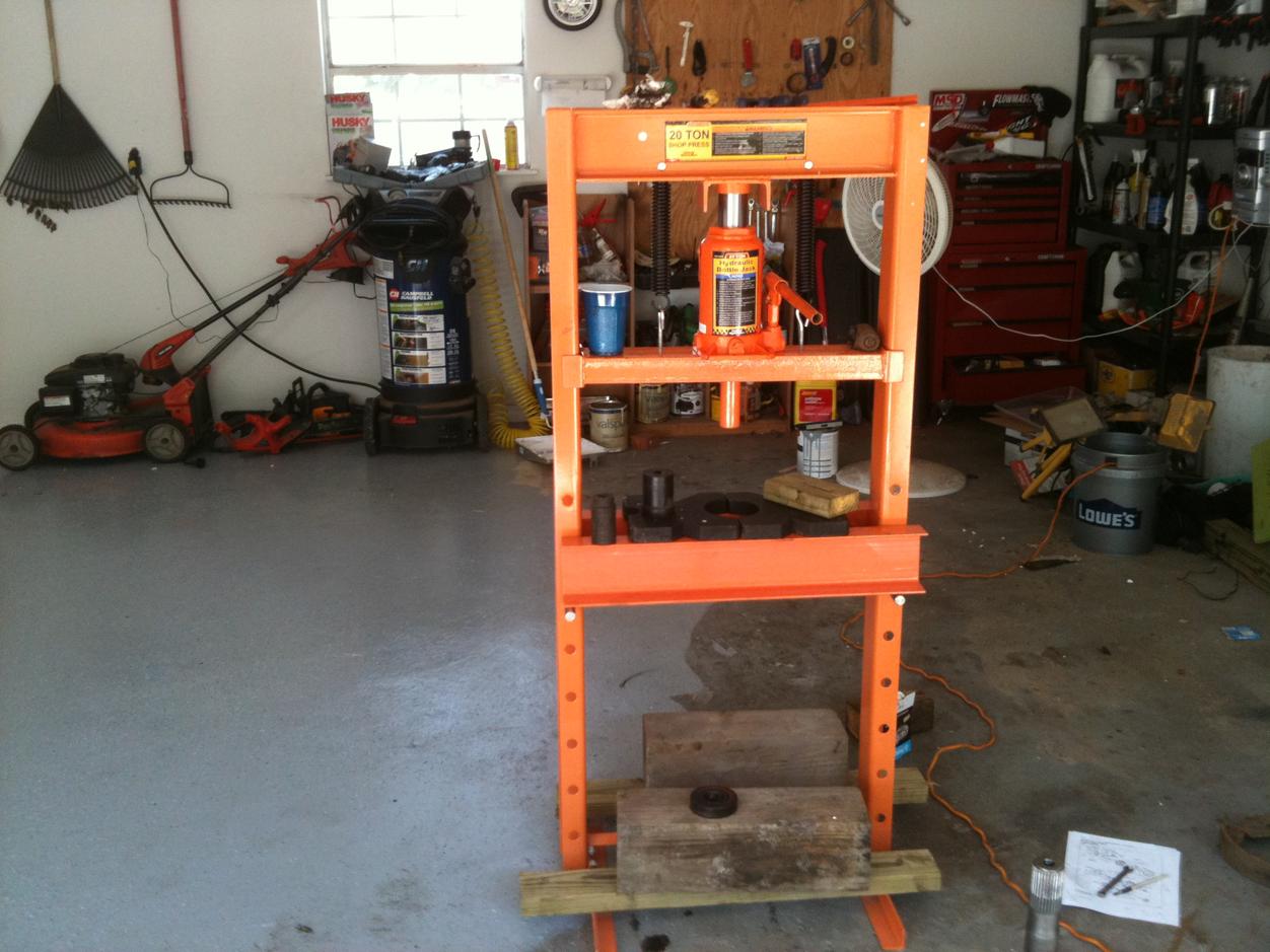

So I gave in to temptation, drove out to Pensacola Harbor Freight and dropped $200 on a 20ton press. Love it! Had the bearing out in about an hr. Most of that time was spent scrounging around looking for thick enough stock scraps to use.

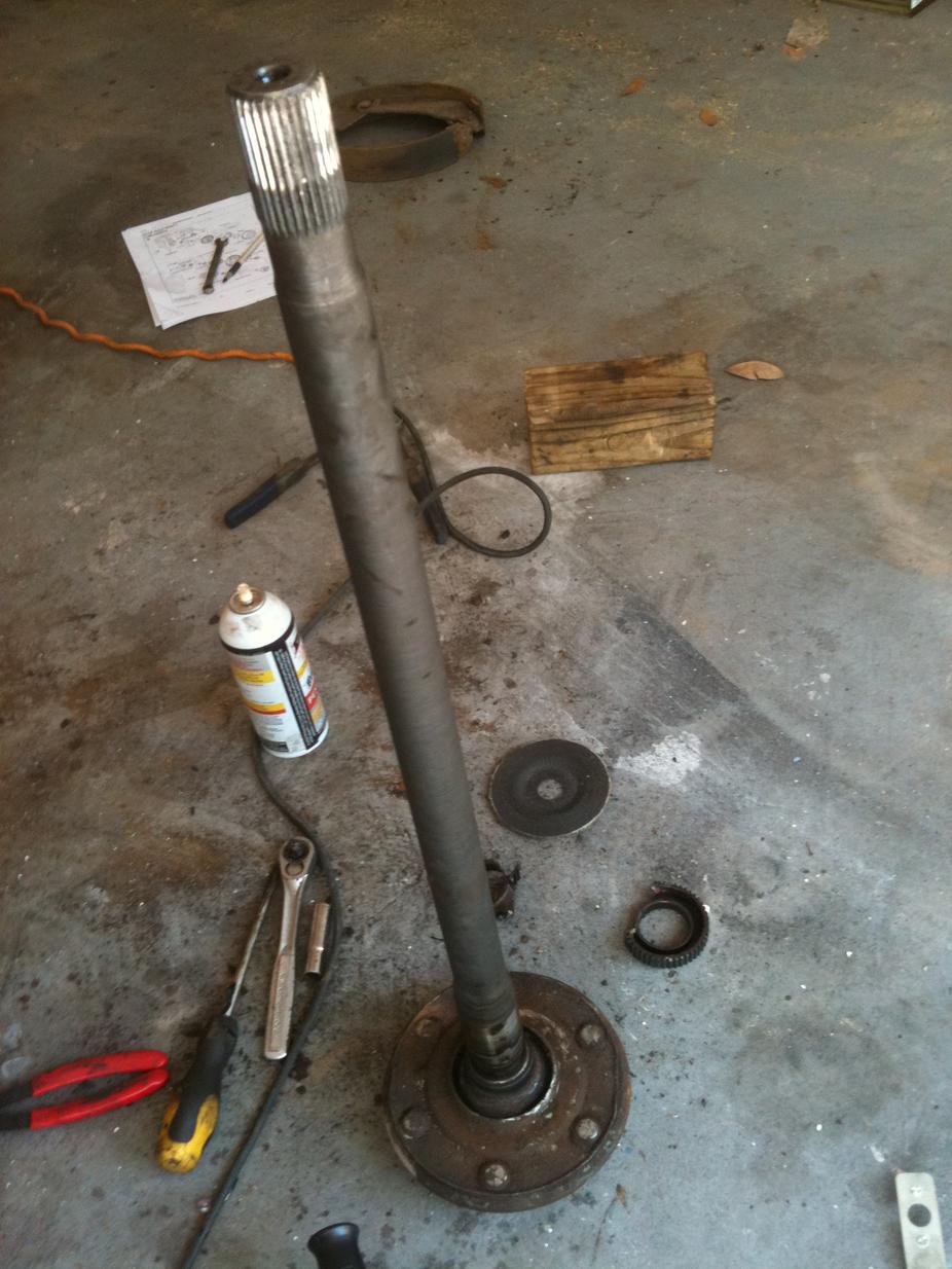

So after the axle was out, I chose to just grind the bearing retainers off as well as the ABS speed rotor (I hate this ABS and i killed it already). Then I pushed the axle out of the bearing and the bearing out of the bearing case.

The new sheriff in town:ak472: Sorry for the messy garage, I'm in the middle of coating the floor so all my ****'s piled on one side
Axle stripped down and ready to party

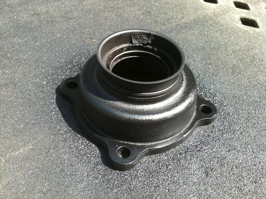

Nice painted bearing case

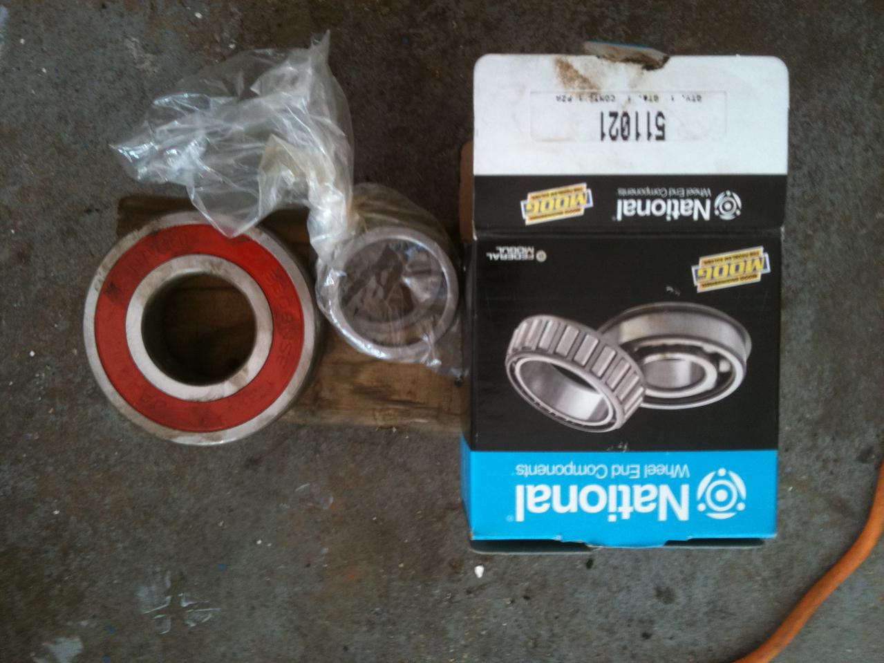

New bearing $65:jaw drop:

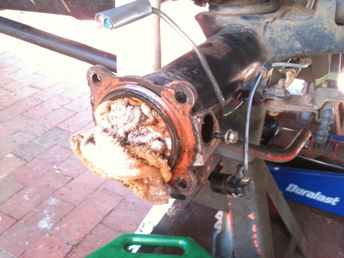

All back together and also tightened up the rear brakes and of course a good 4 corner bleed. Feels like a new truck! The ABS gear went right in the trash, I share your opinion of ABS=GARBAGE off road!
